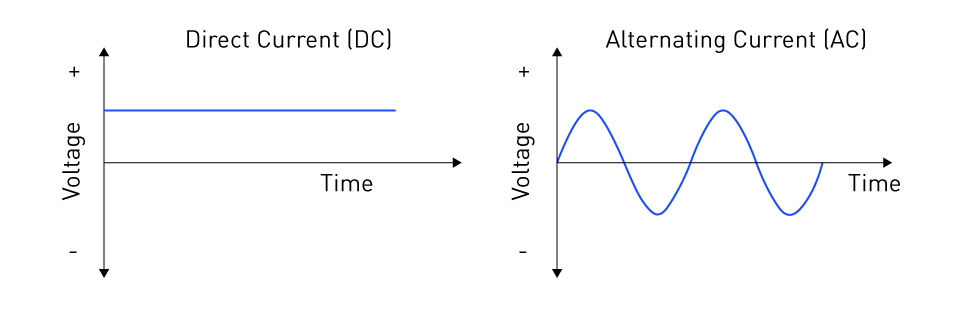

Technical Differences
The direction of the electron flow is the main technical distinction between AC and DC power. Electrons in DC systems only move in one direction, which maintains a steady voltage. Because of its constancy, DC is perfect for applications like electronic gadgets that need steady, dependable power. On the other hand, the direction of electron flow periodically changes in AC systems. Because of its alternating nature, power distribution is optimized and losses are minimized through the easy use of transformers to step up or step down voltage levels.
Figure 2: DC vs. AC power
AC Power: Its capacity to alter both direction and voltage level qualifies it for grid-based electrical energy delivery.
DC Power: keeps a steady voltage and it only flows in one direction, which makes it perfect for electronics, various motor types, and battery-operated devices.

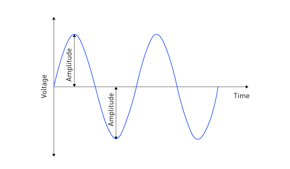

Amplitude
The amplitude of an alternating current waveform is defined as its peak value, which reflects the maximum strength of the electric field or the highest voltage or current in a cycle. Practically speaking, amplitude is equivalent to the "height" of the waveform in a graphic representation. Higher amplitudes indicate that more power can be applied to a load; this is directly correlated with the system's power capacity. In order to guarantee that every device receives the proper amount of power for its operation, engineers use amplitude control to regulate the power levels supplied to multiple devices.
Figure 3: Amplitude

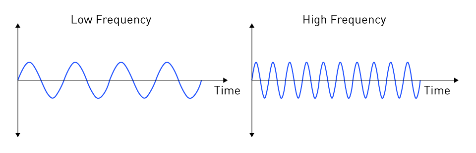

Frequency
The frequency, expressed in Hertz (Hz), tells us how many waveform cycles there are in a second. It is a vital property of AC power that has an impact on everything from the grid's stability to the way electric motors operate. In most of Europe, Asia, Africa, and Australia, the standard frequency is 50 Hz; in North America and some regions of South America, it is 60 Hz. These standard frequencies are frequently intended for device operation; variations may cause harm or ineffective operation. In electricity networks, frequency needs to be carefully controlled to provide grid synchronization, guaranteeing stability and facilitating effective distribution and transmission.
Figure 4: Frequency

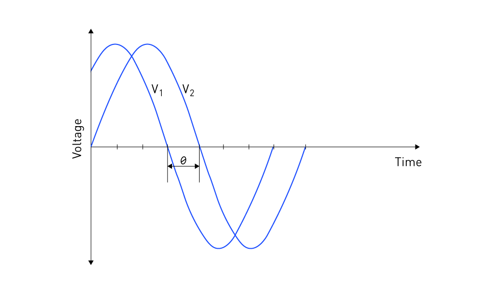

Phase
A waveform's phase indicates where it is in relation to other waveforms in time. For effective power transmission and motor functioning in AC power systems, particularly those that use polyphase (e.g., three-phase) systems, the phase difference between the individual waveforms is necessary. The waveforms in a three-phase system are normally 120 degrees out of phase with one another, which results in a more steady power flow and more smoothly and effectively operating electric motors. Designing and running AC power systems requires an understanding of and ability to govern phase relationships, especially in industrial settings where three-phase power is standard procedure.
Figure 5: Phase difference between voltages V1 and V2

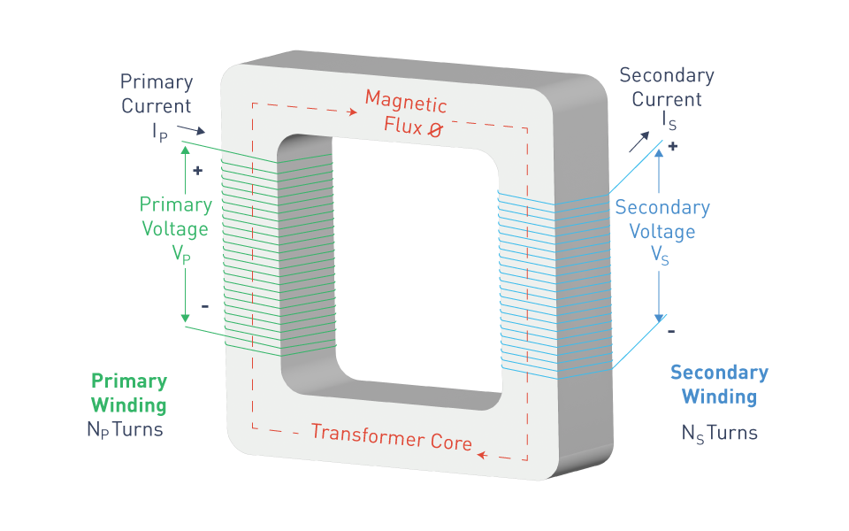

Transformer
A transformer is an electrical device that uses electromagnetic induction to transfer electrical energy between two or more circuits. Step-up and step-down voltage levels are also possible without affecting the overall electrical power. Transformers are necessary for regulating voltage levels because of this capability, which enables effective long-distance power transmission and subsequent distribution of usable power to residences and commercial buildings.
Figure 8: Transformer

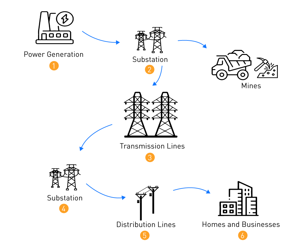

Grid
The grid, or electrical grid, is the interconnected network that transports electricity from producers to consumers. It consists of producing stations that generate electricity, high-voltage transmission lines that transport power from far sources to demand centers, and distribution lines that connect individual customers. The grid also comprises substations, transformers, and control systems that regulate the flow of power to ensure that supply matches demand. Modern grids are turning into smart grids, which use digital technologies to improve efficiency, dependability, and sustainability.
Figure 11: The electrical grid

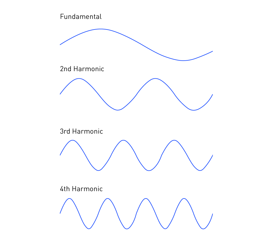

Harmonics
Harmonics in electrical systems are voltages or currents that run at a multiple of the fundamental frequency, causing distortion in the power waveform. They are caused by non-linear loads such as variable-speed drives, tiny fluorescent lights, and other electrical equipment. Harmonics can create a variety of issues, including equipment overheating, nuisance tripping of circuit breakers, and decreased efficiency. Managing harmonics entails utilizing filters, developing systems to restrict their production, and adhering to regulations that establish allowed levels.
Figure 12: Harmonics

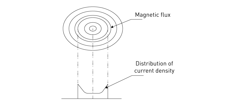

Skin Effect
The skin effect is a phenomenon in alternating current (AC) transmission in which the current density is higher at the conductor's surface and decreases as depth increases. This effect becomes more pronounced at higher frequencies, thus reducing the cross-sectional area accessible for current flow while raising the conductor's resistance. The skin effect is an essential factor in the design of high-frequency AC circuits and power transmission systems, impacting the conductor size and material selection to maximize efficiency.
Figure 14: Skin effect on a conductor
