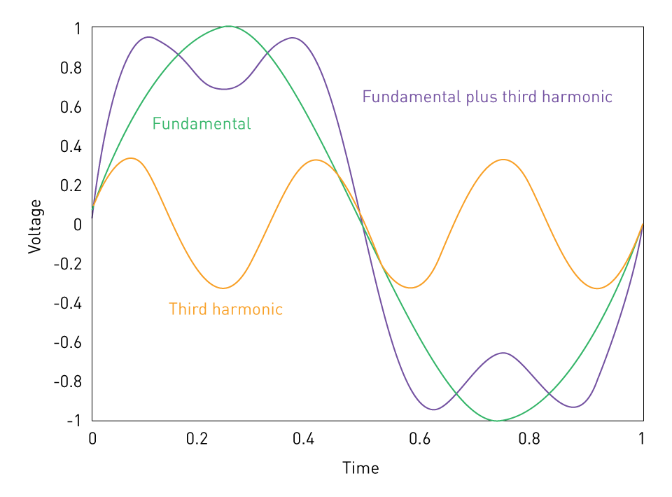

Types
Harmonics are classed according to their order, which is a multiple of the fundamental frequency. For example, if the fundamental frequency is 50 Hz, the second harmonic is 100 Hz, and the third harmonic is 150 Hz. Even-order harmonics (2nd, 4th, 6th, etc.) and odd-order harmonics (3rd, 5th, 7th, etc.) have distinct impacts on power systems. Odd-order harmonics, notably the third and its multiples, are especially problematic in three-phase systems because they tend to concentrate in the neutral conductor, which may lead to overheating.
Figure 22: Fundamental plus 3rd harmonic
