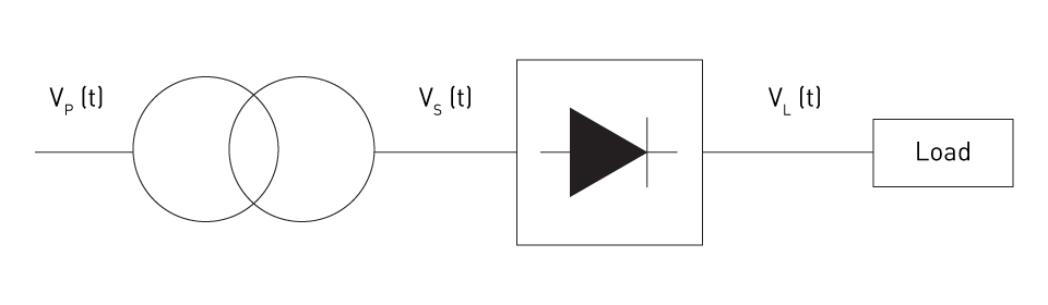

Figure 1: Generic scheme of a rectifier
The figure above depicts the generic scheme of a rectifier, which includes:
  • vp (t) – transformer time-dependent primary voltage
  • vs (t) – transformer time-dependent secondary voltage
  • vL (t) – a time-dependent voltage at the output of the rectifier (on the load)
  • The DC voltage on the load is the average of the rectifier's output voltage over the period T.
    $$V_{DC} = \frac{1}{T} \int_0^T v_L(t) \, dt$$
