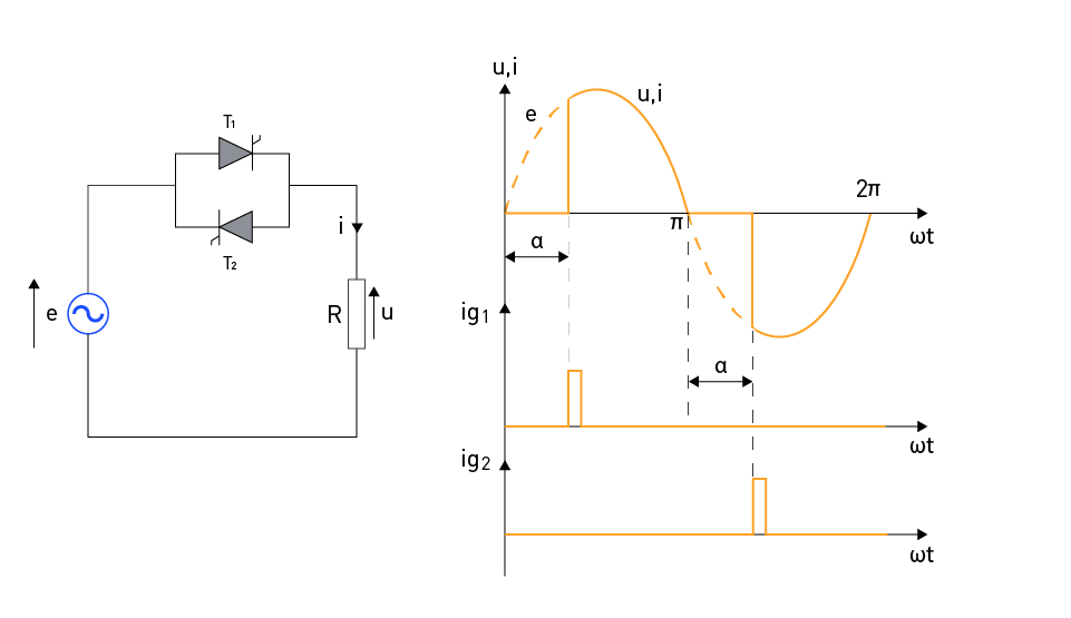

A single-phase AC voltage controller that contains thyristors is coupled in an antiparallel manner, as shown in Figure 1 (left). This particular configuration is frequently utilized due to the fact that it requires a smaller number of switching elements, which ultimately leads to the lowest possible losses. It is necessary to obtain galvanic isolation of the control circuit in this design because the thyristor cathodes have a variety of potentials. The fact that the load is only intermittently linked to the input voltage throughout the course of a half-cycle is the starting point for the concept that underpins the idea of managing the output RMS voltage. The length of time that this section of the half-cycle continues to exist is determined by the instant that the thyristor is activated (by means of the application of a firing pulse).
This particular instant is defined by the firing angle α, which is the duration of time that elapses between the point at which the thyristor begins to become forward-biased and the point at which it receives a firing pulse.
There is a depiction of the waveforms for the input voltage, the firing pulse, and the output voltage (or current) in Figure 1 (right). Thyristor T1 experiences a forward bias during the positive half-cycle of the input voltage. The thyristor T1 becomes reverse-biased when the load current is reduced to zero and the input voltage is shown to be shifting in the opposite direction. During the time ωt = α, the ig1 pulse is responsible for activating this thyristor, which then continues to conduct until the end of the half-cycle. For the duration of the subsequent half-cycle, thyristor T1 will be in reverse bias. This is a significant amount of time longer than the amount of time that is required for it to turn off. When the thyristor T1 is conducting, the voltage that is measured across the load is the same as the voltage that is being input. During the negative half-cycle of the input voltage, events that are comparable to those described above take place, with the exception that thyristor T2 conducts since it is thus negatively biased.
Figure 1: Single-phase full wave AC voltage controller with resistive (R) load
By adjusting the firing angle of the thyristor, which can range from α = π to α = 0, it is possible to vary the RMS value of the output (load) voltage from zero to the RMS value of the input voltage. The RMS value of the output voltage for the firing angle is as follows:
$$U = \sqrt{\frac{1}{\pi} \int_{\alpha}^{\pi} \left( \sqrt{2} E \sin(\omega t) \right)^2 \, d(\omega t)}$$By altering the equation ωt = x:
$$U = E \cdot \sqrt{\frac{2}{\pi} \int_{\alpha}^{\pi} \frac{1 - \cos(2x)}{2} \, dx}$$ $$⇔U = E \cdot \sqrt{\frac{2}{\pi} \left( \frac{\pi - \alpha}{2} - \frac{1}{4} \left( \sin(2\pi) - \sin(2\alpha) \right) \right)}$$ $$⇔U = E \cdot \sqrt{1 - \frac{\alpha}{\pi} + \frac{\sin(2\alpha)}{2\pi}}$$in which [Equation] represents the root-mean-square value of the input voltage and U represents the value of the output voltage at its RMS.

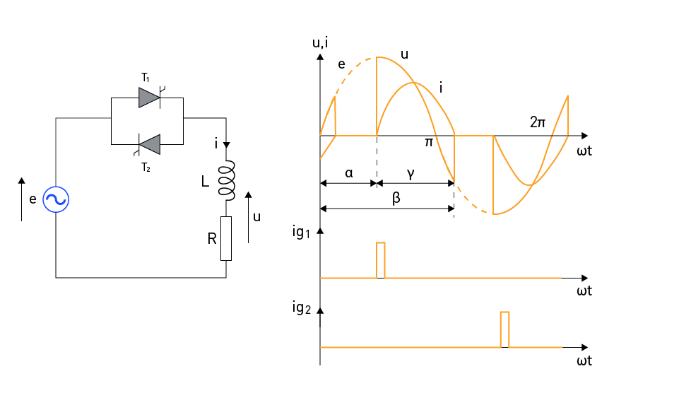

Figure 2 (left) illustrates a single-phase AC voltage controller with a load that is represented by an inductor with an inductance of L linked in series with a resistor with a resistance of R. Figure 2 (right) displays the waveforms of the input voltage, output voltage, and current, along with the trigger pulses used to activate the thyristor at the firing angle. These waveforms are depicted in the figure.
Figure 2: Single-phase AC voltage controller with LR load
As soon as the trigger pulse is applied to thyristor T1 at the time ωt = α, T1 begins to conduct, and the load voltage is the same as the input voltage. Thyristor T2 becomes reverse-biased as a result of the voltage drop that occurs in thyristor T1 while it is conducting conductivity. This occurs when thyristor T1 stops conducting. When thyristor T1 stops conducting at moment at ωt = β, the thyristor T2 becomes forward-biased by input voltage, which at that moment has a value of:
It is required to install sufficient RC protection in parallel with the thyristors, as the sudden surge in the forward-biasing voltage triggers the thyristor without the user's consent.
The thyristors' conduction angle can be defined using the following expression:
$$\gamma = \beta - \alpha$$When conducting the thyristor, two distinct time intervals occur. The first interval, which spans from ωt = α to ωt = π, is characterized by the fact that the input (grid) voltage and the output (load) current are in the same direction. This indicates that energy is extracted from the grid and transported to the load. The resistive portion of the load, on the other hand, is responsible for the consumption of a portion of that energy, while the remaining portion is stored in the inductor as magnetic energy.
During the second interval, which spans from ωt = π to ωt = β, the grid voltage and the load current exhibit divergent directions. This indicates that the magnetic energy generated by the inductor is partially returned to the grid and partially consumed by the resistive portion of the load. After the inductor has used up all of its magnetic energy, the current will drop to zero, and the thyristor will no longer conduct electricity. The firing angle of the thyristor decreases, resulting in an increase in the amount of energy stored in the inductor. Additionally, the amount of time required to burn that energy grows, resulting in an increase in the angle β. If the angle β is equal to π + α, then the conduction angle of the thyristor is equal to π. This signifies the absence of any interruptions in the load current, making it equivalent to a direct connection to the grid voltage.

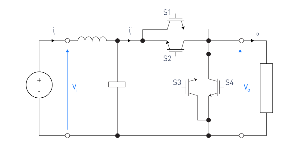

Single-phase AC choppers, a type of AC/AC converter, use power electronic switches to modify the output voltage waveform without altering the input frequency. To split the input waveform into smaller pieces, these converters use fast-switching parts like MOSFETs or IGBTs. This enables precise control over the output voltage.
Figure 3: Single-phase PWM AC chopper circuit with input filter
