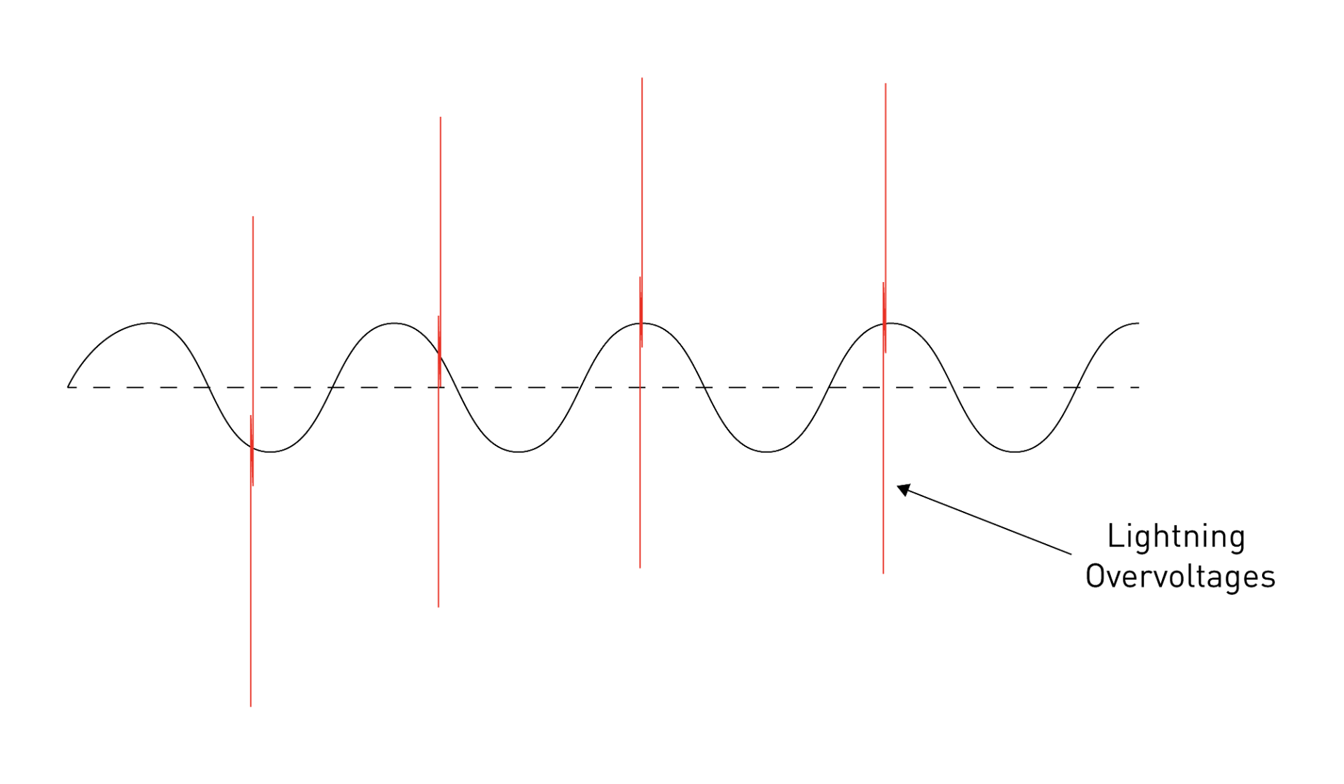

One of the most dramatic and damaging external sources that disrupt AC lines is lightning strikes. Lightning affects electrical infrastructure, including transformers, power lines, and substations, and can briefly cause very high voltages.
Figure 7: Lightning overvoltages
Impact: Lightning strikes can cause electrical fires, damaged components, and burnt cables as their direct effects. Furthermore, a lightning strike's surge can travel along power lines and produce voltage spikes that can harm electrical equipment and stop service across a large region.
Protection Measures: Power systems contain surge protectors, lightning arresters, and grounding devices to help lessen the effects of lightning strikes. These devices are intended to safely channel surplus energy to the ground, away from crucial components of the power system.

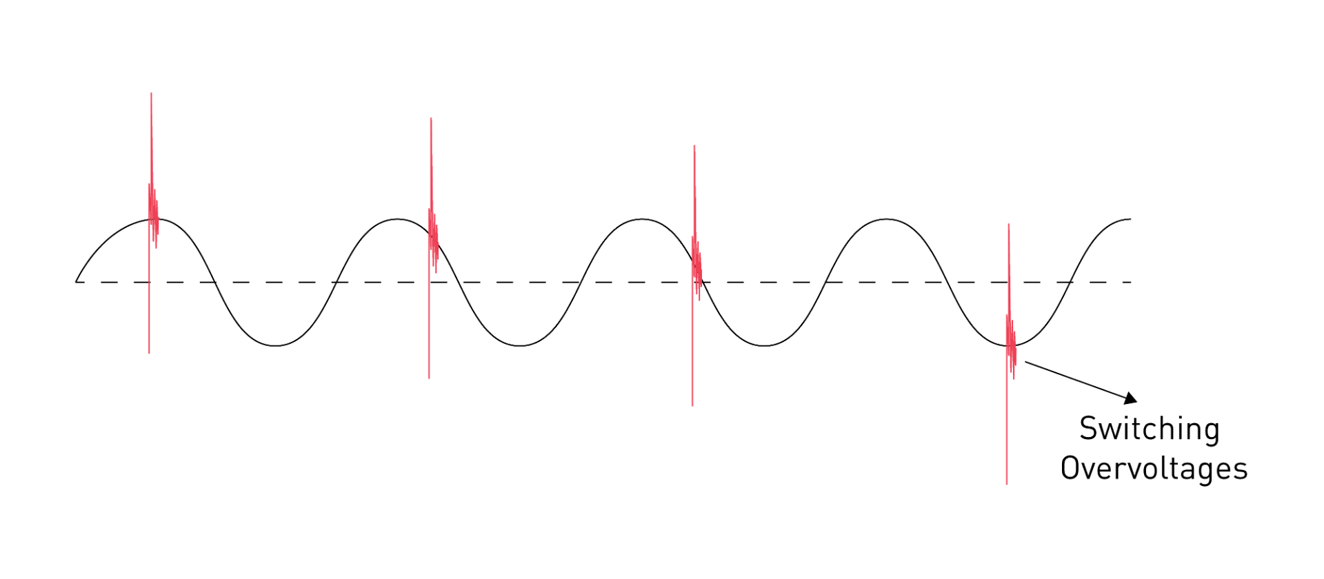

In electrical systems, switching operations refer to connecting or disconnecting circuits or pieces of equipment from the power source. The abrupt shift in load conditions might cause problems in this process.
Mechanism: Transient voltages and currents are produced when electrical equipment is turned on or off. These transients can travel across the electrical supply and impact other connected devices. The degree of the disturbance is typically determined by the type of the load and the system's capacity.
Figure 8: Switching overvoltages
Impact: Switching between pieces of equipment can result in surges and sags, which can trip sensitive equipment or cause lights to flicker. Revering big motors or capacitors can greatly impact power quality in industrial environments.
Mitigation Strategies: One way to lessen the impact of equipment switching is to install surge protectors, use soft starters for large equipment, and time the operation of heavy gear carefully. Disturbances can also be isolated by reworking the power system to incorporate circuits specifically designed for heavy loads.

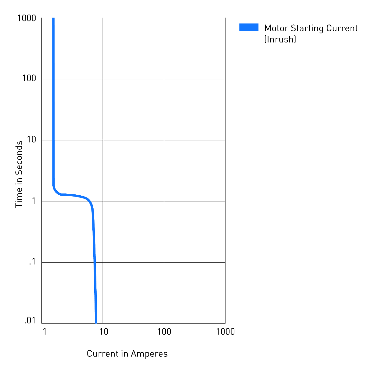

Starting huge motors is a major cause of internal disturbances in power systems, especially in industrial applications with high inductive loads.
Mechanism: When an induction motor is started from a standstill, it draws a large inrush current, which is often twenty times (or more) the average operating current. This enormous initial current might result in a considerable voltage drop across the system, affecting other devices connected to the same power source.
Figure 9: Motor inrush current
Impact: The voltage drop brought on by a motor starting might result in undervoltage conditions, which can interfere with operating procedures or damage or malfunction delicate equipment. Frequent disruptions can also cause equipment to age more quickly and require more maintenance.
Mitigation Strategies: Reduced voltage starts, such as star-delta starters, variable frequency drives (VFDs), or soft starters, can assist regulate inrush current and lessen the load on the power system. Furthermore, enhancing system architecture to boost resilience and capacity can assist absorb the additional demand without causing substantial disruptions.
