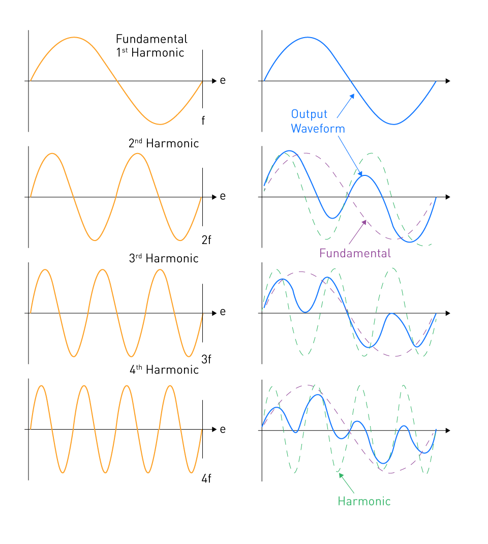

Harmonics are sinusoidal parts of a waveform that have frequencies that are integer multiples of the fundamental frequency. In AC/AC converters, these are formed by the nonlinear features of the power electronic components, such as diodes, thyristors, and transistors, which cause a sudden change in the waveform of the current. Due to the fact that the presence of harmonics can have a variety of detrimental impacts on the power supply, it is essential to have a solid understanding of the sources and consequences of harmonics.
Figure 11: Individual harmonic components (left) and composite waveforms (right)

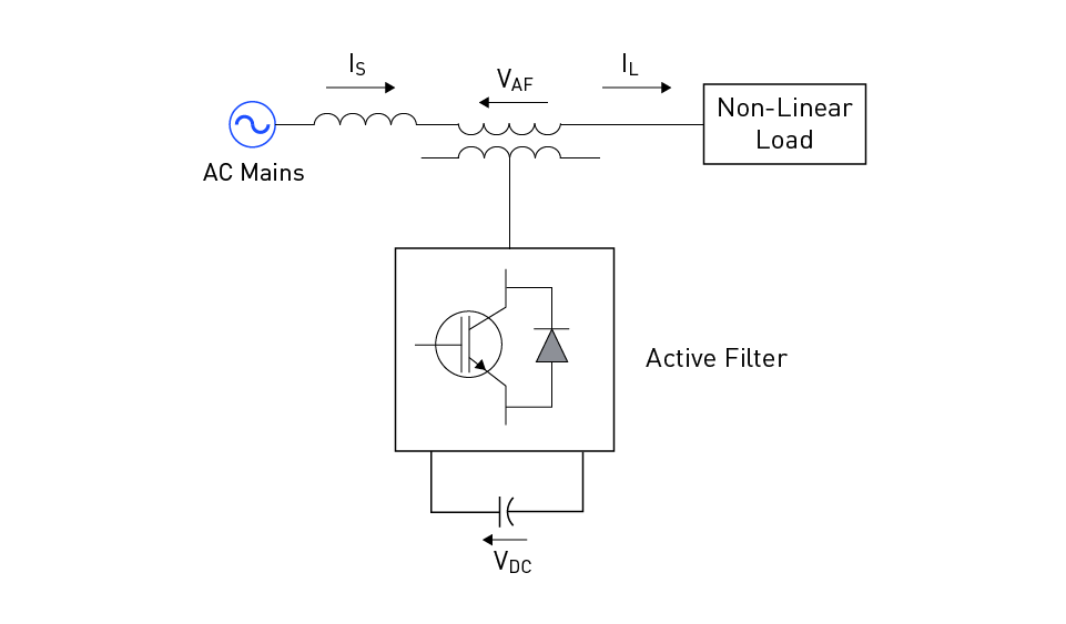

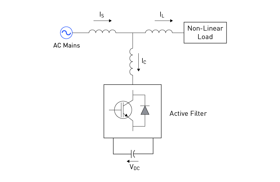

Active filters: Active filters are a type of power electrical equipment that generates harmonic currents that are in the opposite phase to those generated by the load, but these harmonic currents have a similar magnitude. These opposing currents essentially cancel out the harmonic currents, which results in a reduction in the impact that the harmonic currents have on the power system. Shunt active filters and series active filters are two distinct types of filters that connect to the load in parallel and series, respectively. Shunt active filters are more common than series active filters.
