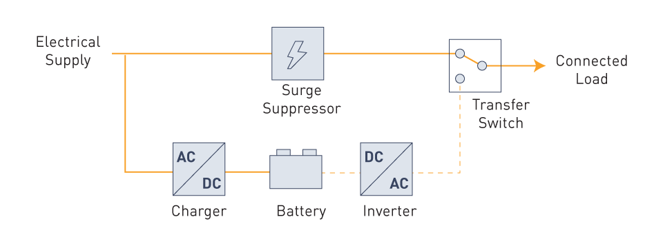

Offline UPS:
- Description: In the event of a power outage, this type of UPS, also known as a standby UPS, provides basic power protection by simply switching to battery power.
- Functionality: When operating normally, the UPS sends electricity directly to the attached devices, bypassing its circuitry. When it detects a power outage, it only then activates its inverter to draw power from the battery. Offline UPS transfer times typically range from 5 to 12 ms, with 8 ms being the average.
- Applications: This product is ideal for less demanding settings or for home use, particularly when money is tight and the load can handle short periods of switching to battery power.
Figure 3: Standby UPS

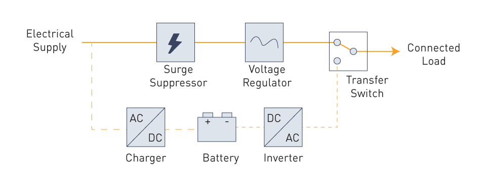

Line-interactive UPS:
- Description: This system uses technology that keeps it from switching to battery power to correct minor power fluctuations (under-voltages and over-voltages), saving battery life for when it's most needed.
- Functionality: It protects against power surges and sags by adjusting voltage variations to acceptable levels, thanks to its automatic voltage regulation (AVR) feature. A line-interactive UPS usually has a transfer time of 2–8 ms.
- Applications: This product is ideal for use in settings where power fluctuations are a major issue, such as servers, networking equipment, and small to medium-sized businesses.
Figure 4: Line-interactive UPS

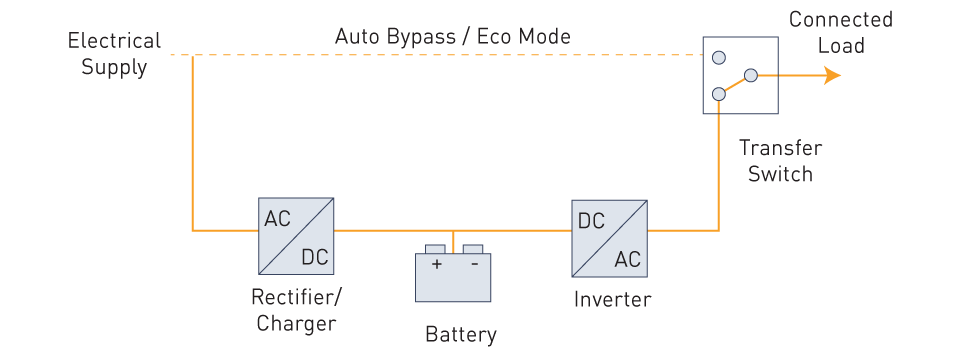

Online Double-Conversion UPS:
- Description: In order to charge its battery, this kind of UPS continuously converts incoming AC power to DC. The UPS then switches back to AC power to power the connected devices. This sort of UPS offers the maximum level of safety.
- Functionality: This system provides a clean and reliable power output, free from power disturbances like outages, voltage fluctuations, and harmonic distortions, because it completely regenerates the power through a double-conversion process. The system always powers the load from the battery, eliminating any transfer time, even when the main power source is accessible.
- Applications: When power quality is paramount, such as in data centers, hospitals, and telecommunication facilities, this product is perfect for protecting delicate equipment.
Figure 5: Online UPS

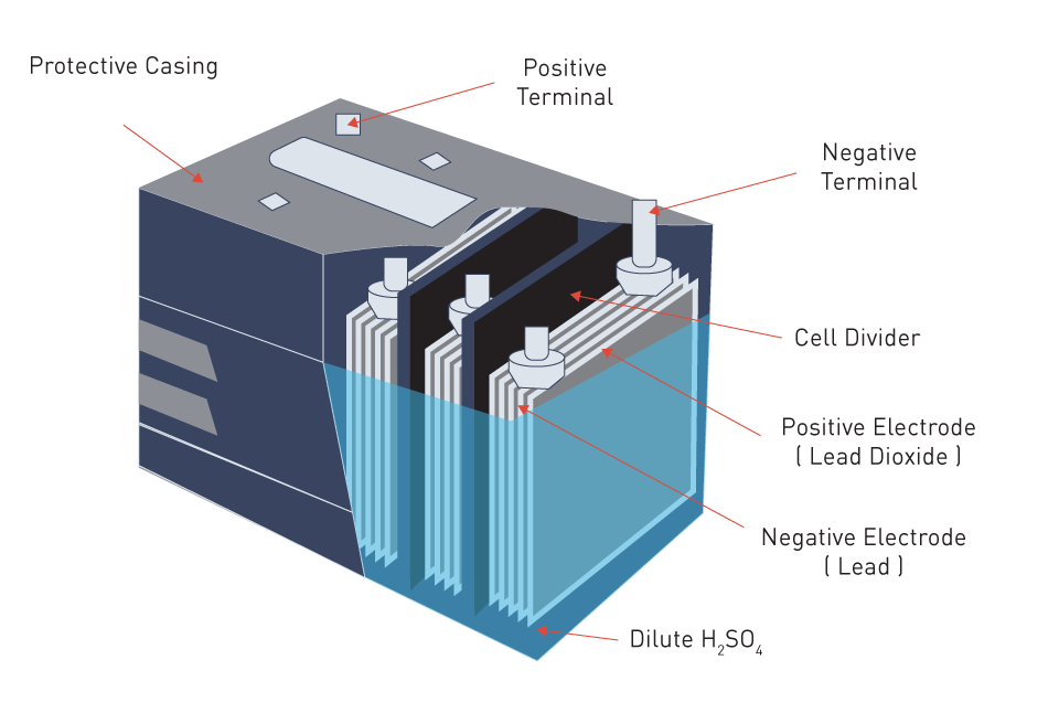

Lead-Acid Batteries:
Figure 6: Lead-acid battery
- Description: Lead-acid batteries, which are among the first varieties of rechargeable batteries, are renowned for being durable and affordable. They are composed of a sulfuric acid electrolyte and lead plates.
- Applications: Lead-acid batteries are frequently utilized in automobile starters, emergency lighting systems, and large-scale power backup systems where weight is not an issue because of their high power-to-weight ratio and capacity to deliver enormous surges of power.

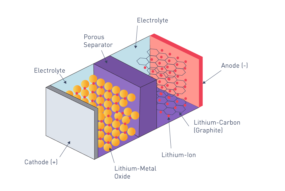

Lithium-Ion Batteries:
Figure 7: Lithium-ion battery
- Description: Compared to lead-acid batteries, lithium-ion batteries have a longer life cycle, better efficiency, and a higher energy density. They use lithium compounds as electrode materials.
- Applications: Their small size, high efficiency, and portability make them ideal for electric vehicles, portable devices, and, increasingly, home energy storage systems and data center backups.

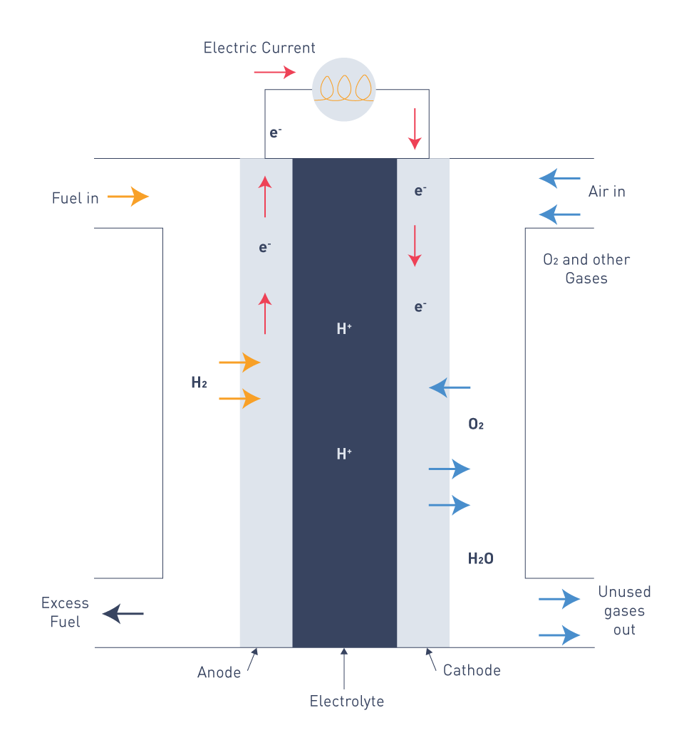

A fuel cell is an electrochemical device that uses two redox processes to transform the chemical energy of a fuel (often hydrogen) and an oxidizing agent (often oxygen) into electrical energy. In contrast to conventional combustion-based power plants, fuel cells use an electrochemical mechanism to produce electricity and heat as byproducts.
The following procedures are involved in a fuel cell's basic operation:
Fuel Input: The anode side of the fuel cell receives hydrogen.
Electrochemical Reaction at the Anode: A catalyst at the anode splits hydrogen molecules into protons and electrons.
$$ H_2 \rightarrow 2H^+ + 2e^- $$Proton Exchange: Protons travel from the cathode side across an electrolyte membrane.
Electron Flow: The movement of electrons across an external circuit produces an electric current.
Electrochemical Reaction at the Cathode: The electrochemical reaction of oxygen molecules with protons and electrons creates water at the cathode.
$$ \frac{1}{2} O_2 + 2H^+ + 2e^- \rightarrow H_2O $$If hydrogen and oxygen are available, this electrochemical reaction will always generate power.
Figure 8: Proton-conducting fuel cell
