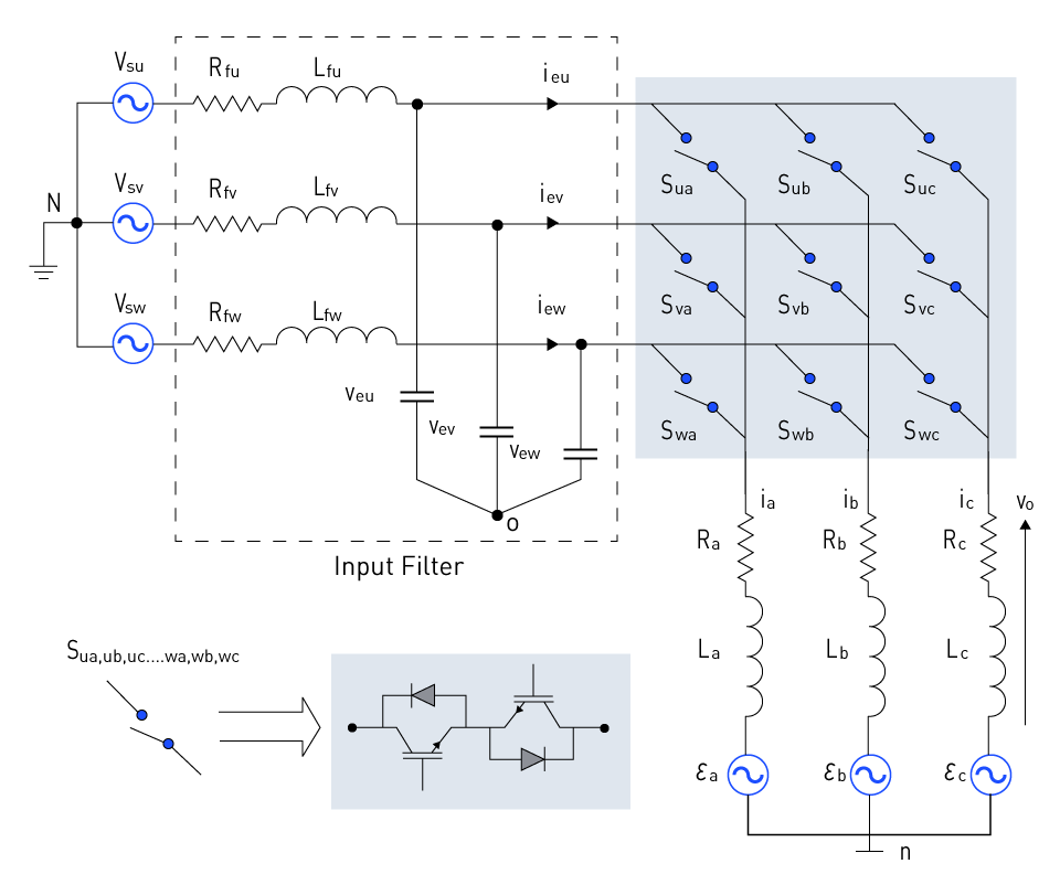

Fundamentals of Matrix Converters
A matrix of bi-directional power switches connects the input and output phases of a matrix converter. A three-phase to three-phase matrix converter includes nine bi-directional switches (Figure 15). These switches are often constructed from two back-to-back connected semiconductor devices, such as MOSFETs or IGBTs, with anti-parallel diodes.
Figure 15: Matrix converter topology
Operation of Matrix Converters
The matrix converter selectively closes and opens the bi-directional switches to transfer power from the input phases to the output phases. The converter can produce an output voltage waveform with the required amplitude, frequency, and phase shift by manipulating the duty cycle and timing of the switches. A high power factor is caused by the switching operation's effect on the input current waveform, which keeps it sinusoidal and in phase with the input voltage.
