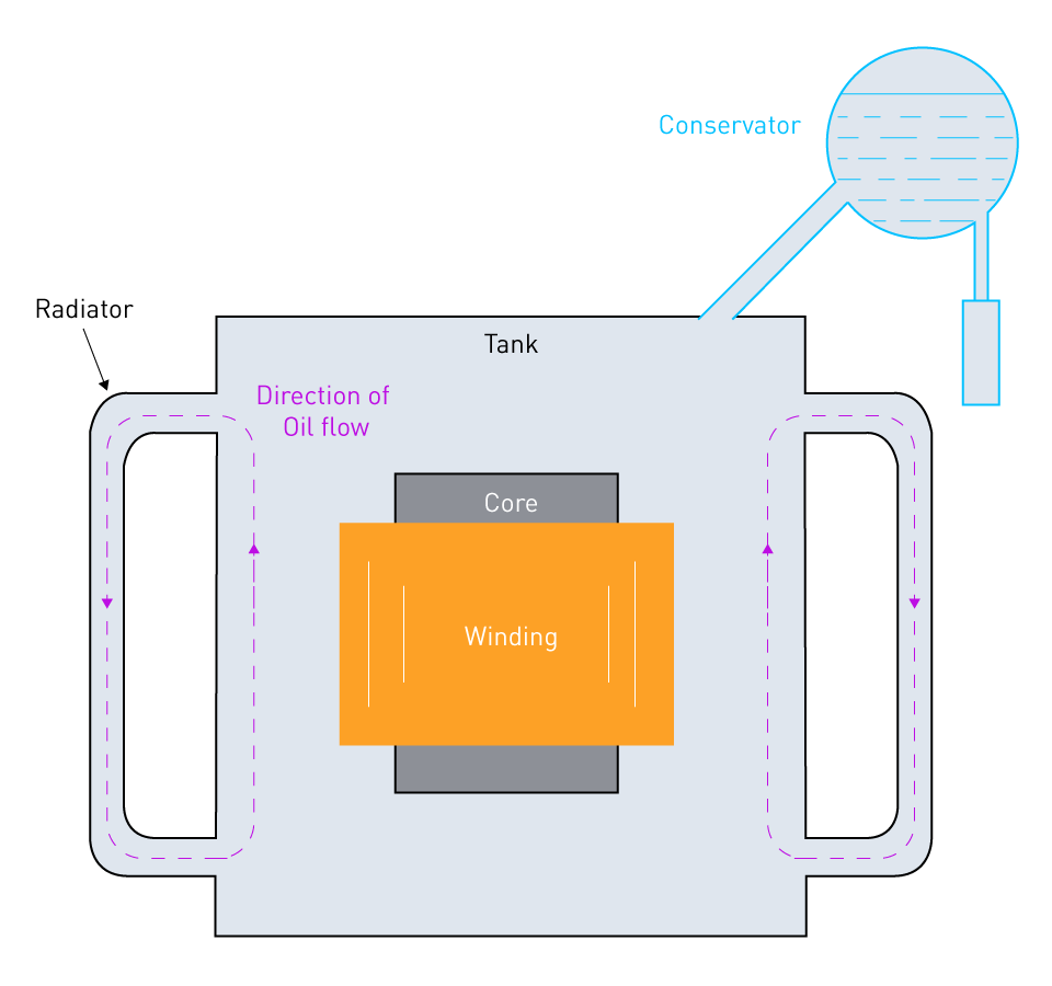

Oil Natural Air Natural (ONAN): The transmission of heat takes place in naturally cooled oil-immersed transformers (Oil Natural Air Natural) through the processes of natural convection and radiation. The oil absorbs the heat, which then circulates naturally within the transformer, transferring it to the tank walls and ultimately to the surrounding air. It is common practice to employ this technique in transformers of a smaller size, where the amount of heat generated is quite minimal.
Figure 14: Oil Natural Air Natural (ONAN) transformer cooling

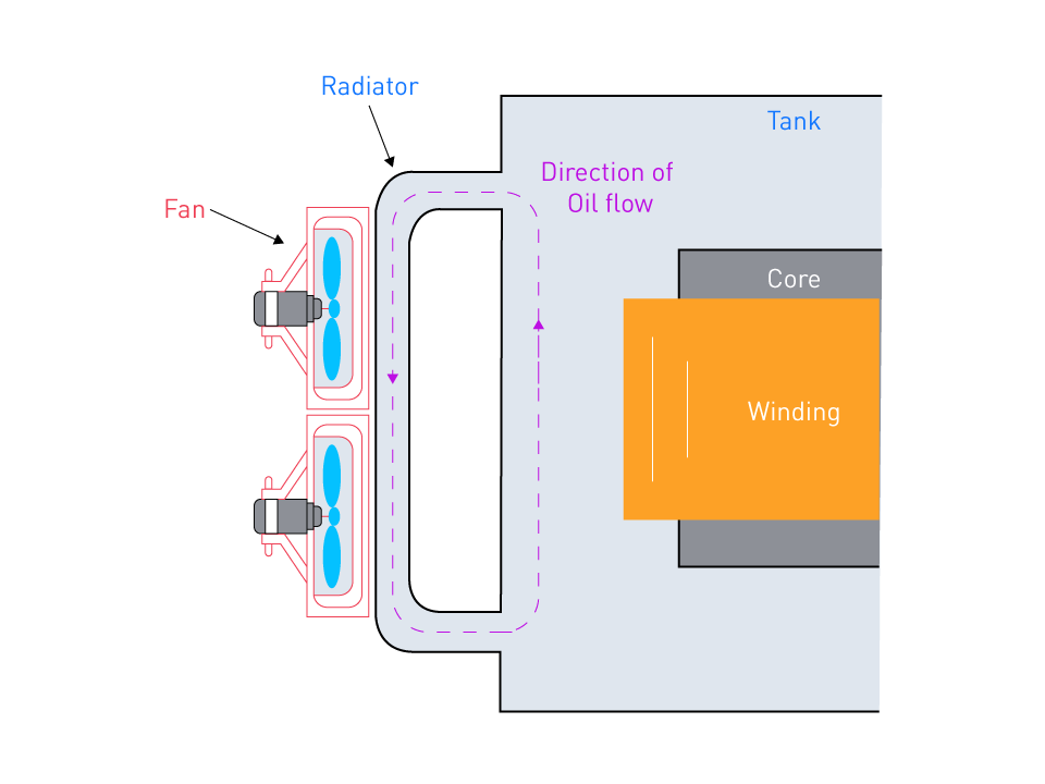

Oil Natural Air Forced (ONAF): Forced air cooling systems are utilized for larger transformers when the heat generated is too much for natural cooling techniques to keep the transformer at a safe temperature. This type of cooling system is referred to as oil natural air forced (ONAF). Fans are used to supplement the air cooling that occurs during the transformer's operation, which is powered by natural oil circulation. The ONAF system triggers the fans when the transformer's load increases and the generated heat exceeds the natural air circulation's cooling capacity. It is possible for the ONAF system to offer effective cooling, which guarantees that the transformer will function within the acceptable temperature range.
Figure 15: Oil Natural Air Forced (ONAF) transformer cooling

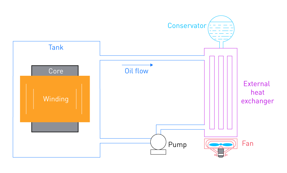

Oil Forced Air Forced (OFAF): The term "Oil Forced Air Forced" (OFAF) refers to the use of oil pumps to actively circulate the insulating oil within the transformer. Natural oil circulation involves pumping the oil through the transformer and the cooling radiators or heat exchangers. This is in contrast to the natural oil circulation, which is dependent on the temperature gradient. A more uniform temperature distribution and a more effective transmission of heat from the transformer core and windings to the oil are both achieved through the utilization of this forced circulation device. Fans blow air over the radiators or cooling fins to improve the rate of heat transfer from the oil to the surrounding environment. When compared to the use of natural air convection, the use of forced air cooling results in a significant improvement in heat removal rate. The transformer is able to manage higher loads and work under more demanding conditions without overheating thanks to this approach, which provides a cooling solution that is very efficient.
Figure 16: Oil Forced Air Forced (OFAF) transformer cooling

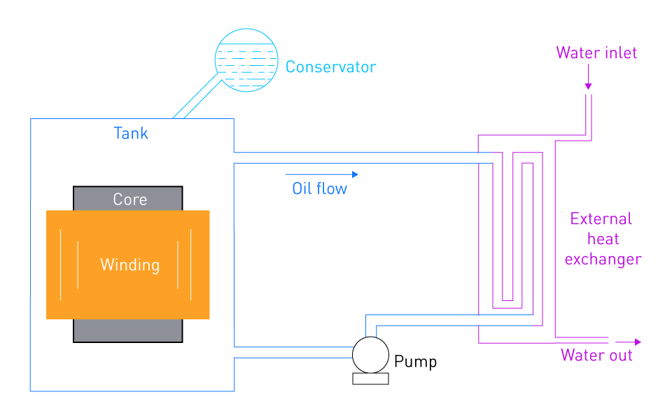

Oil Forced Water Forced (OFWF): In exceptionally high-power applications, oil-immersed transformers may use a mix of forced oil circulation and water-cooled heat exchangers. This type of transformer is referred to as oil-forced water-forced (OFWF). In order to properly remove heat from the system, the oil is circulated between the transformer and a radiator. Additionally, the oil absorbs heat through water channels. This strategy is not only highly effective but also more complex, often reserved for specific situations with high demand.
Figure 17: Oil Forced Water Forced (OFWF) transformer cooling
