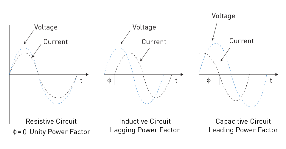

Displacement: When the voltage and current waves in a circuit are out of phase with one another, a phenomenon known as displacement takes place. This is typically caused by the presence of reactive components in the circuit, such as inductors or capacitors.
By acting on power systems, reactive loads cause the current to move in a direction that is not in phase with the voltage. The power factor can be considered the cosine of the angle that is formed as a result of the current and the voltage.
A power line that supplies an inductive load has a power factor that is lagging, whereas a power line that supplies supplies to a capacitive load has a power factor that is leading.
Figure 1: Effect of load on power factor
Inductive loads, such as motors, transformers, and inductors found in electronic equipment, consume reactive power in addition to receiving active power. Even though reactive power does not perform any practical work, it is essential for the generation of magnetic fields, which are what make it possible for these devices to function. Because of the consumption of reactive power, there is a phase shift between the waveforms of the voltage and the current, which ultimately results in a power factor that is less than one.
A feature known as capacitive reactance is shown by capacitors. This property refers to the resistance that the capacitor provides to the flow of alternating current. In AC circuits, the presence of capacitive loads causes a phase shift to occur between the voltage and the current. While the capacitor is being charged during the positive half-cycle, it is being discharged during the negative half-cycle for the capacitor. The process of charging and discharging the capacitor causes a phase difference between the voltage that is across the capacitor and the current that is flowing through it.
