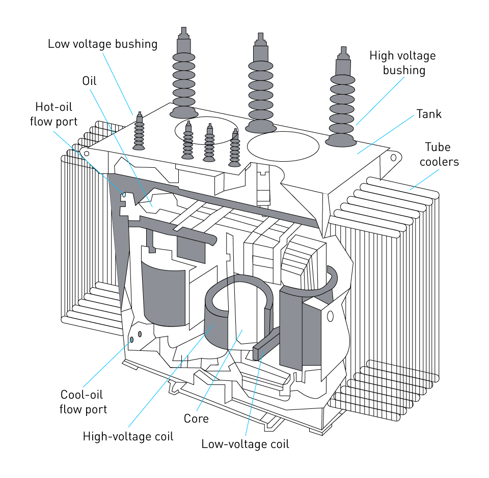

Transformer Construction and Components
Transformers are complex devices that use electromagnetic induction principles to transfer energy between circuits at different voltage levels. Transformers are used to transmit energy. The structure of these devices is crucial to their utility, as it not only dictates their efficiency and effectiveness, but also the variety of applications they can serve. This section provides an in-depth analysis of the fundamental elements that comprise a transformer, including the core, windings, insulation, and the concepts of transformer turn ratio and voltage control, both of which are particularly important for comprehending a transformer's operation.
Figure 3: High-power transformer cutaway view

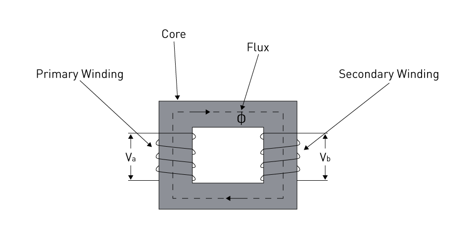

Core
The core of the transformer acts as the pathway for the magnetic flux that the primary winding of a transformer produces and directs to the secondary winding. Furthermore, it is frequently constructed from materials with high permeability, such as silicon steel, in order to reduce the amount of energy lost and ensure that the magnetic flux is transported effectively between the windings. Examples of common core configurations include the core-type configuration, where the windings encircle the core material, and the shell-type configuration, where the core encircles the windings. A number of parameters, such as the desired voltage level, transformer size, and efficiency standards, influence the decision between these designs.
Figure 4: Core type transformer

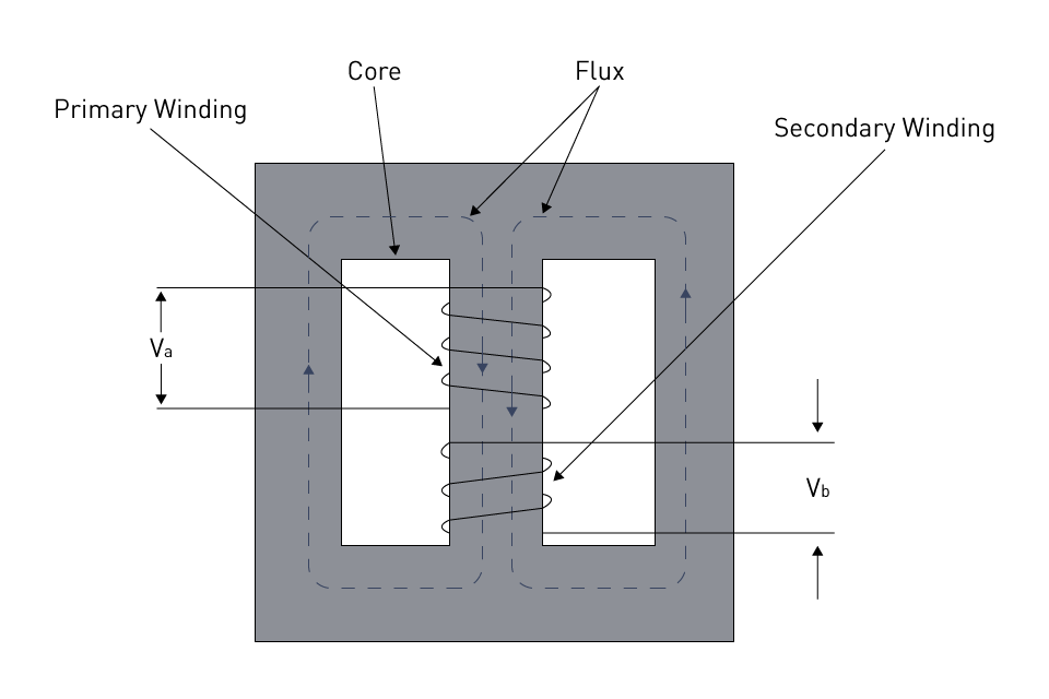

Figure 5: Shell type transformer
Applications with high voltage and high power, such as power generating and transmission substations, as well as those with inductive loads, typically use transformers of the core type.
Transformers of the shell type are appropriate for applications requiring low to medium voltage, such as distribution transformers and special-purpose transformers, as well as situations that require high efficiency and a compact design.

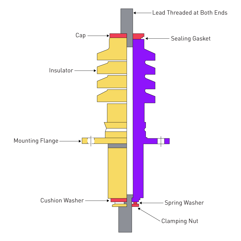

Bushings
Insulating devices known as bushings make it possible for electrical conductors to travel through the grounded transformer tank without risk of interruption. In addition to providing electrical insulation and mechanical support for the high-voltage leads, they also make it easier to connect the internal windings to the external power circuits. Ceramic, epoxy resin, or composite polymers are some of the materials that are used in the production of bushings. These materials are engineered to endure high levels of electrical and mechanical stress.
Figure 6: Transformer bushing
Bushings fall into the following categories based on their design and the uses they serve:
Oil-filled Bushings: Bushings that are filled with oil are a type of bushing that is frequently utilized in high-voltage transformers. These bushings are filled with insulating oil. In addition to providing superior insulating and cooling capabilities, the oil also contributes to the bushing's enhanced performance and increased longevity.
Solid-type Bushings: These bushings are utilized in applications that require lower voltage and are constructed from solid insulating materials such as epoxy or porcelain by their manufacturers. In addition to providing dependable insulation, they do not require the use of oil or gas filling.
Capacitive-graded Bushings: These bushings have a graded insulating structure that minimizes the electric field stress along the bushing. As a result, the bushing's performance and reliability in high-voltage applications are improved.

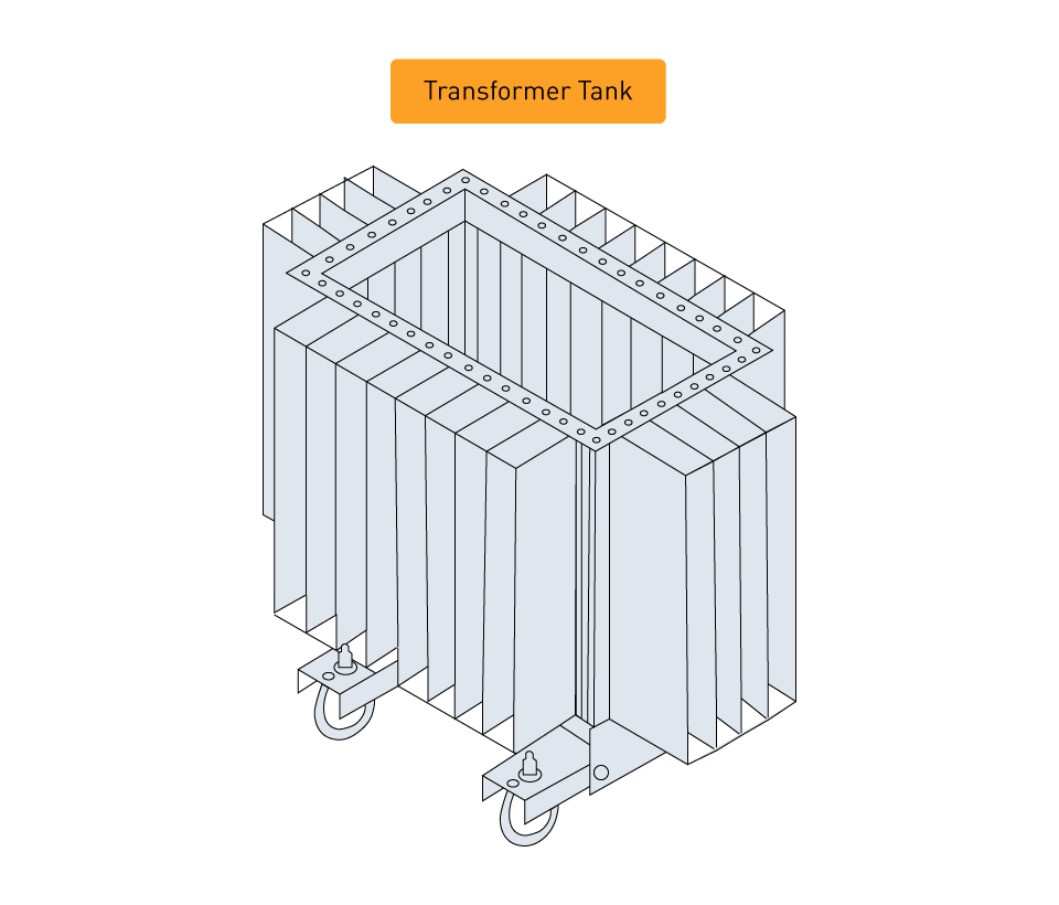

Transformer Tank
The transformer tank is an essential component of a transformer because it houses the core as well as the windings. It provides both structural support and protection from adverse environmental conditions. In most cases, the tank is constructed out of steel, and it is intended to be able to withstand the internal pressures that are brought about by the thermal expansion and contraction of the protecting oil.
Figure 7: Transformer tank
Among the most important characteristics of the transformer tank are the following:
Cooling System: The tank is fitted with radiators, fins, or fans as part of its cooling system in order to dissipate the heat that is produced while it is in operation. It is essential to ensure that the transformer is properly cooled in order to preserve its efficiency and extended lifespan.
Oil Preservation System: A conservator or a nitrogen blanket are examples of oil preservation systems that are included in the tank of oil-filled transformers. These systems are designed to preserve the quality and quantity of the insulating oil so that it can continue to function properly.
Pressure Relief Devices: The tank is protected from overpressure circumstances that are brought either by internal flaws or external impacts by these mechanisms, which are known as pressure relief devices. In order to prevent the tank from rupturing and to guarantee safe operation, they expel any excess pressure.
Gaskets and Seals: The tank is sealed with gaskets and seals to prevent the intrusion of moisture and pollutants, which could damage the insulating oil and have a negative impact on the operation of the transformer.
When performing routine maintenance on the transformer tank, it is necessary to check for leaks, make certain that the gaskets and seals are intact, and keep an eye on how well the cooling system is functioning. When it comes to the overall dependability and effectiveness of the transformer, appropriate maintenance of the transformer tank is absolutely necessary.
