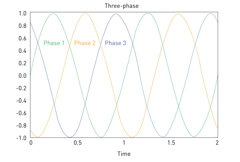

Configurations
The three-phase system configuration consists of three alternating currents (also known as phases) that are generated and transmitted simultaneously. These phases are referred to as Phase A, Phase B, and Phase C.
Figure 15: Three-phase AC

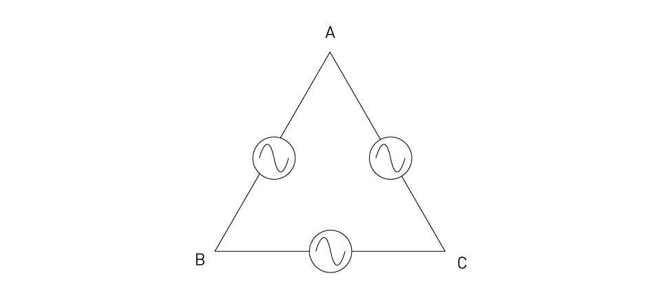

Delta (Δ) Configuration: A Delta configuration connects the ends of each source to form a closed loop in the shape of a triangle or delta. Each side of the triangle carries one phase, allowing current to flow via two sources connected in series, creating a channel for the third phase.
Figure 16: Delta configuration
Line Voltage Equals Phase Voltage: The line current in a Delta connection is √3 times the phase current, while the line voltage is equal to the phase voltage. This characteristic makes the Delta configuration appropriate for systems that need a large current capacity at a constant voltage.
No Neutral Point: The Delta configuration lacks a neutral point, making it more unsuitable for systems that need one for grounding or balancing.

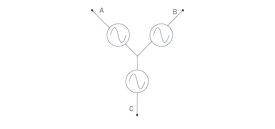

Wye (Y) Configuration: The Wye design connects one end of each source to a common point, resulting in a 'Y' shape. The other coil ends are linked to the load. This configuration allows for the use of both line and neutral connections, which provides voltage level flexibility.
Figure 17: Y-configuration
Phase current equals line current: In a Wye configuration the phase current equals the line current, but the line voltage is √3 times greater, allowing for power delivery at various voltage levels.
Presence of a Neutral Point: The Wye configuration contains a neutral point, which enables the connecting of loads that require a neutral for safety or operational purposes. The neutral also helps to balance loads between the three phases, which improves system stability.

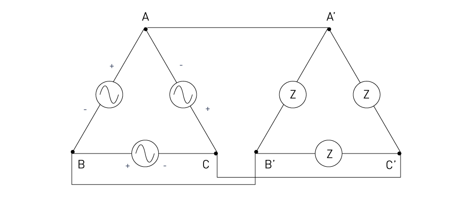

It is possible to connect three-phase sources and loads in a Wye or Delta configuration. While Y-connected systems can employ a fourth neutral wire, delta-connected systems are generally three wire systems.
Figure 18: Delta-connected generator with delta-connected load

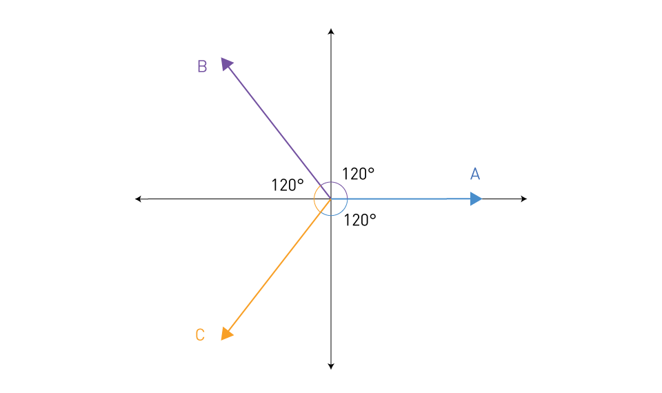

Phasor Diagrams
Phasor diagrams are graphical tools that show the phase correlations between voltages and currents in three-phase systems. In these diagrams, each phase voltage or current is depicted as a vector (phasor), with magnitude and direction proportional to the waveform's amplitude and phase angle. The phasor diagram vividly depicts the 120-degree phase shift between each phase in a three-phase system, emphasizing the system's symmetry. These diagrams are quite useful for visualizing phase balance and assessing power flow in the system.
Figure 19: Phasor diagram of a Y-connected generator

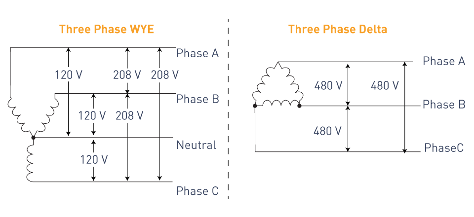

Line vs. Phase Quantities
In three-phase systems, it is essential to comprehend the distinction between line and phase quantities:
Line Quantities: The voltage and current measured between any two lines or system phases are referred to as line quantities. The line voltage in a balanced power distribution system is called Vline or VL-L. The current that passes through every line is known as the line current. The line current in a delta connection is √3 times the phase current, although the phase and line voltages are the same. The line and phase currents in a star connection are equal, but the line voltage is approximately three times the phase voltage.
Figure 20: Line vs. phase voltage
Phase Quantities: Phase quantities are the voltage and current that are measured in the system between a phase and the neutral point. The phase and line voltages in a delta connection are equal. In a star connection, Vline = √3 Vphase, indicating that the line voltage is greater than the phase voltage.
Figure 21: Line vs. phase quantities
