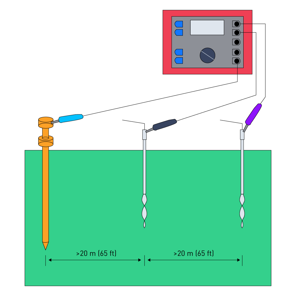

1. Fall-of-Potential Method
The most common ground resistance test. The tester drives three stakes into the earth: the ground electrode under test, a potential electrode, and a current electrode. The tester calculates resistance by dividing the voltage drop between the ground electrode and the potential electrode by the current flowing between them.
Figure 9: Fall-of-potential ground resistance measurement
Procedure:
- Drive the current electrode to a certain distance from the ground electrode.
- Position the potential electrode halfway between the ground and current electrodes.
- Calculate resistance by applying a test current and measuring voltage drop.
Advantages: Accurate, dependable measurements for large grounding systems.
Limitations: The electrodes require ample space and ground access. Disconnect the site's ground electrode first.

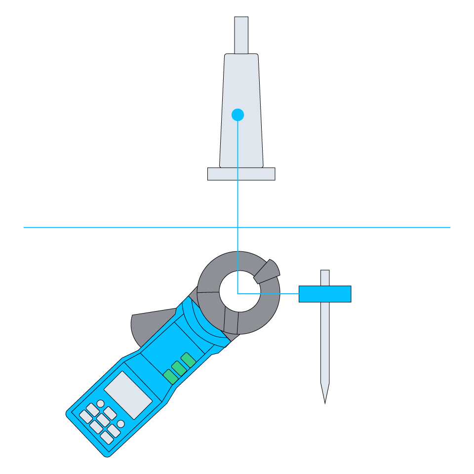

2. Clamp-on Method
A clamp-on ground resistance tester measures resistance without removing the grounding system. It can test individual grounds in multi-grounded systems.
Figure 10: Clamp-on ground resistance measurement
Procedure:
- Positionlace the clamp meter around the ground conductor or rod.
- To compute resistance, the meter creates a test current and detects voltage.
Advantages: No system disruption, non-invasive, fast, and uncomplicated.
Limitations: Complex grounding systems may be less accurate than fall-of-potential.
