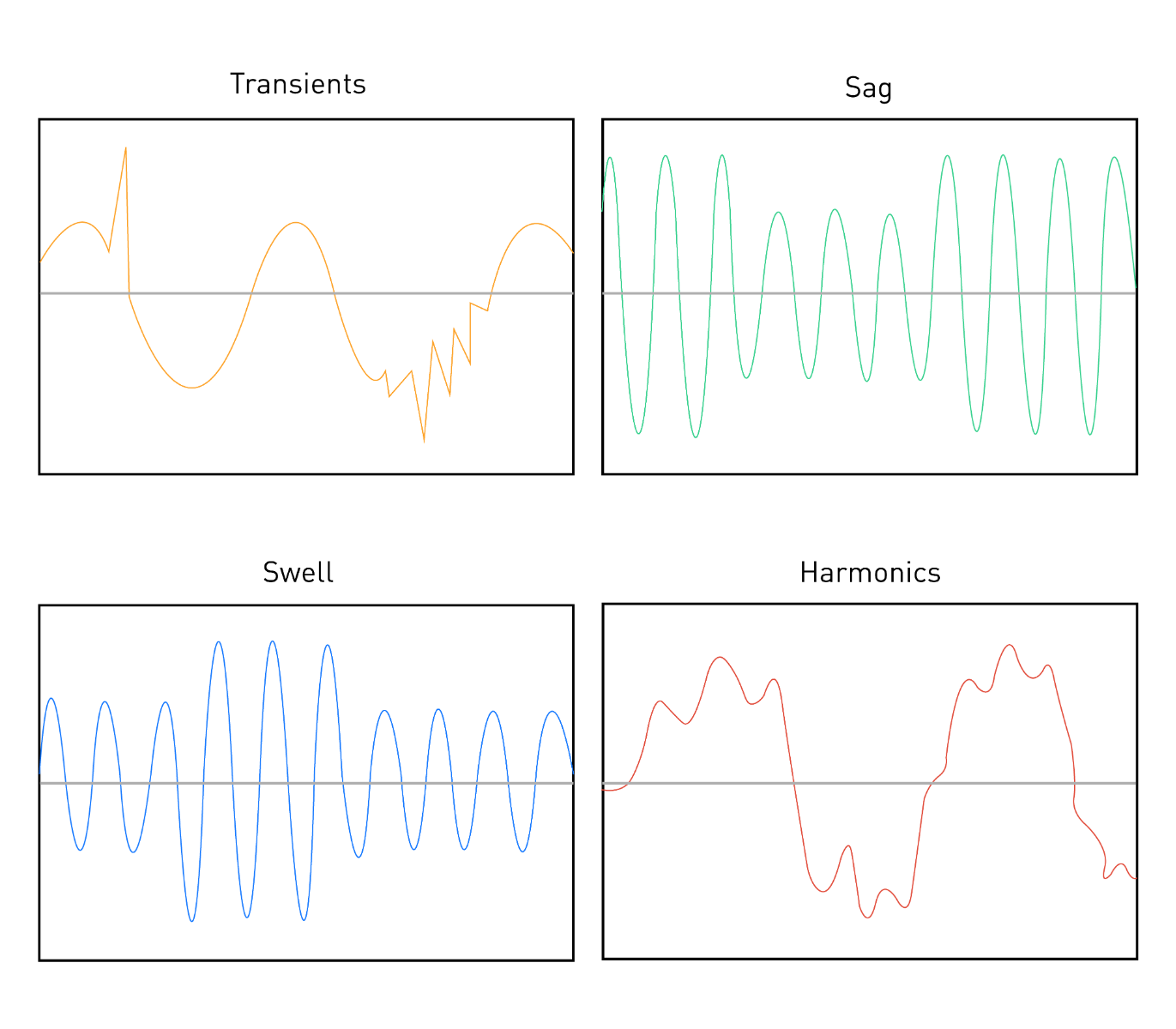

Figure 1: AC Power Line Disturbances
Voltage sags and swells are among of the most common forms of AC line disturbances, and they can have a substantial influence on electrical system performance and reliability. This section investigates the nature, causes, consequences, and mitigation techniques for voltage sags and swells in AC power systems.

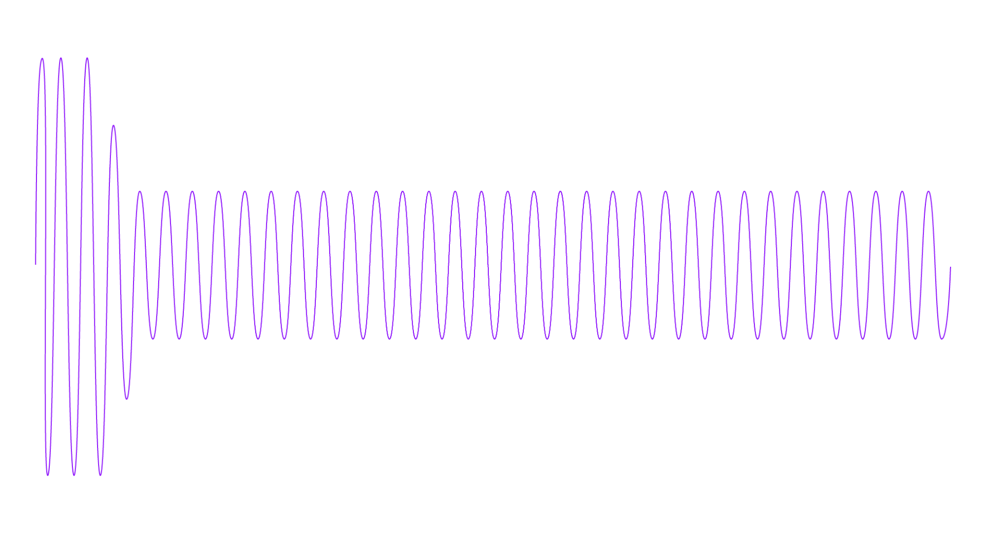

Voltage Sags: Voltage dips are short duration drops in voltage levels that generally last between a few milliseconds to one minute. They are characterized as a voltage drop of 10 to 35% below the nominal line voltage over a 16 ms to 30 s period, which frequently occurs abruptly as a result of system malfunctions or high load start.
Undervoltage is a condition in which the voltage in an electrical circuit or system goes below the minimum level necessary for the proper operation of the equipment.
Figure 2: Undervoltage

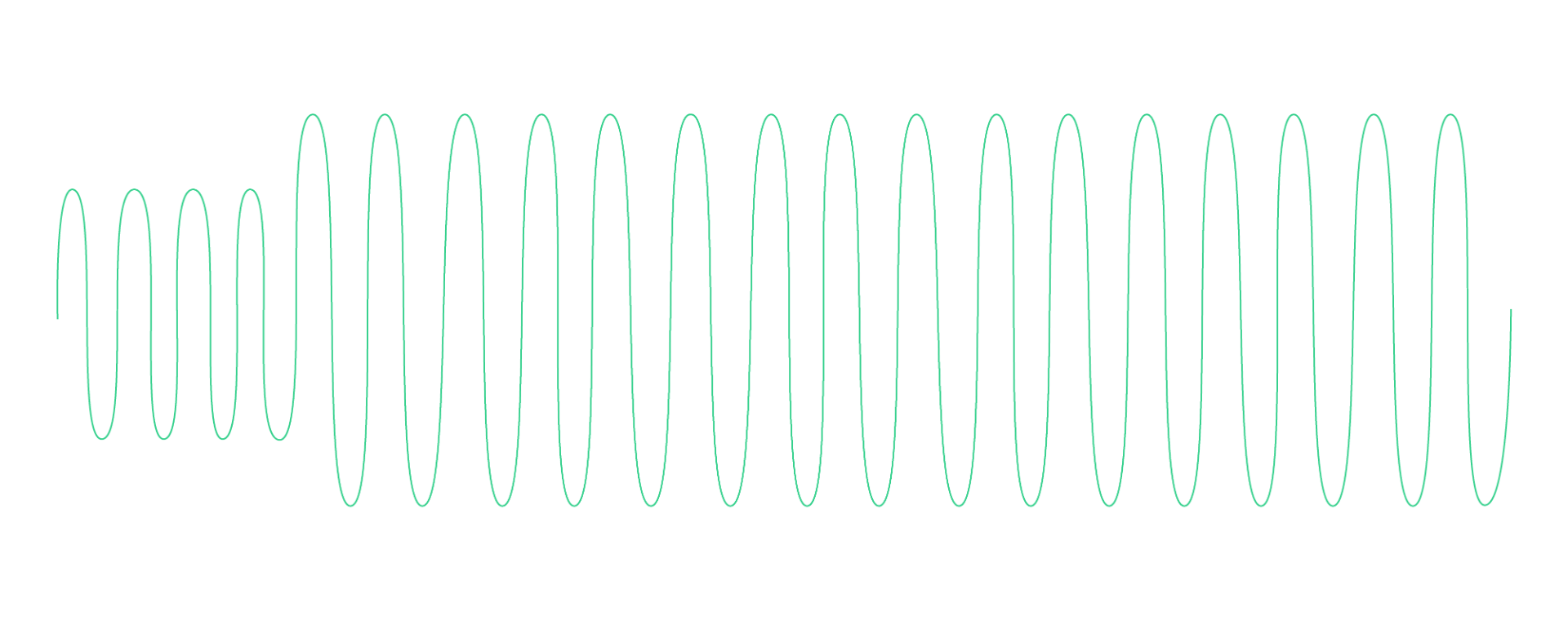

Voltage Swells: These are transient voltage rises above normal levels, often ranging from 10 to 35% above the nominal line voltage during 16 ms to 30 seconds. Swells can be triggered by unexpected substantial load decreases or power system defects, such as a failed neutral connection.
When the voltage in an electrical circuit or system is higher than what is deemed safe or appropriate for the associated equipment or devices, it is referred to as overvoltage.
Figure 3: Overvoltage

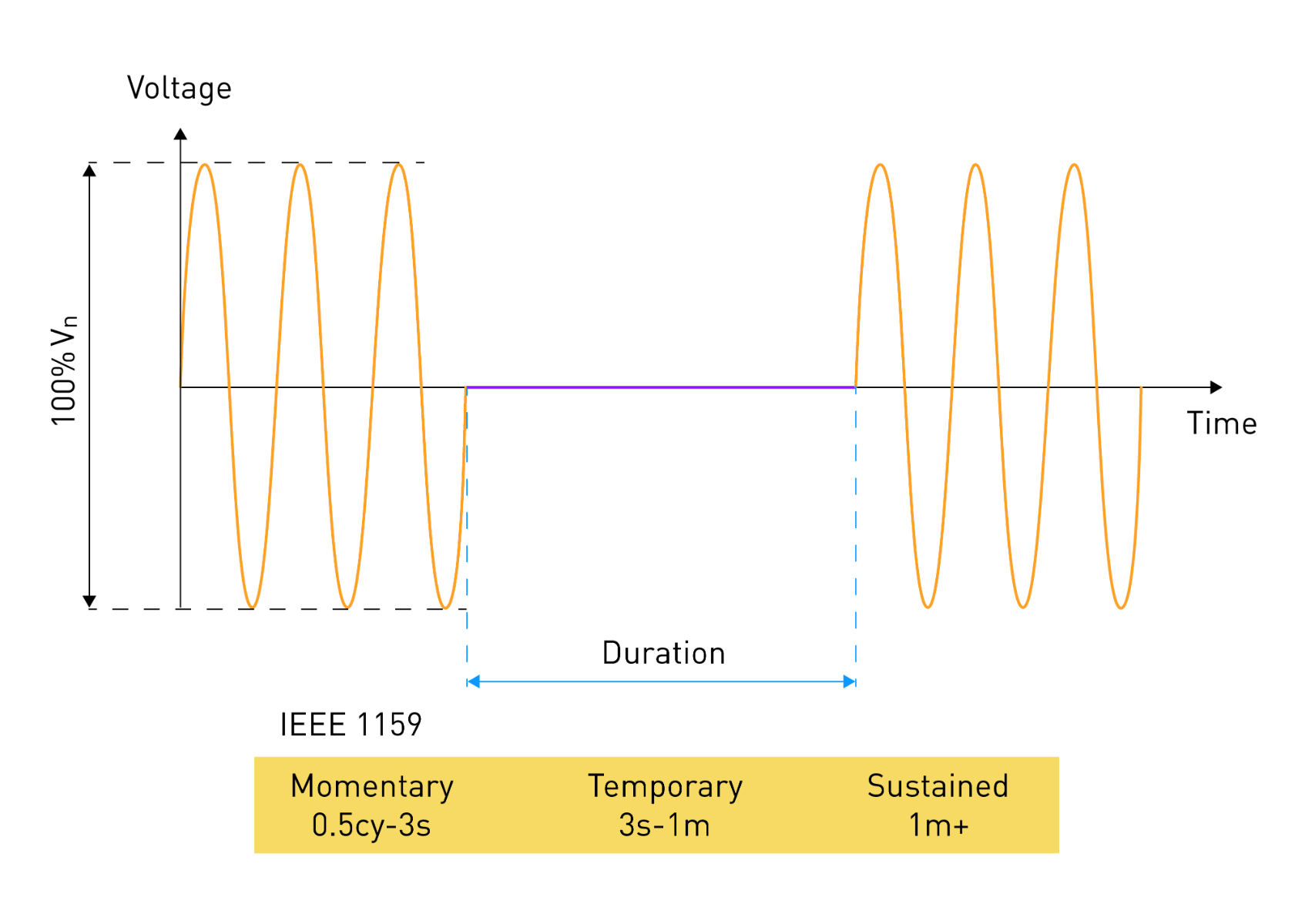

One important kind of AC line disturbance that directly affects the electrical systems' ability to maintain a power supply is voltage interruptions. Power interruptions, characterized by a total loss of power supply for a period that can vary greatly, are among the most inconvenient disruptions for industry and consumers. The nature, causes, effects, and mitigation techniques of voltage interruptions are examined in this section.
Definition and Characteristics
Voltage Interruptions: Voltage supply completely stops during these disruptions, virtually dropping to 0 volts. Disruptions fall into three categories based on how long they last: momentary (less than a few seconds), temporary (ranging from a few seconds to several minutes), or sustained (lasting from several minutes to hours).
Figure 4: Voltage interruptions

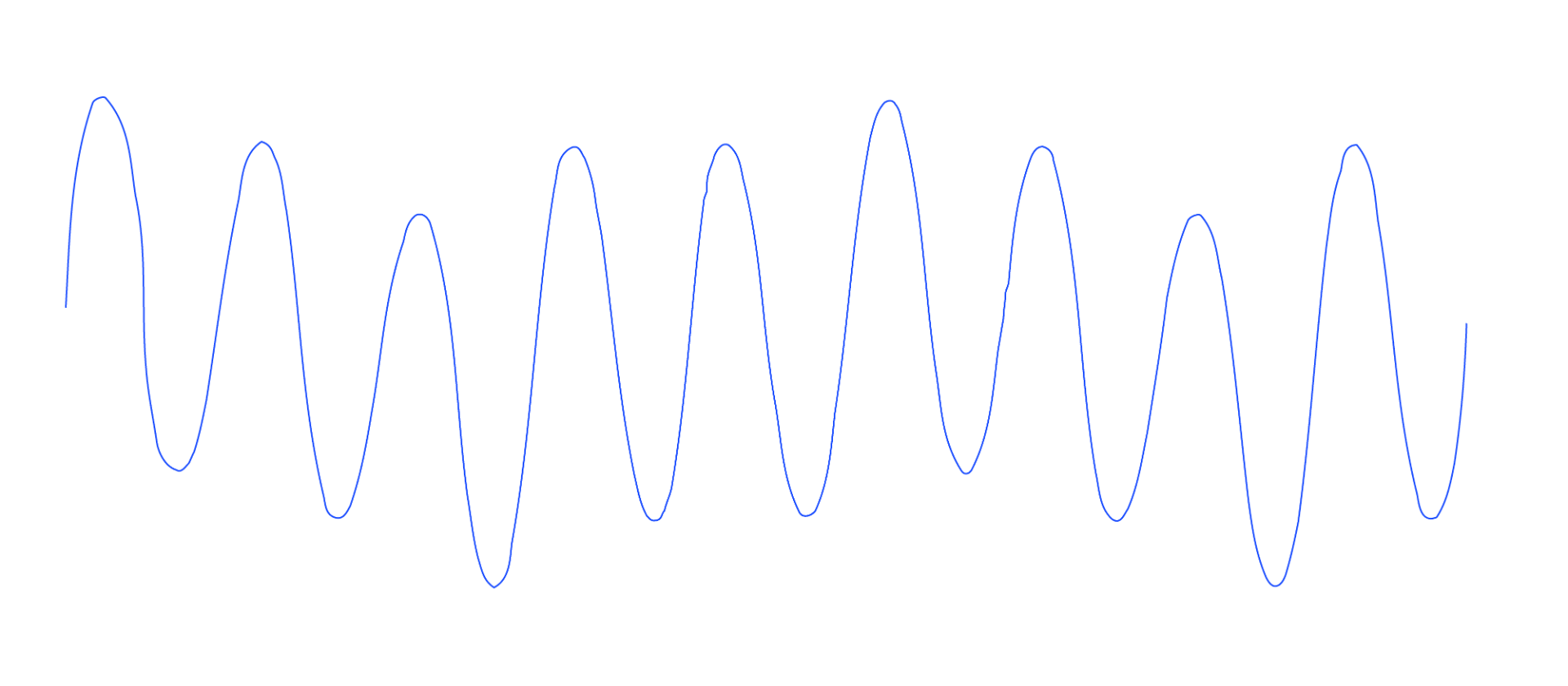

Voltage fluctuations refer to variations in the voltage level of a power supply. These fluctuations may result from changes in demand, defective equipment, or power grid faults. Voltage fluctuations are commonly defined as short-term variations in voltage magnitude, which can have a variety of impacts on electrical systems and devices. These oscillations may be very disruptive to both residential and commercial power consumers, reducing the performance and lifetime of electrical equipment and causing obvious flicker in lighting systems.
Voltage Fluctuations: These are variations from the nominal voltage value in an AC power supply that may not always result in full power loss or substantial overvoltages, but can have a considerable influence on the quality of the electrical service. Voltage fluctuations are commonly defined by their frequency and amplitude, and they can be generated by a variety of causes in the power system.
Figure 5: Voltage fluctuations

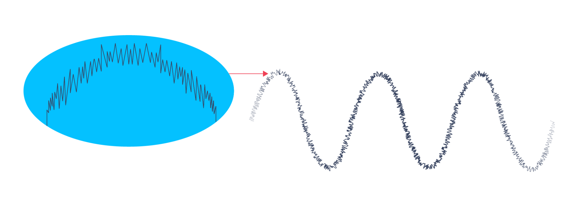

Noise in AC power systems is defined as unwanted electrical impulses that can interfere with the normal operation of electrical equipment. This interference can come from a variety of sources, both internal and external, and appear as high-frequency signals overlaid on the typical power waveform. Understanding the origin, causes, and consequences of noise is critical for preserving power quality and guaranteeing the smooth functioning of sensitive electronic devices.
Figure 6: Noise
