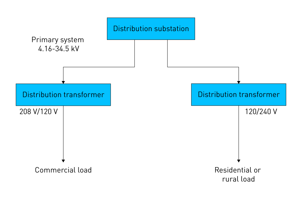

Distribution Transformers
Distribution transformers play a crucial role in electrical power distribution, carrying out the final voltage transformation stage before delivering electrical energy to the end user. The high voltage of the electrical power that is transferred over long distances is reduced by these transformers to lower voltage levels that are suited for usage in commercial, industrial, and residential settings. An examination of the properties, applications, and significance of distribution transformers within the context of the power distribution system is presented in this section.
Figure 8: Role of distribution transformers

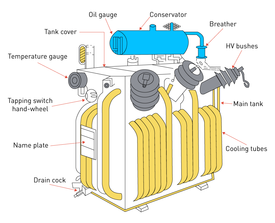

Characteristics of Distribution Transformers
In continuous operation, distribution transformers are intended to operate at voltage levels that are typically lower than those used in transmission equipment. This allows them to achieve high levels of efficiency and dependability. They are distinguished by their relatively tiny size and power rating, and they are intended to provide service to individual consumers, communities, or small industrial operations. Depending on the requirements of the distribution network and the end users, the usual output voltage can range anywhere from a few hundred volts to approximately 35 kilovolts.
Figure 9: Oil immersed natural cooled distribution transformer
Distribution transformers are characterized by their great efficiency, which frequently exceeds 95%. This is of utmost importance because of the constant operation of these transformers. Even little enhancements in efficiency can result in huge savings in terms of both energy and money over the course of time. However, regardless of whether they are mounted on utility poles, housed in underground vaults, or set on ground pads, they are constructed to be able to endure the environmental conditions that are present at the locations where they are installed.

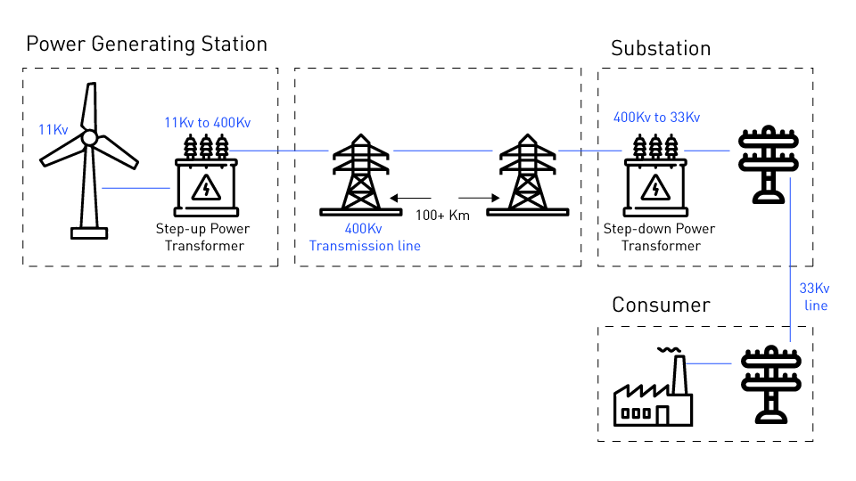

Power Transformers
Power transformers are essential components that comprise the electrical power generation, transmission, and distribution system. These transformers are intended to manage high voltages and enormous loads over extended distances. They play a crucial part in the processes of step-up and step-down voltage levels that occur between the power plant and the distribution network. This aids in the efficient transfer of electrical energy over extensive geographic regions. In this section, we will look into the properties, applications, and relevance of power transformers within the larger framework of power systems.
Figure 10: Power transformer

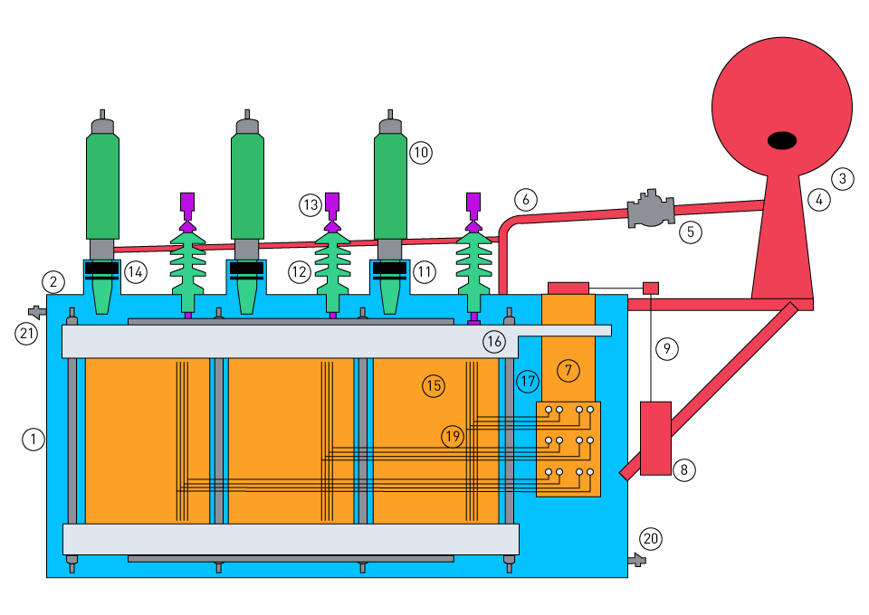

Characteristics of Power Transformers
The capacity of power transformers can range from several hundred megavolt-amperes (MVA) and often exceed 200 kilovolts (kV). High power ratings and their ability to function at high voltages distinguish power transformers. These transformers strive for maximum efficiency, typically exceeding 99%, to minimize losses during energy transmission. Given their significant role in the power grid, their construction prioritizes stability and dependability, enabling them to endure the harsh conditions of high voltage operations.
Figure 11: Power transformer schematic
Substations typically install power transformers due to their size and exposure to high voltages. This is because substations are better equipped to provide necessary maintenance and monitoring. Oil or gas insulation is commonly used to offer cooling and additional electrical insulation. Their construction and insulation systems are carefully built to handle the severe electrical stresses that they are subjected to.
Applications of Power Transformers
One of the most important applications for power transformers is in the transmission network of the power system, where they provide two basic functions:
Voltage Step-Up: Power transformers on the generation side raise the voltage of the generated power to increased levels, causing a step-up in voltage. As a result of this step-up process, the current is decreased for a given power level, which in turn minimizes the resistive losses that occur in the transmission lines that are located at great distances from the load centers.
Voltage Step-Down: Power transformers, which are located closer to the places of consumption, either within sub-transmission or main distribution substations, reduce the voltage from high transmission levels to lower levels that are suitable for distribution networks. When it comes to securely supplying power to end-users and distribution transformers, this step-down procedure is absolutely necessary. Distribution transformers further reduce the voltage for use in residential, commercial, or industrial settings.

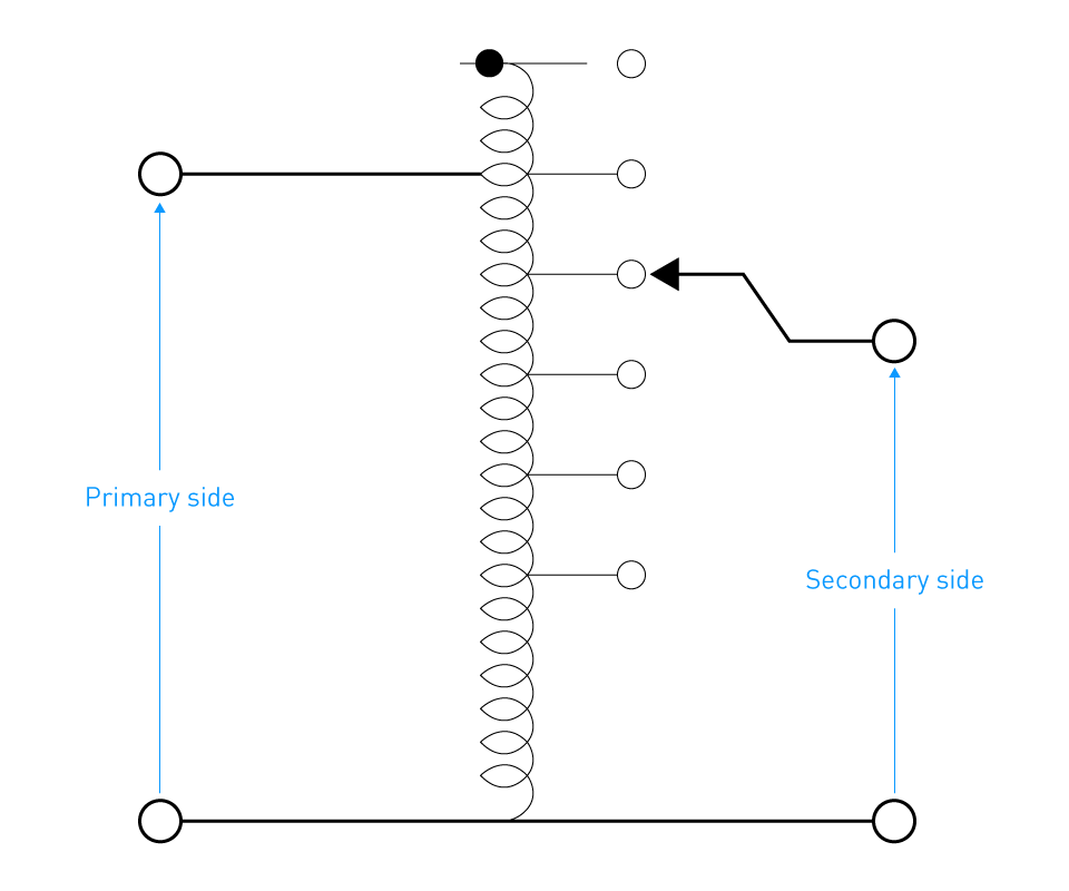

Autotransformers
Autotransformers are a sort of transformer that is both distinctive and effective. Although they share some operational principles with conventional transformers, autotransformers are also fundamentally different in terms of their design and their applications. This layout connects both the primary and secondary circuits to a single winding, sharing a portion of the winding between both circuits. In this part, the design, operation, and uses of autotransformers are discussed. Particular attention is paid to the benefits of autotransformers and the specific applications they have inside electrical systems.
Figure 12: Autotransformer
Design and Operation
An autotransformer is a type of transformer that uses a single, continuous winding with taps located at various positions along the winding to produce different voltage levels. This is in contrast to a traditional transformer, which has one primary winding and two secondary windings independently. The section of the winding, also known as the common section, carries the current that both the input and the output share. The remaining section of the winding is responsible for carrying the difference in current that exists between the primary and secondary sides.
Furthermore, the primary and secondary circuits share a winding terminal that is common to both of them. An additional terminal for the primary circuit is provided by a tap in the winding, and the other terminal for the secondary circuit is provided by another tap. Depending on the taps that are selected, this arrangement makes it possible to have a transformation ratio that is flexible. This configuration also makes it possible for the autotransformer to regulate voltage levels in an effective manner.

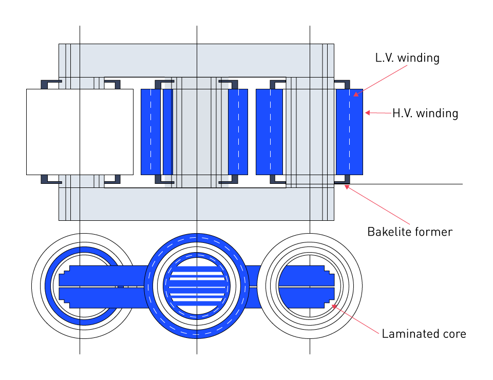

Three-Phase Transformers
When it comes to the distribution and consumption of electrical power in residential, commercial, and industrial situations where three-phase electricity is necessary, three-phase transformers are an essential component. In contrast to a single-phase transformer, which is only capable of handling a single phase of electricity through the use of two wires, a three-phase transformer can handle three phases simultaneously through the use of either three independent coils (one for each phase) or a single three-phase core. This section delves into the structure, function, and benefits of three-phase transformers, highlighting their utility in alternating current (AC) power systems.
Figure 13: Three phase core type transformer
Structure and Operation
Two basic methods are available for the construction of three-phase transformers: the first method involves combining three single-phase transformers to create a three-phase bank, and the second method involves utilizing a single unit that contains a three-phase core. When compared to a comparable set-up consisting of three single-phase units, the three-phase core design is more compact and cost-effective. It also provides higher power consistency and lower material requirements.
Three-phase transformers operate on the same principle of electromagnetic induction as single-phase transformers. Conversely, their purpose is to regulate three phases of alternating current (AC) power, rendering them a superior option for systems that prioritize power density and efficiency. The configurations in which three-phase transformers can be linked can vary, depending on the requirements of the application in terms of voltage levels and phase stability. These configurations include star (Y) connections, delta (<0xD3>) connections, or a combination of both variations.
