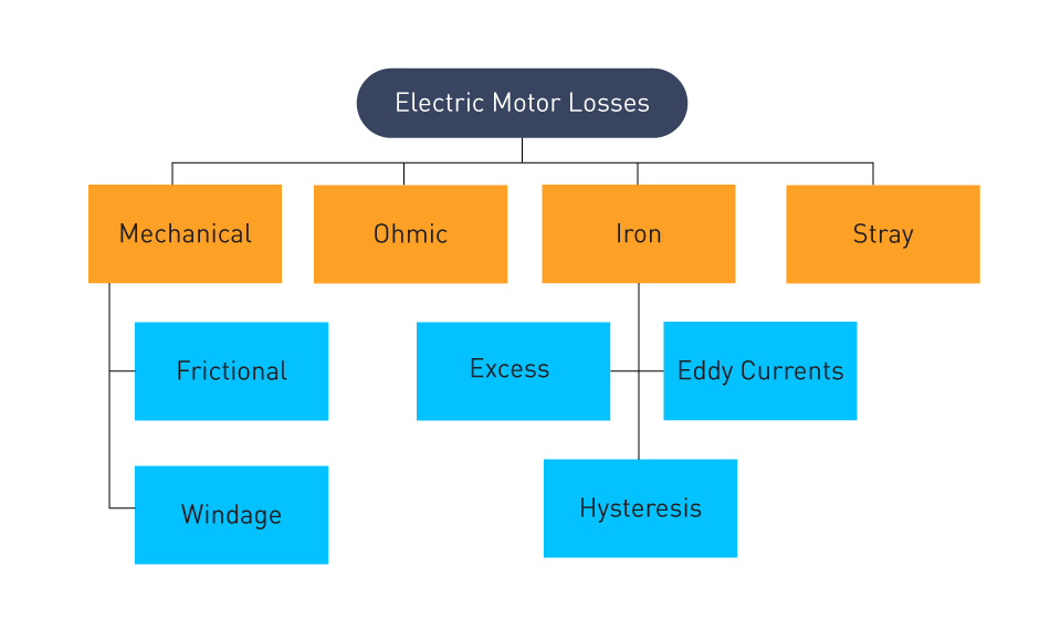

Efficiency and Motor Losses
Typically represented as a percentage, the efficiency of a motor is usually defined as the ratio of mechanical power output to electrical power input. Transforming a greater proportion of electrical energy into mechanical energy while minimizing losses characterizes motors with high efficiency. Motor efficiency is influenced by various factors, including electrical losses (such as copper losses in windings and iron losses in the core), mechanical losses (like friction in bearings), and stray load losses (including leakage inductance and aerodynamic drag).
Figure 6: The Different Type of Motor Losses
Motor Losses:
- Ohmic Losses (Resistive Losses): The resistance found in the motor's windings contributes to these losses. A result of the inherent resistance of the material, energy is dissipated in the form of heat as current flows through the conductors. During high-load conditions, this type of loss becomes significant as it increases with the square of the current.
Mechanical Losses:
- Windage Losses: As the motor's rotor spins, these losses arise from air resistance. The design of the motor's enclosure and the rotor's speed influence windage losses.
- Frictional Losses: Due to friction between moving parts within the motor, such as bearings and brushes (in brushed motors), these losses occur. Frictional losses can be minimized through proper lubrication and regular maintenance.
Stray Load Losses: These losses lead to inefficiencies that are not directly accounted for in other categories, arising from non-ideal distributions of magnetic fields. Increasing with the load, stray load losses can be affected by factors such as manufacturing inconsistencies and asymmetries in the motor's construction.
Iron Losses: Related to the motor's magnetic core, these losses can be further categorized into:
- Hysteresis Losses: Energy loss occurs due to the lag in the alignment of the magnetic domains within the iron core when the motor's magnetic field reverses with each cycle of the AC current. For constructing the motor core, materials with low hysteresis loss are preferred.
- Eddy Current Losses: These arise when the altering magnetic field induces currents within the core material itself. Heat generation and energy loss result from these induced currents. Eddy current losses can be reduced by laminating the core or utilizing materials with high electrical resistivity.
- Excess Losses: Under load conditions, these are additional iron losses that arise from non-uniform distribution of the magnetic field and saturation effects in the core.
