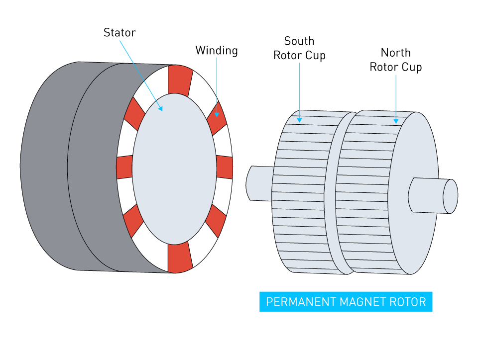

Rotor: The rotor is the moving part of a stepper motor, and the design of the rotor changes depending on the type of stepper motor being used. Permanent magnet (PM) stepper motors are characterized by the construction of the rotor with permanent magnets, which results in the generation of a magnetic field.
Figure 1: Permanent Magnet Stepper Motor Construction

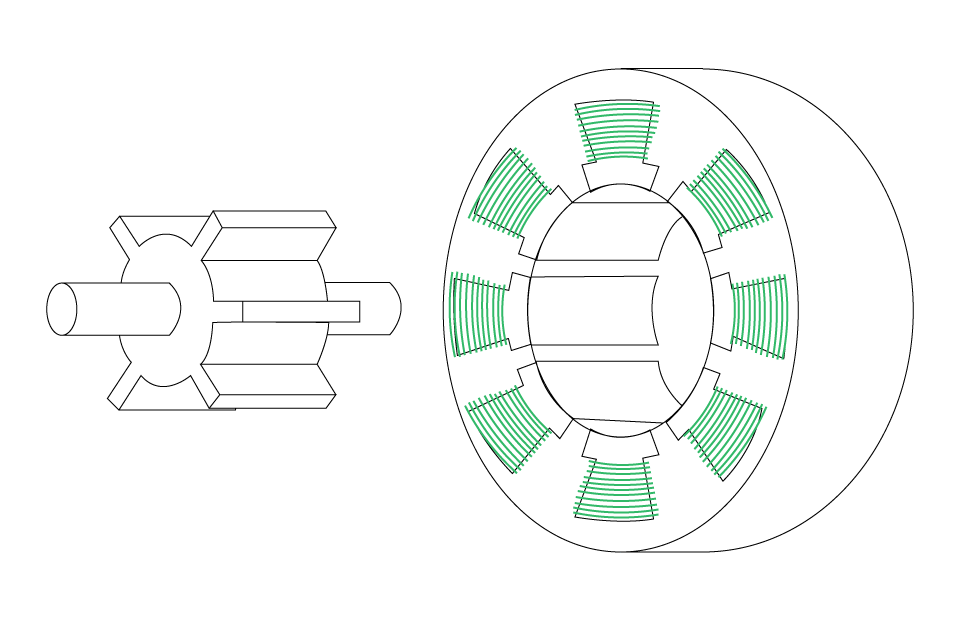

The rotor of a variable-reluctance (VR) motor is constructed out of soft iron and features teeth that protrude from it. This rotor is meant to align with the magnetic poles of the stator while the motor is operating.
Figure 2: Variable Reluctance Stepper Motor Construction

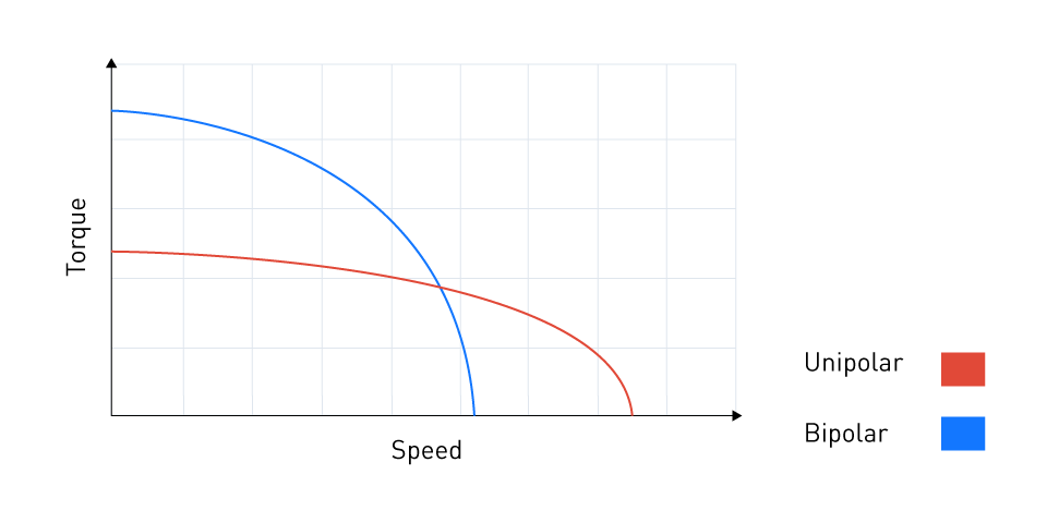

Bipolar Stator Configuration
Every phase of the stator in a bipolar stepper motor includes two windings, and current can flow in either direction through those windings thanks to the bipolar design. Because of this configuration, a more complicated driving mechanism is required. This mechanism must be able to reverse the direction of the current in order to alter the magnetic pole, which will allow the motor to undergo stepping. The reversal of current is accomplished by using an H-bridge circuit for each phase, which enables fine control over the movement of the motor.
Bipolar motors are distinguished by their high torque and performance capacity, which is a direct result of the efficient utilization of all windings in the production of a powerful magnetic field. On the other hand, because of the intricate nature of the driving circuitry, bipolar stepper motors often demand controllers that are more complex and costly.
Unipolar Stator Configuration
Unipolar stepper motors are characterized by their ability to simplify the driving mechanism by enabling current to flow through each winding in only one direction. This is accomplished by dividing each phase winding into two equal halves, with a common center tap for each phase. This allows for the desired result. The motor is operated by sequentially activating these windings, which pulls the rotor into alignment with the magnetic field generated by the winding that has been triggered.
It is not necessary to use H-bridge circuits in order to reverse the flow of current in unipolar motors, which results in control circuits that are less complicated and more cost-effective. The simplicity of this construction, however, comes at the expense of less torque when compared to bipolar configurations. This is because only half of each phase winding is utilized at any given time.
Choosing Between Bipolar and Unipolar
A number of considerations such as the required torque, the complexity of the control, and the limits of cost, are taken into account while deciding between bipolar and unipolar topologies. Due to their higher torque and performance, bipolar motors are well-suited for applications that require precise control and a substantial amount of driving force. Some examples of such applications include CNC machines and robotic components. On the other hand, unipolar motors are frequently utilized in applications where simplicity, cost-effectiveness, and ease of control are of the utmost importance. Applications such as consumer electronics and straightforward automation chores are examples of such applications.
Figure 4: Comparison of typical Speed-Torque Characteristics
