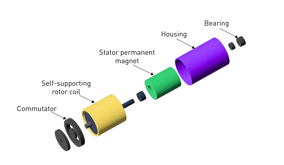

The motor may also be of the coreless variety, in which the rotor is constructed from windings that form a self-supporting, hollow cylinder and are held together with epoxy. This type of motor does not have an iron core for its rotor. The motor housing attaches the stator, which completes the electrical circuit. The stator's permanent magnets are housed inside the rotor. Bearings hold the rotor in place as it rotates around the stator.
Figure 4: Coreless Brushed DC Motor

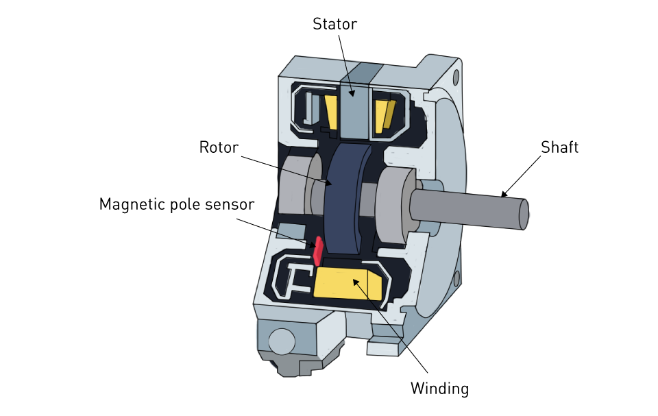

Working Principles: By positioning the permanent magnets on the rotor and the windings on the stator, brushless DC (BLDC) motors are able to operate in a manner that is perverse to the architecture of brushed motors. Electronic controllers, replacing mechanical brushes and commutators, switch the current in the stator windings to form a revolving magnetic field that powers the rotor. This electronic commutation allows for precise control over the motor's operation.
Construction and Components: A BLDC motor consists of a rotor with permanent magnets, stator windings, and an electronic controller with sensors to detect the rotor's position. The controller uses this information to determine the appropriate timing for switching current in the stator windings, resulting in the generation of a magnetic field that rotates the rotor.
Figure 5: BLDC (Brushless DC) Motor

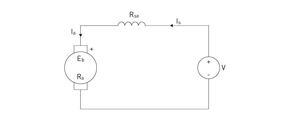

Series DC Motors:
DC motors in series are characterized by the fact that they connect the field windings in series with the armature. Series motors are appropriate for applications that require powerful initial movement such as electric vehicles and cranes, because this arrangement enables the motor to deliver a large starting torque despite its relatively modest starting torque.
Figure 6: Substitution circuit of The Series DC Motor
The equation that governs behavior after reaching a steady state is as follows:
$$V=Ia (Ra+Rse)+Eb$$Where:
V represents the applied voltage to the motor terminals.
Ia represents the armature current.
Ra represents the armature circuit resistance (including brushes and contacts).
Rse represents the resistance of the armature winding.
Eb represents the back EMF (Electromotive Force) generated in the armature due to rotation.

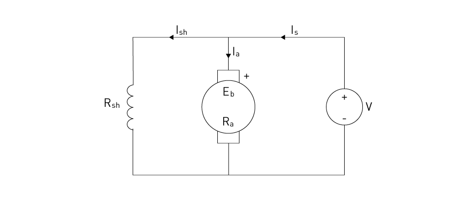

Shunt DC Motors:
Shunt motors, also known as parallel motors, are characterized by the fact that they connect the field windings in parallel with the armature. For applications that require precision control, such as conveyor belts and lathe machines, this design provides good speed regulation and a speed that remains relatively constant under variable loads.
Figure 7: Substitution circuit of The Shunt DC Motor
$$V=Ia \times Ra+Eb$$Where:

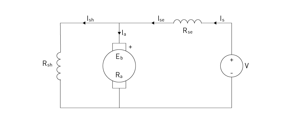

Compound DC Motors:
Compound motors contain both series and shunt winding designs, providing a balance between high beginning torque (a characteristic of series motors) and effective speed regulation (a characteristic of shunt motors). A wide variety of applications, ranging from heavy-duty industrial gear to automotive starters, can benefit from their versatility as a result of this.
Figure 8: Substitution circuit of The Compound DC Motor
$$V=Ise \times Rse+Ia \times Ra+Eb$$Where:
Ise represents the series field current
Eb represents the back EMF (Electromotive Force) created in the armature due to rotation.

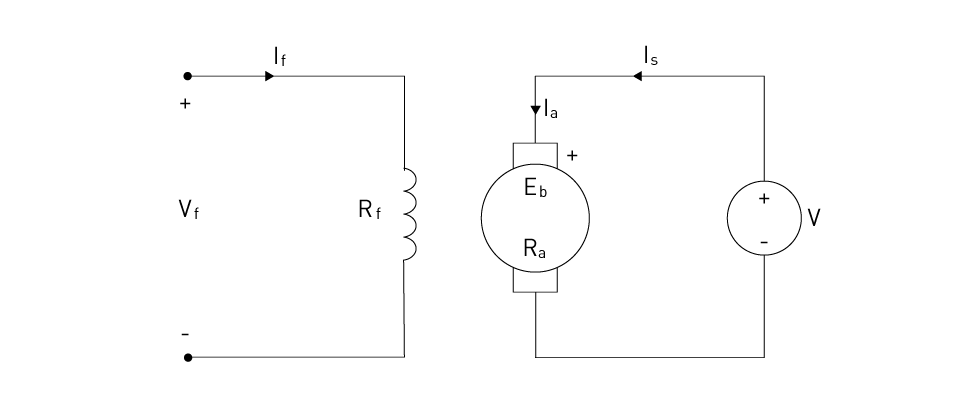

Separately Excited DC Motors
An external power source energizes the field windings of differentiated alternating current (DC) motors, independent of the armature circuit. This allows for more precise control of the motor's magnetic field and, consequently, its performance characteristics.
Working Principle: The working principle of independently excited motors allows for precise regulation of the magnetic field intensity without altering the armature current. Consequently, this allows for highly precise control of the motor's speed and torque output.
Figure 9: Substitution Circuit of the Separately Excited DC Motor
The ruling equation of steady state behavior as follows:
$$V=Ra \times Ia+Eb=Ra \times Ia+Laf \times If \times w$$Where:
V represents the applied voltage to the armature terminals.
Laf represents the mutual inductance between the armature and field windings.
If represents the field current.
w represents the motor speed.
