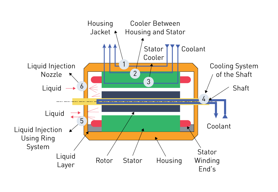

Integrated cooling systems: New motor designs incorporate advanced cooling techniques directly into the motor's construction. These techniques include liquid-cooled stators or rotor cooling channels, which help regulate heat more effectively and increase the motor's performance.
Figure 2: Liquid cooled stator concept

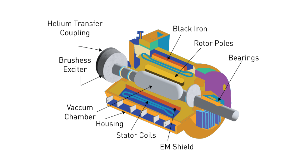

Superconducting motors and motors that make use of soft magnetic composite (SMC) materials are two of the most promising technologies for the advancement of motor technology in the next generation. Although they are currently mostly in the experimental and development stages, superconducting motors offer nearly zero electrical resistance at extremely low temperatures. This significantly boosts efficiency by reducing the amount of energy lost as heat. During this time, motors constructed with soft magnetic materials have the advantage of lower core losses and a larger saturation magnetization, both of which contribute to an increase in their efficiency at higher frequencies.
Superconducting motors: These motors make use of superconducting wires, which are able to carry much bigger currents than regular wires. As a result, they are able to generate extremely high magnetic fields without the heat losses that are associated with normal materials.
Figure 3: Example Construction of a Superconducting Motor
