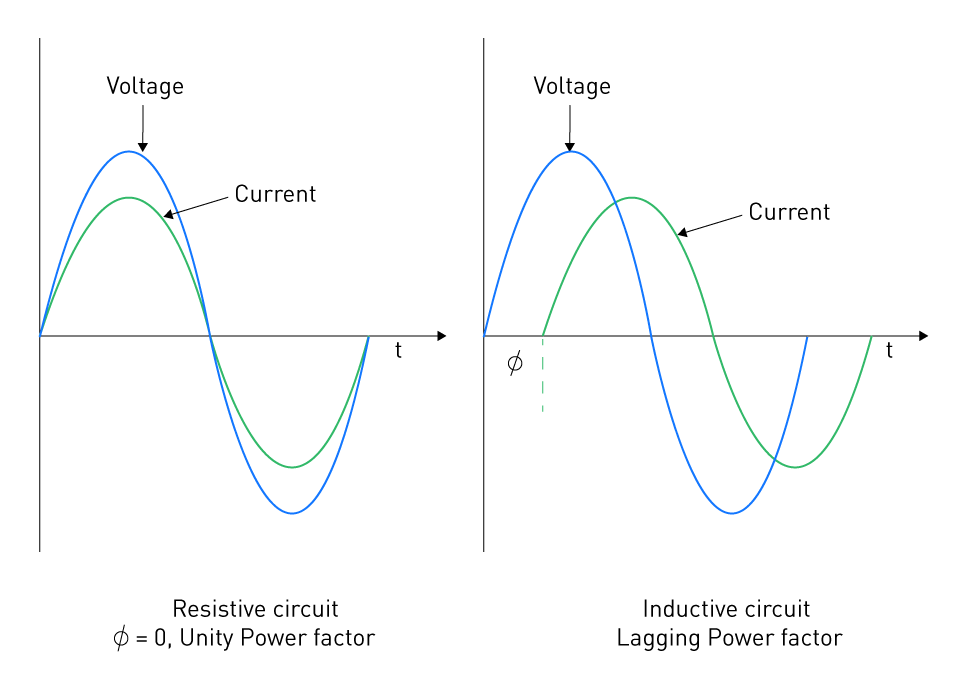

In alternating current (AC) motors, the power factor is a measurement that indicates how efficiently the motor utilizes electricity to carry out its function. Real power, which is measured in watts, is the amount of power that the motor requires to perform work. The apparent power, which is measured in volt-amperes, is the amount of power that is drawn from the power source. Connecting an alternating current (AC) motor to a supply network causes the network to perceive it as an inductive load, as the AC motor also includes inductive components. The inductive component of the motor circuit causes the phase of the electric current to lag behind the voltage. Since real power is a function of both current and voltage, the current lag in sinusoidal waveforms will lead to a decrease in real power. To achieve the intended level of real power, the motor must draw a greater amount of current from the network, which is a drawback.
Figure 1: Depiction of Resistive and Inductive Circuit Sinusoidal Waveforms
A low power factor suggests that a significant portion of the electrical power is not effectively converting into meaningful work, while a high power factor signifies efficient use of the electrical power. In this specific case, the motor's perceived current draw is causing the system to lose unwanted heat.
In general, alternating current (AC) motors, and induction motors in particular, have a power factor that shifts depending on the load. The power factor may be high (near to 1) while the load is at its maximum, which is an indication of efficient functioning. On the other hand, when partial loads are present, the power factor might drop dramatically, which can result in an inefficient use of power and greater expenditures due to increasing demand charges from utilities.

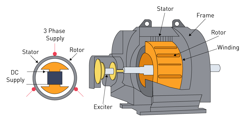

The smooth integration and functionality of the primary components of alternating current (AC) motors, which include the stator, rotor, and a number of other essential components, is essential to the efficient running of these motors. The conversion of electrical energy into mechanical motion is a process that involves each component playing an important role. The design and material concerns of the motor have a substantial impact on its performance, efficiency, and application suitability.
Detailed Look at Stator, Rotor, and Other Components
Stator: The stator is the stationary component of an alternating current (AC) motor. It is made up of wire coils that are wound around a metal core and enclosed within the housing of the motor at the same time. The alternating current generates a magnetic field that rotates when it travels through these coils. The design of the stator, which includes the number of windings and their arrangement, directly impacts the speed, torque, and efficiency of the motor.
Rotor: The rotor is the component of the motor that is responsible for rotation. It is housed within the stator. Induction motors can utilize a squirrel-cage design, which consists of conductive bars connected at both ends by rings, or a wound rotor, which consists of windings connected to slip rings. The rotor's architecture enables it to interact with the stator's magnetic field, leading to rotation. The motor's starting torque and slip characteristics are influenced by the design of the rotor as well as the material that it is made of.
Cooling System: During operation, alternating current (AC) motors produce heat. To dissipate this heat, which is necessary for preventing damage and maintaining efficiency, it is critical to have efficient cooling systems, which may include fins, fans, or liquid cooling.
Frame: The enclosure of the motor shields its internal components from environmental factors, including dust, moisture, and chemicals. It also has the ability to affect the amount of cooling and noise that occurs. Enclosures are categorized according to the level of protection they offer, with certain designs being more or less appropriate for use in hazardous or outdoor conditions.
Figure 2: Example Construction of an AC Motor (Synchronous with Exciter)
