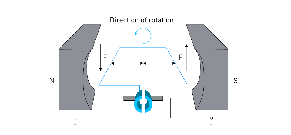

How DC Motors Generate Rotational Motion
The interplay of two magnetic fields is what causes DC motors to generate rotational motion. The current flowing through the armature windings creates one magnetic field, while either permanent magnets or field windings in the stator generate the other magnetic field. The armature windings are responsible for the flow of electric current that enters the motor through the brushes and commutator. The interaction between this current and the stator's magnetic field generates a force on each of the armature's conductors. This force is perpendicular to both the direction of the current and the magnetic field, which causes the armature to rotate. This is in accordance with Fleming's left-hand rule regarding force.
Figure 1: Generation of Rotation In a DC Motor
Commutation
In DC motors, the process of commutation involves reversing the direction of current in the armature windings in order to keep the rotational motion in a single direction as continuous as possible. The brushes and commutator regularly reverse the current flow in the windings while the armature maintains its spinning position. The interaction of the magnetic fields always directs the torque in the same direction, allowing the motor shaft to rotate smoothly and uninterruptedly.

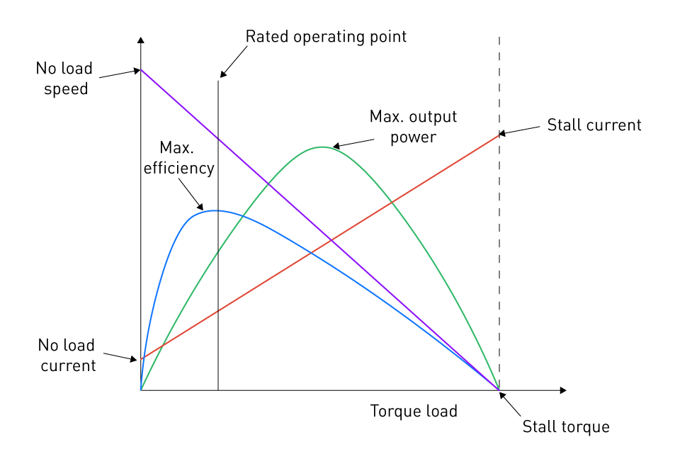

Torque Characteristics
Understanding Torque in DC Motors: The interaction between the armature current's magnetic field and the environment's magnetic field produces a torque on the armature, causing it to rotate. By modifying the magnitude of the current that flows through the armature windings, it is possible to control the amount of torque that is experienced and, as a result, the speed at which the motor operates. This fundamental principle underpins the operation of DC motors, enabling control over the speed and torque output.
Relationship Between Torque and Motor Variables: The link between torque and the variables of a DC motor is complex and involves a number of different aspects, including the armature current, the strength of the magnetic field, the architecture of the motor, the supply voltage, and different load characteristics. There is a linear relationship between the armature current and the torque output, which means that current is the most important component in controlling torque. Similarly, enhancing the strength of the magnetic field through field windings or permanent magnets boosts the overall torque. The design parameters of motors, such as armature dimensions and winding configurations, significantly influence turbine capabilities. The supply voltage determines the maximum armature current, which indirectly influences torque. The supply voltage primarily affects the speed of the motor.
Figure 2: Characteristic Curves Of A Brushed DC Motor
