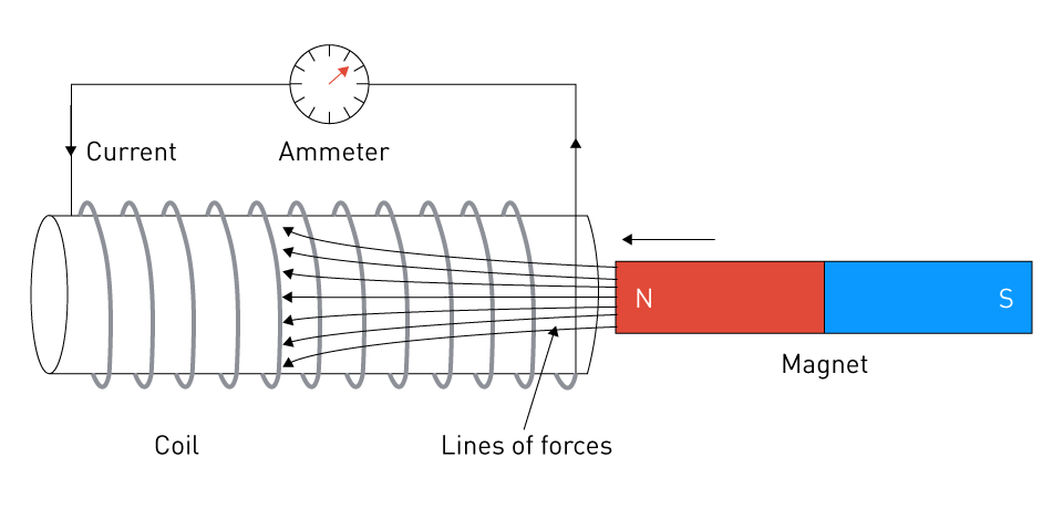

The process by which a change in the magnetic field within a coil of wire induces an electromotive force (EMF) in the coil is known as electromagnetic induction. A magnetic field within a coil induces an electric current, constituting the reverse process of the phenomenon described above. A cornerstone of motor operation, Faraday's Law of Electromagnetic Induction quantitatively describes this effect:
Figure 3: Faraday’s Law of Electromagnetic Induction
The ruling equation is:
$$\varepsilon=-N\frac{d\phi}{dt}$$Where:
ε is the electromotive Force (EMF)
N is the number of turns of the coil
φ is the instaneous change of magnetic flux with time

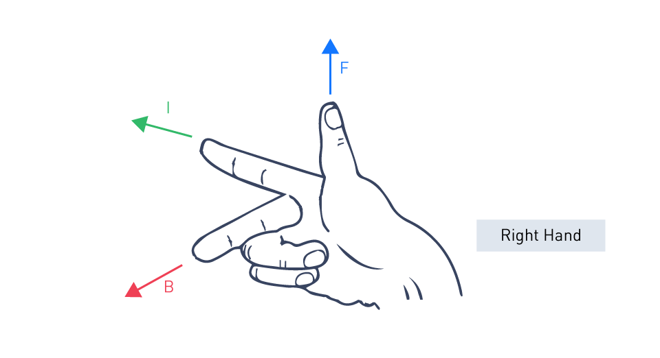

Consider a scenario where there is a loop of wire with current flowing through it placed within a magnetic field in a simplified context. A force is exerted on the current-carrying wire by the magnetic field. Resulting in the rotation of the loop, this force's direction, according to the Lorentz Force Law, is perpendicular to both the current's direction and the magnetic field. Most electric motors operate based on this fundamental principle of rotation.
Relating the directions of current, magnetic field, and force, the right-hand rule can be employed to ascertain the direction of rotation and the magnitude of torque. The magnitude of torque produced is influenced by factors such as the intensity of the magnetic field, the quantity of current passing through the wire, and the dimensions of the loop.
Figure 4: Right-Hand Rule

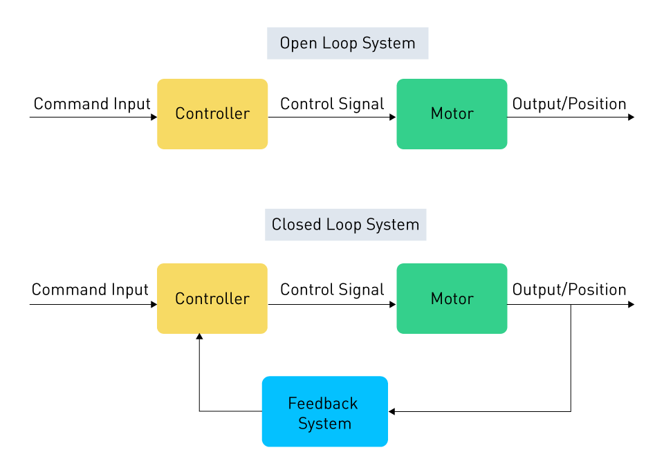

The motor control tactics differ depending on the motor type and the needs of the application. Open-loop control and closed-loop control represent the two main strategies employed in motor control.
Open-Loop Control: In open-loop systems, the controller dispatches a directive to the motor without receiving feedback to confirm the result. This implies that the motor functions according to the input command, irrespective of the actual output. This approach is less intricate and more economical, yet it sacrifices precision since it does not accommodate disturbances or fluctuations in the motor's performance over time.
Closed-Loop Control: Conversely, closed-loop control systems integrate feedback mechanisms. These systems continually adjust the input control signals based on monitoring the motor's output. Typically, sensors like encoders, tachometers, or resolvers provide feedback by measuring parameters such as speed, position, and torque. To minimize any deviation, the controller compares the actual output with the desired output and adjusts the control signals accordingly. Closed-loop systems, thanks to this feedback loop, enable precise motor control, rendering them suitable for applications demanding high accuracy and reliability.
Figure 5: Open-Loop and Closed-Loop Control of Motors
