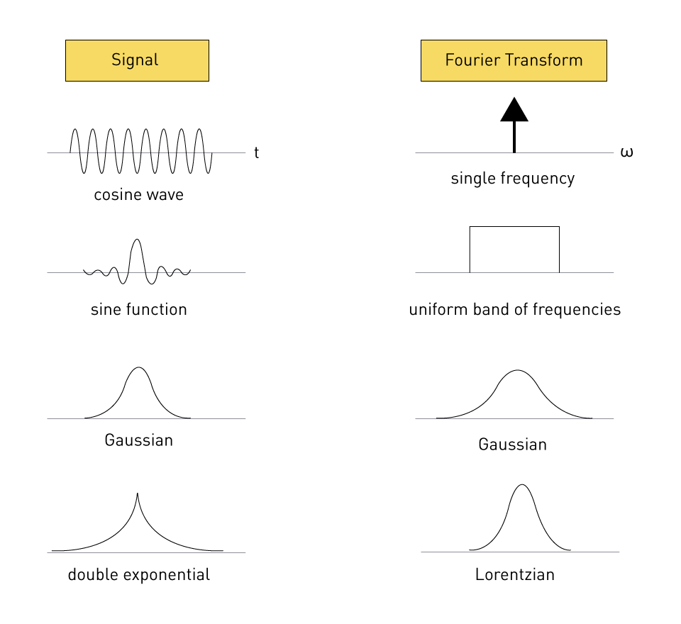

Each signal includes multiple frequency components, and frequency-domain analysis focuses on how a system responds to different signals, each with a unique frequency composition. In the analysis, time-domain signals are represented in terms of their frequency components, and the time domain is transformed to the frequency domain using Fourier or Laplace transforms.
Figure 7: Signal translation between time and frequency domains

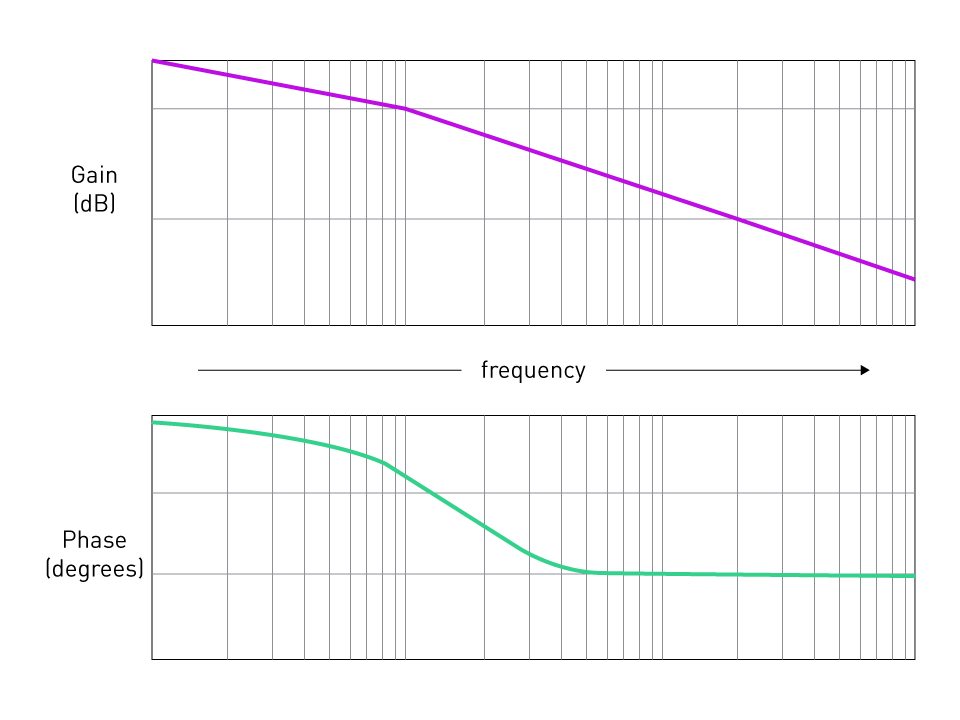

Bode Plot Analysis: Frequency-domain analysis is frequently used to create Bode plots, which graphically represent a system's phase shift and gain over a range of frequencies. Bode plots are crucial for the analysis and design of feedback control systems because they offer details about the bandwidth, resonance frequencies, and stability margins of the system.
Figure 8: Bode plot

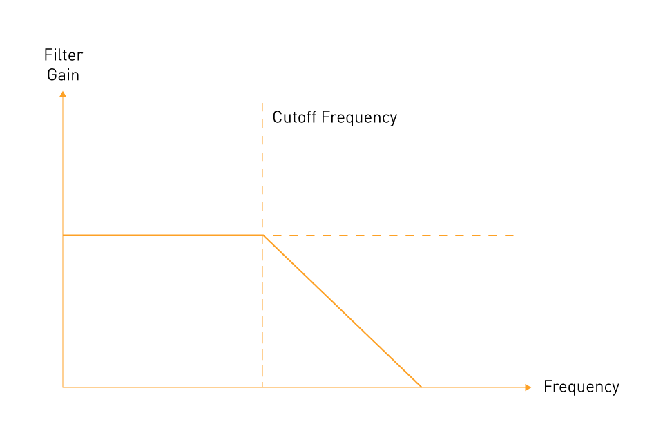

Single-Parameter Sweeps: A parametric sweep is most simply defined as changing a single parameter over a specific range while keeping all other parameters constant. This enables the engineer to focus on the precise effects of a single variable on system performance.
Figure 9: Single-parameter (frequency) sweep for a low-pass filter

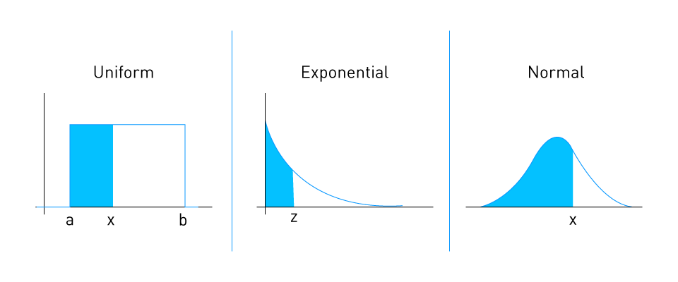

Random Sampling: Monte Carlo simulations treat system parameters as random variables, with each parameter having a specified probability distribution (normal, uniform, or exponential). A huge number of random samples are taken from these distributions, and the system is simulated for each set of random inputs.
Figure 10: Probability distribution functions
Statistical Analysis of Results: A distribution of system outputs is obtained by statistically analyzing the simulation's results after thousands or even millions of iterations. The probability that the system will fulfill its performance requirements or fail because of unfavorable parameter combinations is one of the outcomes that engineers can then evaluate.
