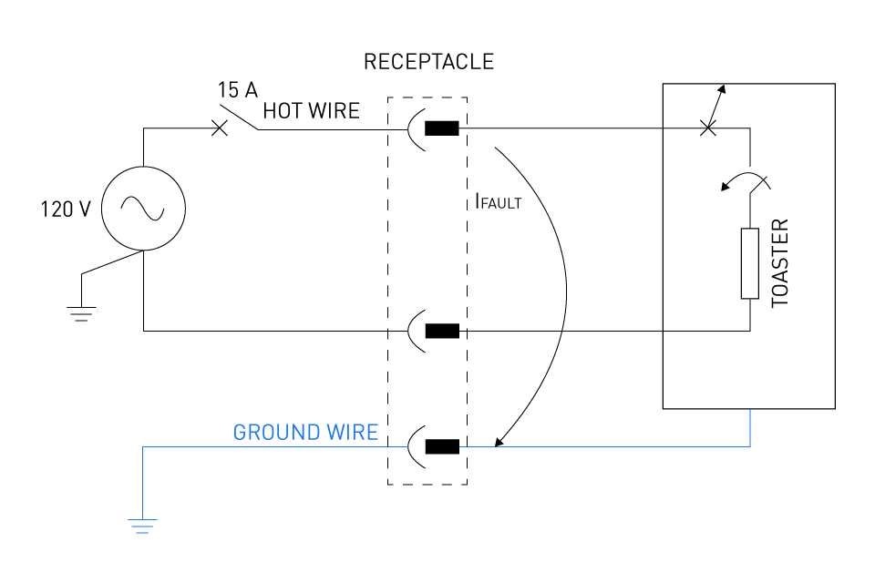

Ground Fault Protection and Insulation Monitoring
Ground faults pose serious safety risks in power electronics because they happen when a live conductor comes into touch with grounded surfaces. To avoid electric shock or equipment damage, control systems are in charge of identifying ground faults and initiating corrective actions. Ground fault protection requirements are outlined in standards such as IEC 61558 (safety of power transformers) and IEC 60364 (low-voltage electrical installations).
Figure 3: Ground fault
Ground fault protection control strategies include the following:

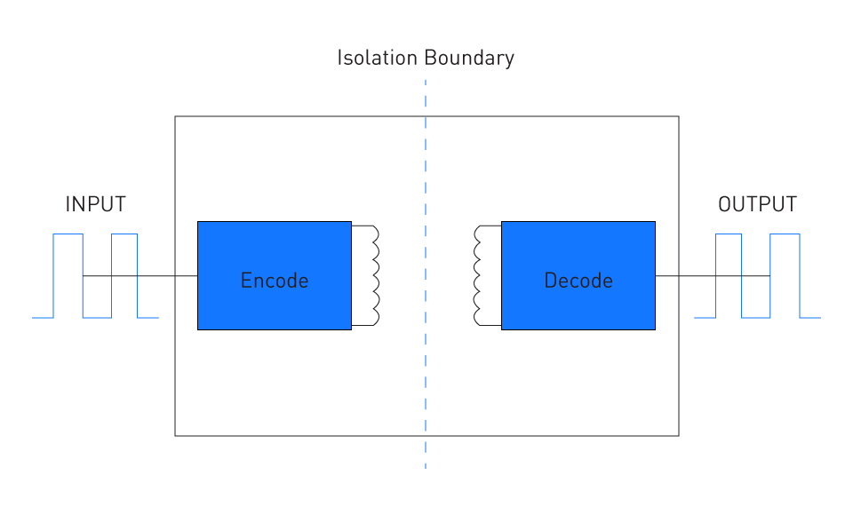

Control of Isolation Barriers
Power electronic devices frequently operate at high voltages, and it is crucial to maintain electrical isolation between circuit sections to avoid hazardous voltage transfer. For example, IEC 62109 (safety of power converters for use in photovoltaic power systems) specifies isolation standards to ensure safety in high-voltage applications.
Figure 4: Example of galvanic (inductive) isolation between circuit sections

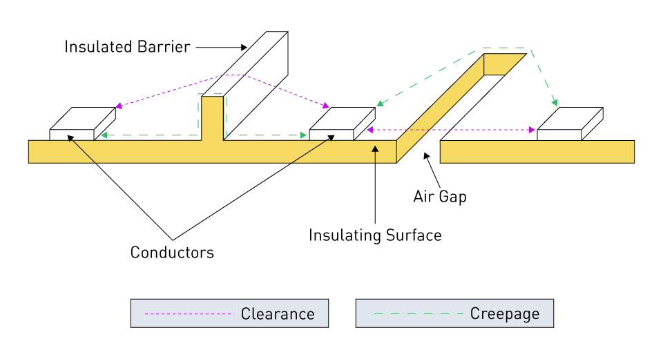

Insulation and Creepage Distances: In power electronics, insulation is an essential safety feature that guards against electric shocks and short circuits. Guidelines for clearance (the shortest distance through air) and creepage (the shortest distance along a surface between two conductive parts) are provided by standards such as IEC 60950 and IEC 62368, which ensure sufficient insulation is maintained to prevent dielectric breakdown under high-voltage conditions.
Figure 5: Creepage and clearance
