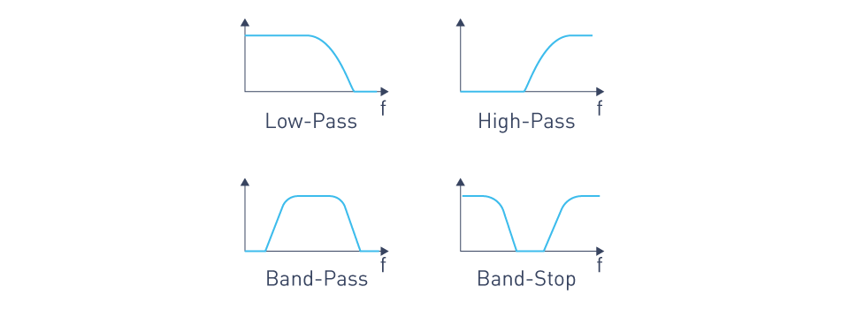

Filtering and Decoupling: In power circuits, filtering is crucial for lowering radiated and conducted noise. Usually composed of capacitors and inductors, input and output filters are used to reduce high-frequency noise and make sure the circuit complies with EMC regulations.
Figure 1: Types of filters
Decoupling capacitors, when placed close to power supply pins, help to decrease voltage fluctuations and noise on the power rails, hence enhancing circuit stability and performance. The specific noise characteristics of the circuit and the necessary attenuation levels should guide the designers' selection of filter components.

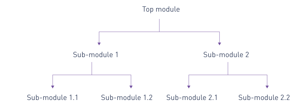

Top-Down Design Approach: The top-down design technique is a systematic methodology that starts with a high-level definition of system requirements and gradually refines the design into detailed subsystems and components. This approach lowers the possibility of integration issues later in the design process by ensuring that the overall system architecture is clearly specified before focusing on individual components. Engineers can make well-informed decisions regarding trade-offs between complexity, cost, and performance at each stage of the design process by beginning with the end goal in mind.
Figure 2: Top-down approach

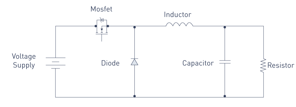

Prioritizing Critical Paths: Critical paths in power converter design, such as those carrying high current or high-frequency signals, should be prioritized in component placement. To reduce parasite effects and enhance efficiency, these paths should be as short and direct as possible. For instance, in order to minimize switching noise and increase efficiency, the MOSFET, inductor, and output capacitor should be placed as close together as possible in a buck converter.
Figure 4: Buck converter circuit

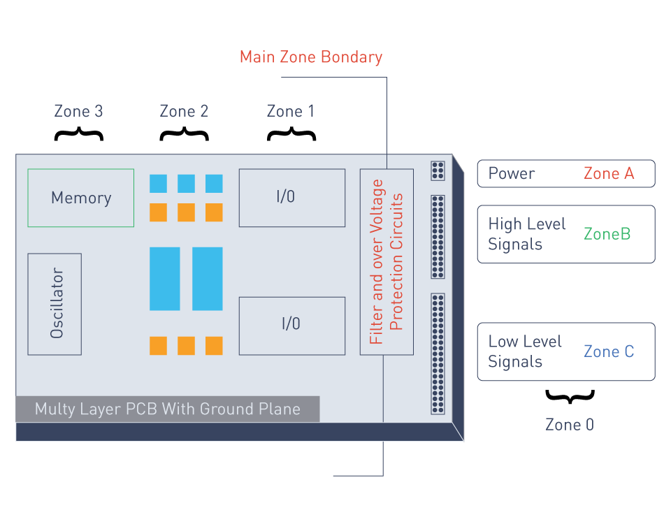

Zoning and Partitioning: The process of zoning entails dividing the PCB into several sections according to its functions, such as digital, analog, and power zones. Engineers can enhance overall circuit performance and minimize interference between different signal types by grouping similar components together. For instance, it is less likely that digital noise can impact delicate analog signals when digital components, like memory chips and microcontrollers, are kept separate from power components. Additionally, during the development process, testing and troubleshooting are made easier by dividing the PCB into zones.
Figure 5: PCB zoning

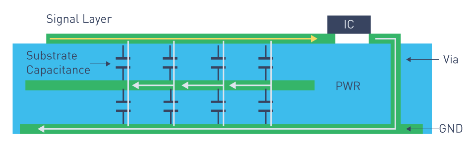

Optimizing Power and Ground Planes: Ground and power planes are essential for reducing voltage drops and offering low-impedance paths for current flow. For steady functioning and noise reduction, a continuous, unbroken ground plane is necessary. To minimize electromagnetic coupling between layers and establish a low-inductance path, the power plane should be placed directly next to the ground plane. It is also crucial to keep high-current traces as close to the power and ground planes as possible to minimize loop area, which aids in reducing radiated EMI.
Figure 6: Power and ground planes in a PCB

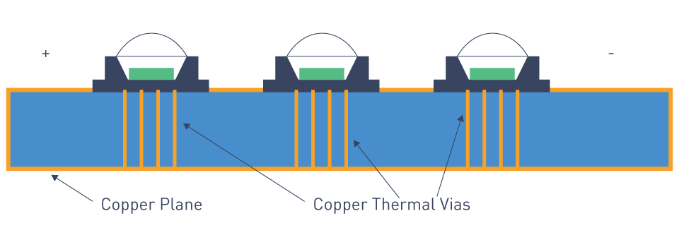

Thermal Via Arrays: In power electronics, managing heat is essential to maintaining the circuit's reliability and long lifespan. Thermal vias, which are vertical connections that transfer heat from the PCB's top layers to its inner or bottom layers, are an effective technique for improving heat dissipation. Arrays of thermal vias are commonly placed beneath heat-producing components, such as voltage regulators or power transistors, to efficiently transfer heat from the component to the PCB, where it can be dissipated over a larger area.
Figure 7: Thermal via arrays
Copper Pour and Heat Sinks: To disperse heat from hot components and lower the overall thermal resistance, copper pours, or large areas of copper on the PCB, can be utilized. To take advantage of the entire thermal capacity of the PCB, these copper areas ought to be connected to the ground or power planes. For extra cooling, heat sinks can also be installed directly on components or on the PCB. Heat sinks and other cooling mechanisms should be given enough room when designing the PCB layout to avoid interfering with other components or traces.

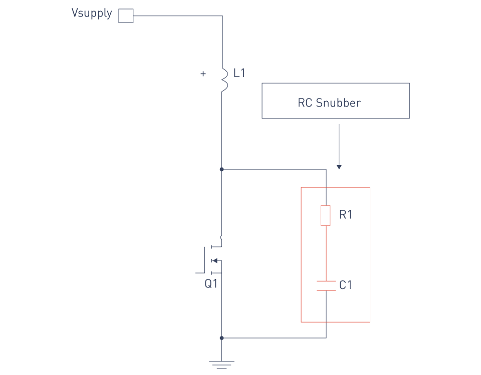

Snubber Circuits and Damping Resistors: In power electronics, Snubber circuits are frequently used to mitigate voltage spikes brought on by inductive load switching. In order to absorb the energy of the spike and prevent it from radiating as EMI, these circuits usually include a resistor and capacitor placed across a switching device, such as a MOSFET or relay. In signal lines, damping resistors can also be employed to minimize reflections and ringing, which are common causes of high-frequency electromagnetic interference (EMI). These components must be placed and designed precisely to reduce EMI and guarantee steady operation.
Figure 8: Snubber circuit
