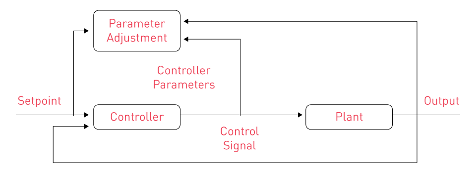

Adaptive control is a dynamic approach to control system design in which parameters are adjusted in real-time to accommodate changes in the system or the environment in which it functions. Adaptive control systems are made to continuously alter their behavior in response to changing conditions, uncertainties, or disturbances that were not specifically taken into consideration during the design phase. This is in contrast to traditional control systems, where the controller's parameters are fixed and tuned based on a predefined model.
Figure 1: Block diagram of adaptive control system
Key Concepts in Adaptive Control
Adaptation Mechanism: An adaptive control system's primary characteristic is its capacity for self-adjusting parameters. Usually, an adaptation mechanism that monitors the system's performance and modifies the controller parameters as required manages this. Adaptive control systems can be conveniently thought of as having two loops: a parameter adjustment loop and a normal feedback loop that involves the process and the controller. As the system or environment changes, adaptation enables the controller to maintain or enhance performance.
Modeling and Estimation: Adaptive control often relies on estimating system parameters or states in real time. Adaptive controllers employ real-time data to estimate important parameters because the precise model of the system may not be fully known or may vary over time. The control laws are then dynamically modified using these estimates. This procedure, sometimes referred to as parameter adaptation or estimation, is essential to the adaptive control system's effective operation. Regression models and least squares are two estimation techniques.
Adaptation Laws: Specific adaptation laws regulate the adaptation process in adaptive control systems, dictating how the controller parameters ought to be modified in response to the system's observed performance. These laws, which guarantee that the system stays stable and converges to the desired performance, are generated using a variety of techniques, including gradient descent methods and Lyapunov stability theory.
Stability and Convergence: Maintaining the system's stability while it adjusts to changing conditions is one of the primary challenges in adaptive control. Adaptive controllers that ensure system stability during adaptation are frequently designed using stability theory, especially Lyapunov's direct method. Furthermore, the adaptive algorithm's convergence features are crucial to guaranteeing that the controller parameters settle to their ideal values and that system performance gradually improves.

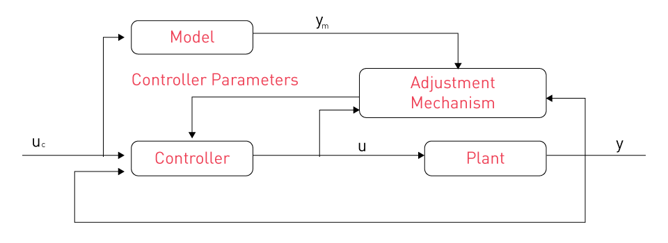

Model Reference Adaptive Control (MRAC)
Model Reference Adaptive Control (MRAC) is a popular direct adaptive control method where a reference model defines the system's desired behavior. To ensure that the system's output closely resembles the reference model's output, the controller is made to dynamically modify its parameters. Under nominal conditions, the reference model represents the system's ideal response.
The discrepancy (error) between the reference model output and the actual system output drives the adaptation process in MRAC. Over time, the controller's parameters are changed to reduce this error. The following equation provides the model error with reference to Figure X:
$$ e = y - y_m $$The parameter adjustments are governed by adaptation laws, which are usually taken from stability theories such as Lyapunov's method. This keeps the system stable while enhancing its performance.
Figure 2: Block diagram of model reference adaptive control system
MRAC is especially useful in power electronics applications like motor drives and power converters, where system parameters like load or supply voltage can vary significantly. For example, in a motor drive system, an MRAC controller can adapt to changes in load torque, ensuring optimal performance without the need for manual retuning.
Advantages:
- Guarantees that the system's output closely resembles the desired performance.
- Resilient to changes in the dynamics of the system.
- Suitable for systems with clearly specified reference models.
Challenges:
- Needs a well-defined and precise reference model.
- Complexity in developing adaptation laws that assure stability.

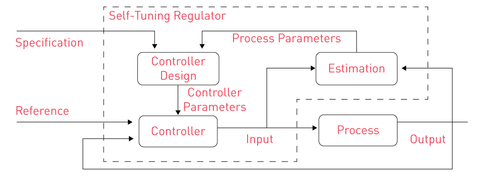

Self-Tuning Regulators (STRs) are indirect adaptive controllers that alter their settings depending on real-time system dynamics estimation. Unlike MRAC, which relies on the reference model to determine adaptation, STR systems directly detect and change system model parameters. These factors are then used to change the control law, resulting in optimal system performance.
Figure 3: Block diagram of self-tuning regulator
In STR, the controller begins with an initial set of parameters based on the system's nominal model. As the system runs, an online identification procedure estimates the current system parameters, such as time constants, gains, and delays. The control law is then updated depending on the estimated parameters, essentially tweaking the controller in real-time to respond to changing conditions.
STR is commonly employed in applications where system parameters are variable or difficult to model precisely. For example, in a DC/DC converter where the load varies unpredictably, an STR can modify the control parameters to maintain a constant output voltage.
Advantages:
- Can work with systems that have uncertain or time-varying parameters.
- Flexibility in adjusting to a variety of operating conditions.
- No predefined reference model is required.
Challenges:
- Real-time parameter estimation can be computationally complex.
- Careful design is required to assure the control system's convergence and stability.

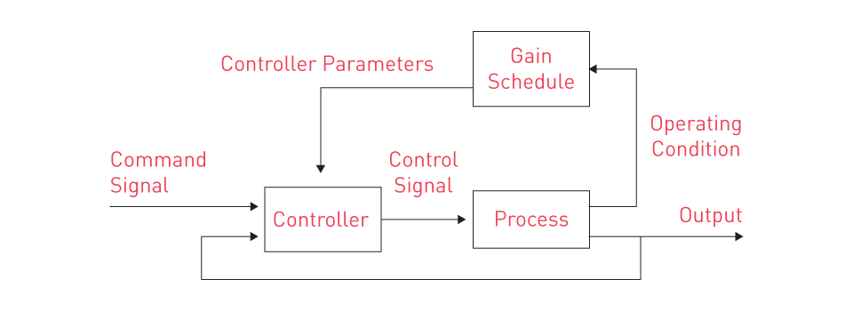

Gain Scheduling is a practical technique for adaptive control in which controller parameters are modified in response to predetermined operating conditions or schedules. Instead of continuous adaptation, the system alternates between various sets of controller gains based on the current operating point.
Figure 4: Block diagram of control system with gain scheduling
A gain scheduling system divides its operating range into many areas, each with its own set of controller parameters. When the system's operating conditions change (for example, speed, load, or temperature), the controller selects the appropriate set of parameters from the schedule. This method enables a piecewise-linear approximation of the control law, resulting in adaptability without the complexity of continuous parameter modification. Gain scheduling can be accomplished as either a table lookup or a function.
Gain scheduling is widely utilized in aerospace applications, such as managing aircraft flight dynamics, where system dynamics vary dramatically between flight conditions. In power electronics, it can be utilized in applications such as variable speed motor drives, where the control strategy must change depending on the motor's speed and load.
Advantages:
- Implementation is simpler than continuous adaptive control.
- Effective for systems with clearly defined regions for operation.
- Reduces computing load by avoiding continuous adaptation.
Challenges:
- Requires precise understanding of the system's operational conditions and transitions between them.
- Performance degradation may occur near the boundaries between scheduled gains.

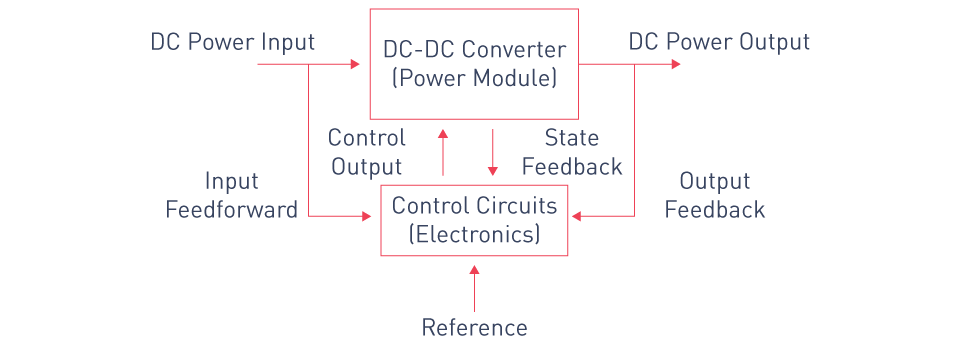

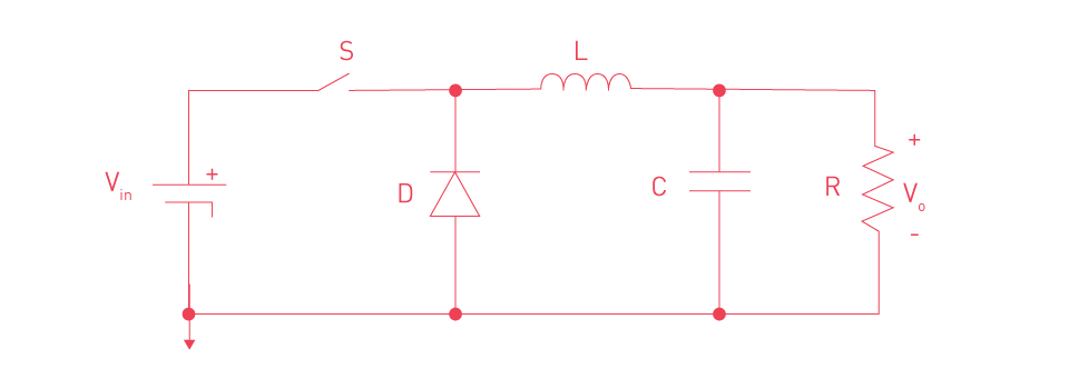

DC/DC converters are essential parts of power electronics and are utilized in a wide range of applications, from portable electronics to renewable energy systems. A DC/DC converter's performance is significantly affected by fluctuating input voltage and changing load conditions. To manage these fluctuations and guarantee that the converter operates as efficiently as possible while maintaining a steady output, regardless of changing conditions, adaptive control techniques are very effective.
Application Example: An adaptive controller can dynamically modify the duty cycle in a buck converter, which lowers the output DC voltage, to keep the output voltage steady even when the load or input voltage varies. This is essential for applications like as battery-powered gadgets, where the input voltage may drop as the battery drains, or renewable energy systems, where the input conditions might vary significantly (e.g., solar panels under changing sunlight conditions).
Figure 5: Buck converter circuit
Figure 6: Generic controlled DC/DC converter
Benefits: DC/DC converters that employ adaptive control provide higher robustness against disturbances, lower energy losses, and increased efficiency. In order to further maximize performance, it also enables the converter to adjust to various operating modes, such as switching between continuous and discontinuous conduction modes.

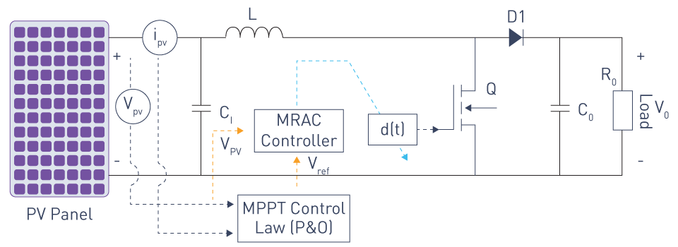

Inverters play a crucial role in transforming DC electricity from renewable energy sources, such wind turbines and solar panels, into AC power that can be sent into the electrical grid or utilized in homes and businesses. Maintaining steady and efficient inverter functioning is severely hampered by the unpredictability of renewable energy sources. Inverters can effectively respond to these issues because of adaptive control methods.
Application Example: Maximum Power Point Tracking (MPPT), which continuously modifies the operating point of the solar panels to optimize power output under fluctuating sunlight conditions, can be implemented in a grid-tied solar inverter using adaptive control. Adaptive control can also assist the inverter to compensate for variations in input power and load while keeping it in sync with the grid.
Figure 7: Adaptive MPPT controller
Benefits: In addition to improving power quality and energy conversion efficiency, adaptive control makes sure the inverter can withstand abrupt fluctuations in input power without becoming unstable. This is especially crucial for preserving grid stability and optimizing the return on investment for installations of renewable energy.
