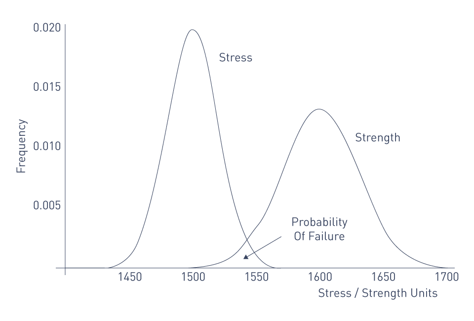

- Stress-Strength Analysis: This method compares the strength of the component (e.g., rated voltage, maximum operating temperature) with the applied stresses (e.g., voltage, current, temperature) in order to assess the reliability of the component. Because it is not practical to do this analysis for every component, it is only done for the most crucial ones. A system is more reliable when its components have a better strength-to-stress ratio since they are less likely to fail.

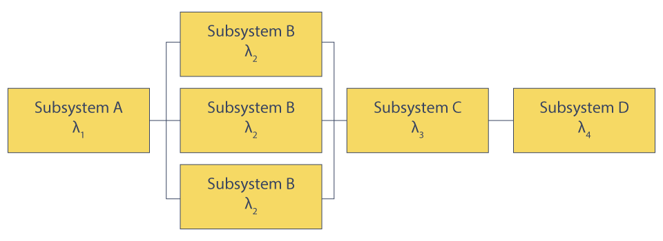

- Reliability Block Diagrams (RBDs): RBDs visually depict the configuration of system components and how their reliability contributes to overall system reliability. Based on component reliabilities, series and parallel configurations are examined to forecast the probability of system failure.
Figure 16: Sample stress-strength analysis
Figure 17: Reliability block diagram (ʎ is failure rate)

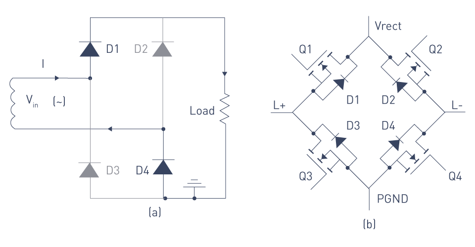

- Synchronous Rectification: Synchronous rectification substitutes traditional diodes with actively regulated MOSFETs, which greatly reduces conduction losses during the rectification stage. This approach is especially useful in low-output voltage, high-current applications, such as power supplies for consumer electronics.
- Interleaved and Multi-Phase Designs: By distributing the load current throughout parallel phases, interleaving multiple converter stages helps smooth the input and output current waveforms and lessen the strain on individual components. This method increases overall efficiency by lowering conduction losses and enhancing thermal management.
Figure 18: (a) Diode rectifier (b) Synchronous rectifier

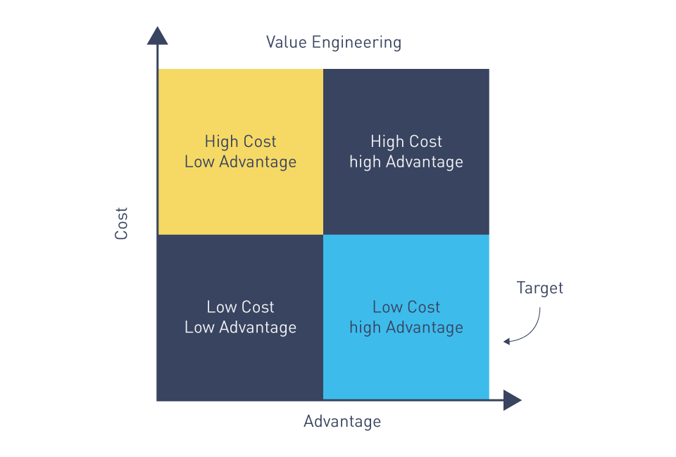

- Value Engineering: Value engineering entails dissecting every component and subsystem to find opportunities to decrease expenses without sacrificing reliability or efficiency. This might include choosing alternative materials, making circuit designs simpler, or getting rid of features that aren't necessary.
Figure 20: Value engineering

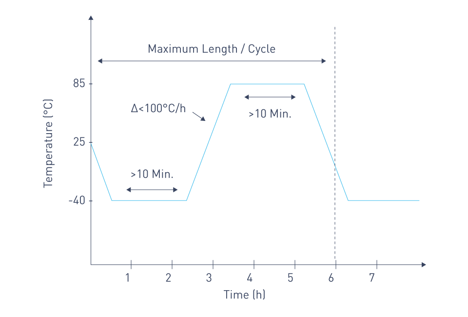

- Thermal Cycling: To simulate the thermal expansion and contraction that occurs during normal operation, components are frequently cycled between high and low temperatures. This test aids in the identification of thermal stress-related issues such as solder joint fatigue and material cracking.
- Power Cycling: Power cycling is the process of frequently turning the power on and off to mimic the electrical and thermal stress that components go through during cycles of startup and shutdown. This test is helpful in detecting component wear and thermal fatigue failures.
Figure 21: Solar panel thermal cycling

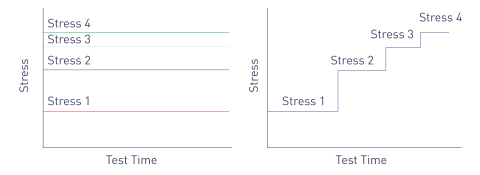

Highly Accelerated Life Testing (ALT) is a more aggressive method of testing that pushes products beyond their specified operational limitations in order to discover possible causes of failure. The goal of HALT is to identify the weakest points in the design and production processes, allowing engineers to fix these vulnerabilities before the product goes to market.
HALT Process:
- Step Stress Testing: Stress levels (such vibration, temperature, or electrical load) are progressively raised in steps during HALT until the product fails. Engineers can determine the precise stress level that leads to failure by holding each step long enough to trigger failure if the product is vulnerable.
- Destructive and Non-Destructive Testing: Both destructive and non-destructive testing methods may be used in HALT. Non-destructive tests find possible failure areas without causing irreversible harm, whereas destructive tests drive the product until it fails.
Figure 22: Constant stress vs. step stress testing
