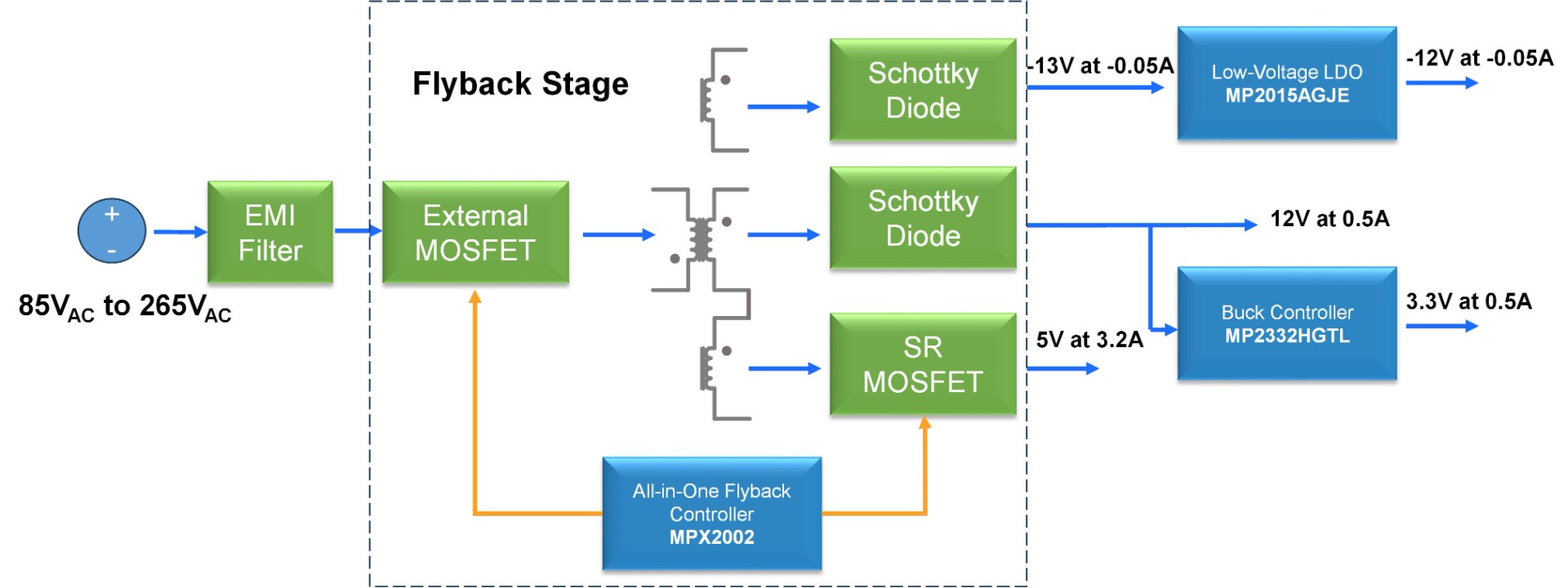

Figure 1 shows the block diagram of the complete four-output power supply.
Figure 1: Complete Four-Output Flyback Converter Block Diagram
The architecture is centered on a main flyback converter controlled by the MPX2002. This primary converter directly generates two positive rails (+5V and +12V) and a negative rail for the low-dropout (LDO) regulators. The final +3.3V output is derived using a high-efficiency post-regulator. The specific roles and interactions are described below.
  • Main Regulated Output (+5V): This is the primary regulated rail. The solution is based on the MPX2002, an all-in-one flyback controller with integrated 650V primary control circuitry and a secondary 150V synchronous rectification (SR) driver. Its key advantages are its integrated capacitive isolation, which replaces the traditional optocoupler, and quasi-resonant (QR) operation, which minimizes turn-on losses in the primary MOSFET.
  • Stacked Output (+12V): This output is generated using the stacked topology, with its winding return path connected to the +5V rail. Its regulation is achieved through the combination of passive tracking and active weighted feedback.
  • Post-Regulated Output (+3.3V): A high-efficiency synchronous buck converter steps down the regulated +12V rail to +3.3V. This approach is ideal for powering digital logic that requires a well-regulated voltage at a potentially high or dynamic current. The solution used in this example is the MP2332H, a fully integrated, high-frequency, synchronous buck converter.
  • Low-Current Auxiliary Output (-12V): A dedicated winding from the flyback transformer feeds a simple LDO to generate the -12V rail. This is a highly cost-effective solution to provide a stable negative voltage for low-power analog circuitry, such as operational amplifiers, where efficiency is not the primary concern. The suggested solution is based on the MP2015A, an LDO that can withstand a wide 2.5V to 24V input range.

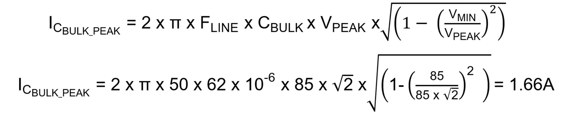

ICBULK_PEAK is the transient peak that occurs at the moment the AC line voltage equals the minimum DC bus voltage. It can be calculated with Equation (3):
Equation 3: Bulk capacitor peak current calculation (3)
The total worst-case input peak current is the sum of these two components, providing a conservative design margin estimated with Equation (4):
IIN_PEAK = ICBULK_PEAK + ILOAD_MAX = ICBULK_PEAK + POUTη x VMIN = 1.66 + 250.88 x 85 = 1.99A(4)

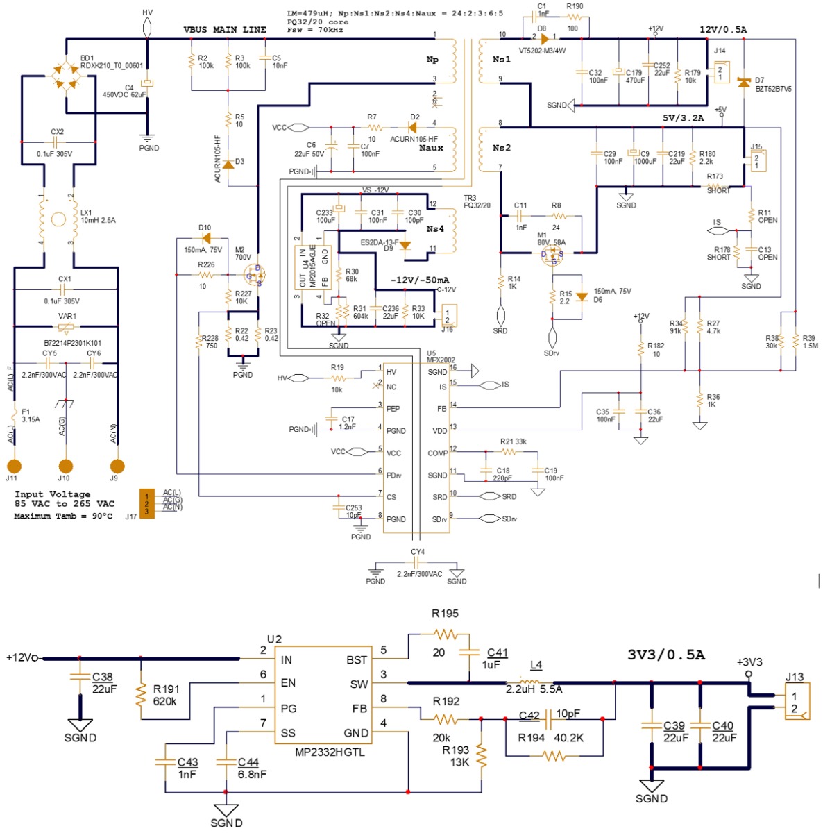

Figure 2 shows the final schematics once the calculations are made for the multi-output flyback converter design.
Figure 2: Complete Multi-Output Flyback Converter Schematic
Figure 2 shows the input filter and the multi-output flyback separately. The top image shows the two primary and three secondary windings, two of which are the main outputs (+5V and +12V) with a stacked output structure and weighted feedback. The bottom image shows the DC/DC buck converter, which provides a stable +3.3V. This 3.3V is optimal for powering digital circuitry because the 1.2MHz fSW allows for an almost negligible ripple.

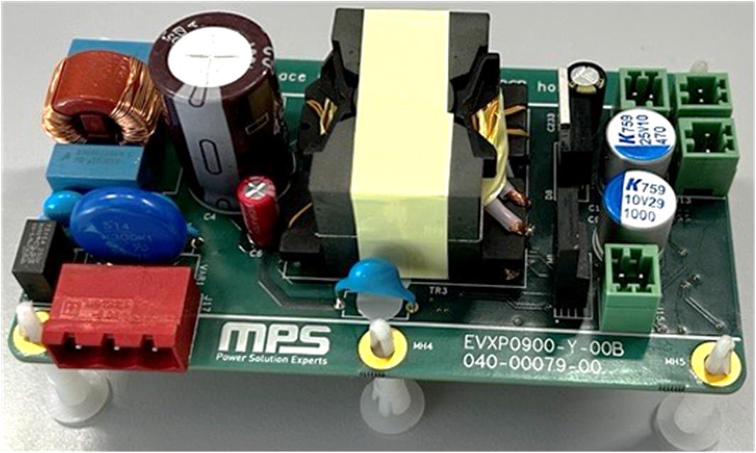

Figure 3 shows the final solution that considers the schematic above as well as the PCB layout.
Figure 3: EVB Based on the Complete Multi-Output Flyback Converter

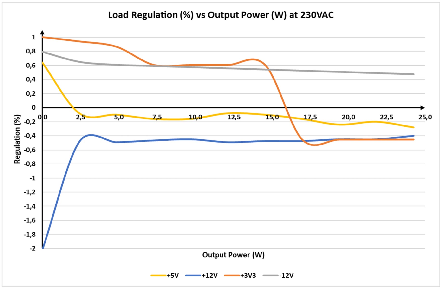

Figure 4 shows the regulation results for each output in accordance with the total design that was calculated and presented in this article.
Figure 4: Regulation Results for Each Output at 230V<sub>AC</sub>
Figure 4: Regulation Results for Each Output at 230VAC
