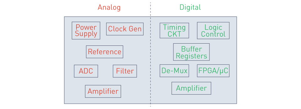

Figure 23: Physical separation on a mixed-signal PCB

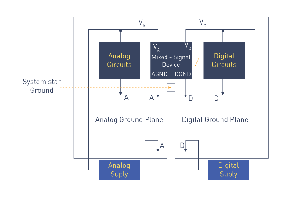

- Separate Ground Planes: Separate ground planes for the analog and digital sections help to isolate noise sources. Sensitive analog circuits should use the analog ground plane, and digital circuits should use the digital ground plane. To avoid ground loops while retaining isolation, these planes can be connected at a single point, usually near the power supply.

Figure 24: Separate analog and digital ground planes

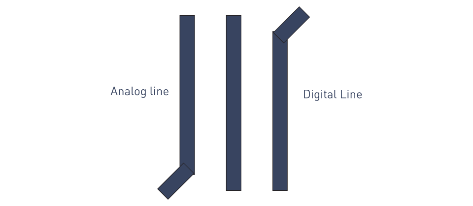

Figure 25: A ground line for isolation between mixed signal lines

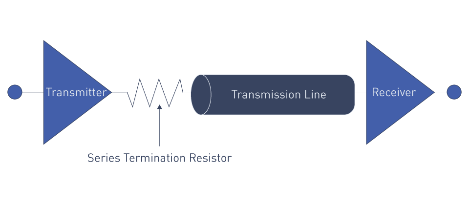

- Series Termination: A resistor is placed at the signal trace's source end. This technique minimizes reflections without adding excessive load on the driver by lowering the signal's amplitude and slowing its rise time.

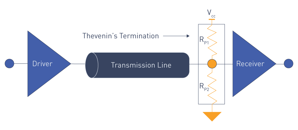

- Thevenin Termination: To match the impedance and stabilize the signal at a specific voltage level, pull-up and pull-down resistors are used in combination. Logic circuits and bidirectional buses frequently employ this technique.
Figure 26: Series trace termination
Figure 27: Thevenin trace termination

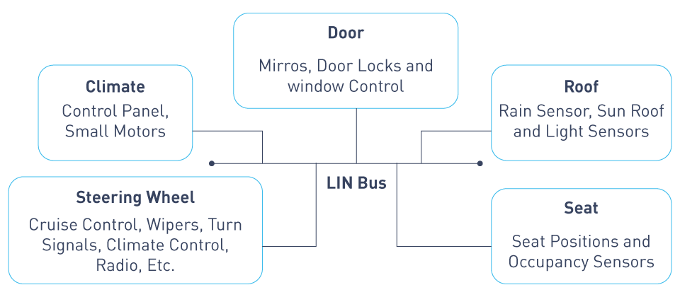

Figure 28: Vehicle LIN bus
