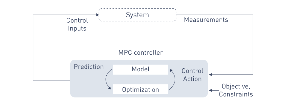

Model Predictive Control (MPC): Model Predictive Control (MPC) is the most widely used predictive control technique in power electronics. It consists of:
- A model for the procedure
- A cost function is defined across the prediction horizon
- An optimization algorithm for minimizing the cost function
At each control step, MPC solves the optimization problem by minimizing the cost function, which usually contains terms for error tracking, control effort, and other system-specific requirements. The optimization is constrained by the system's physical limitations, such as voltage, current, and switching limits in power electronic devices.
An MPC controller performs the following tasks during operation:
- Forecasts how controlled variables will behave in potential switching states.
- It assesses the cost function for each prediction.
- Selects the switching state with the lowest cost function.
Figure 8: MPC concept

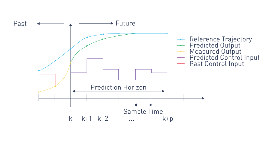

Prediction Horizon: The prediction horizon, or the period of time over which future system behavior is anticipated, is a critical component of MPC. One crucial design parameter that strikes a balance between control performance and computing complexity is the prediction horizon's length. Although it uses more computing power, a broader prediction horizon typically yields more accurate predictions and better control performance.
Figure 9: MPC scheme
Optimization Problem: MPC finds the best control actions at each sample instant by solving an optimization problem. The cost function and limitations are quadratic functions of the control inputs, and this problem is commonly expressed as a quadratic programming problem. The answer to this problem specifies the control measures that should be taken to minimize future deviations from the desired reference while remaining within system restrictions.
Receding Horizon Strategy: With MPC, just the first control action of the optimized sequence is implemented; the procedure is then repeated at the subsequent time step using updated state data. This is known as the receding horizon strategy. This approach guarantees that the control actions stay optimal as the system develops by enabling the controller to continuously adjust to changes in the system dynamics or external disturbances.

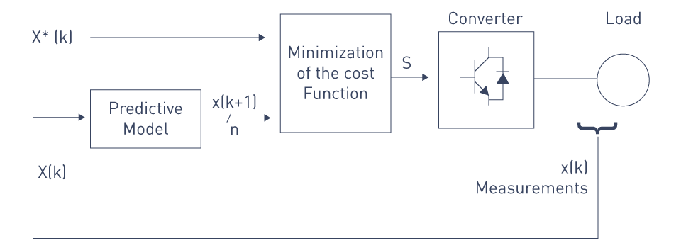

In power electronics, predictive control has several uses, especially in systems where traditional control methods are severely challenged by fast dynamics, nonlinearity, and constraints. Among the important uses are:
Inverter Control: Inverter control frequently utilizes predictive control, especially in applications where rapid response times and high-quality output waveforms are crucial. For instance, MPC can maximize efficiency and ensure grid code compliance in grid-tied inverters by optimizing the switching sequence to minimize harmonic distortion. MPC's predictive nature enables it to manage the switching limitations and nonlinearity that come with inverter operation.
Active Rectifiers: Predictive control also performs exceptionally well with active rectifiers. These devices, which are frequently used in power factor correction and regenerative braking systems, convert AC to DC with a regulated output. MPC can optimize the rectifier's switching sequence to reduce harmonic distortion, increase power factor, and minimize power losses while preserving stable performance under a range of input and load conditions.
DC/DC Converters: Predictive control can be used in DC/DC converters to keep the output voltage or current constant even when the input voltage or load varies. To reduce voltage ripple and enhance transient response, for example, MPC can forecast the future output voltage of a buck converter and modify the duty cycle accordingly.
Figure 10: MPC scheme for power converters
