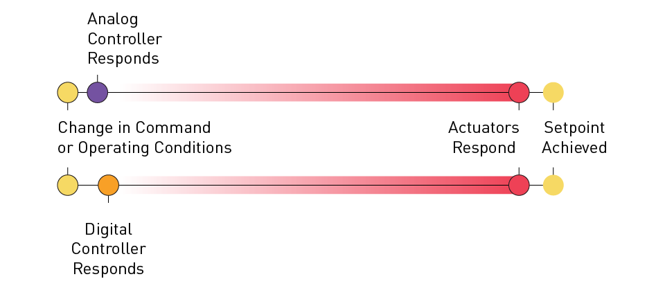

In control systems, response time is a crucial parameter that establishes how fast a system responds to input or setpoint changes. It has a direct effect on the system's capacity to sustain the stability and performance that are needed, particularly in dynamic conditions. The notion of response time, the factors influencing it, and its importance in analog and digital control systems are explored in this section.
Definition of Response Time
In control systems, response time is the amount of time it takes for the system to react to a change in input and reach at a new setpoint or equilibrium. It is crucial to realize that the response time of the system is dependent upon the response times of each component of the control system. When compared to the response times of other components of the control system, the controller's (analog or digital) response time can be negligible.
Figure 1: Digital vs. Analog Controller Response Times

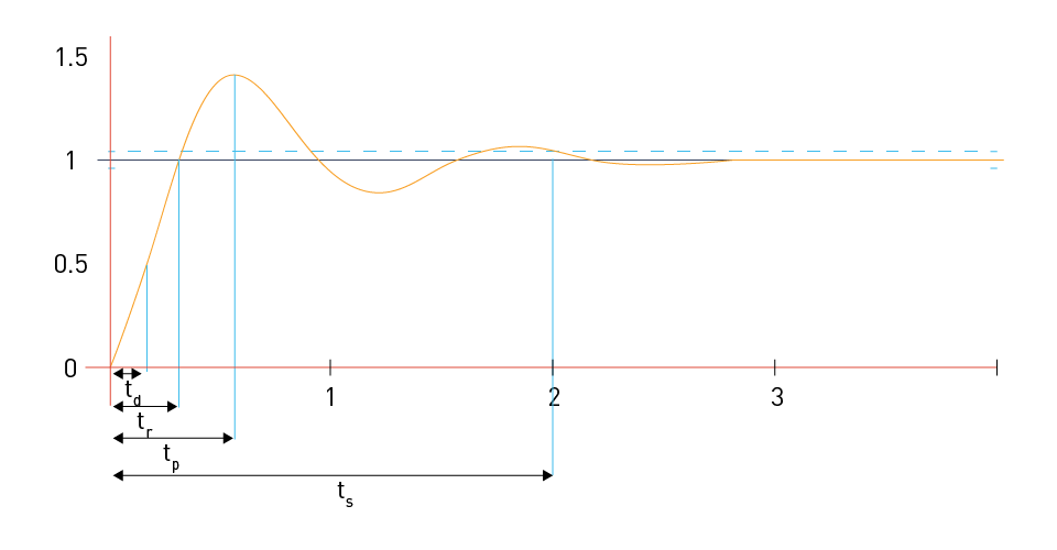

There are multiple components that make up the system response time:
Delay Time: The amount of time needed to get to 50% of the final value.
Rise Time: The amount of time needed for the system output to increase from a low value (typically 10% of the final value) to a high value (typically 90% of the final value).
Peak Time: The amount of time needed to get to the highest overshoot (or peak) value.
Settling Time: The time required for the system output to remain within a specific percentage (e.g., 2% or 5%) of the final value following an input change.
Figure 2: Response time components

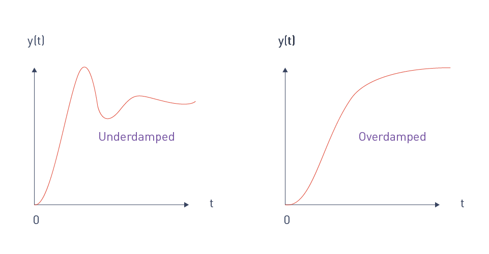

System Dynamics:
Natural Frequency: The system has an inherent oscillatory behavior. Systems with higher natural frequencies typically have faster response times.
Damping Ratio: A measure of how a system's oscillations decrease following a disruption. Overdamped systems respond slower, whereas underdamped systems may oscillate before settling.
Figure 3: Underdamped vs. overdamped systems

Response Time in Analog vs. Digital Control Systems
Analog Control Systems:
Continuous Processing: Continuous signal processing in analog systems enables almost immediate responses to input changes.
Speed of Components: The response time is determined by the speed of analog components like capacitors and op-amps. High-speed response times are possible with high-speed analog components.
Digital Control Systems:
Discrete Processing: The sampling rate and processing speed determine the response time of digital systems, which sample inputs at discrete intervals.
Algorithm Execution: The overall response time is impacted by the amount of time needed to run control algorithms on a microcontroller or DSP.

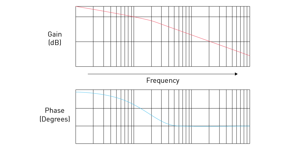

Bode Plots
Bode plots are graphical representations of a system's frequency response, made up of two plots: magnitude (gain) vs frequency and phase versus frequency.
Magnitude Plot: Demonstrates how the amplitude of the output signal changes with frequency.
- Key Features: Plot slope (a steeper slope indicates a faster change in gain with frequency), bandwidth (the range of frequencies where the system effectively passes signals with minimal attenuation), and gain crossover frequency (the frequency at which the magnitude of the system's transfer function crosses the 0 dB line, meaning the gain is 1 or unity).
Phase Plot: Represents the system's phase shift as a function of frequency.
- Key Features: Phase margin is the difference between the phase at the gain crossover frequency and -180 degrees, and phase crossover frequency is the frequency at which the phase shift reaches -180 degrees.
Figure 4: Bode plot

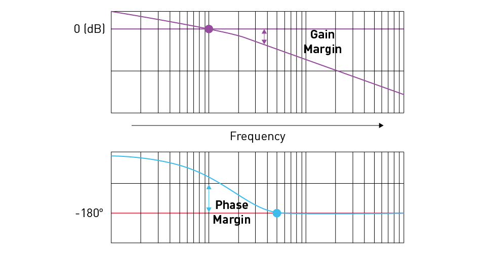

Stability Analysis:
- Gain Margin: The amount of gain increments necessary to make the system unstable. It is the dB difference between the gain at the phase crossover frequency and 0 dB.
- Phase Margin: The extra lag in phase needed to push the system over the edge of instability. It is the degree difference between the phase at the gain crossover frequency and -180 degrees.
- Criterion: If the gain and phase margins are both positive, the system is stable. This is due to the fact that gain and phase margins indicate the distance from unstable points, and larger margins indicate increased stability.
Figure 5: Phase and gain margins
