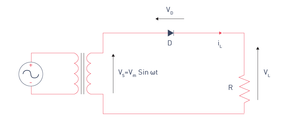

Half-Wave Rectifier:
Topology: The load connected in series with a single diode.
Operation: Conducts during the AC input's positive half-cycle, preventing the negative half-cycle.
Advantages: Easy and inexpensive.
Disadvantages: High output ripple and low efficiency.
Applications: Simple, low-power uses where efficiency and ripple are not important considerations.
Figure 11: Single-phase half-wave diode rectifier

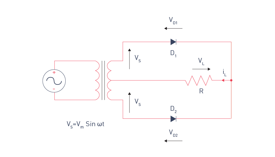

Full-Wave Rectifier:
Topology: Use a bridge configuration with four diodes or a center-tapped transformer with two diodes.
Operation: Converts the AC input's positive and negative half-cycles to DC.
Advantages: Reduced ripple and increased efficiency in comparison to half-wave rectifiers.
Disadvantages: Costlier and more complicated than half-wave rectifiers.
Applications: Extensively utilized in electronic device power supplies.
Figure 12: Full-wave rectifier with center-tapped transformer

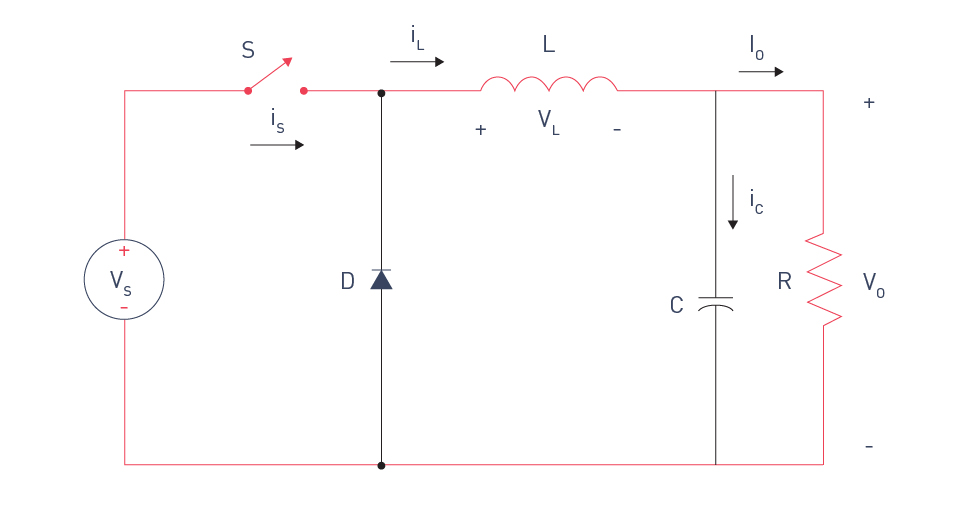

Buck Converter:
Topology: Consists of a capacitor, diode, inductor, and switch (usually a transistor).
Operation: Reduces the output voltage by stepping down the input voltage.
Advantages: Simple design, high efficiency.
Disadvantages: Only reduces the voltage.
Applications: Battery chargers and microprocessor power supplies.
Figure 14: Buck converter

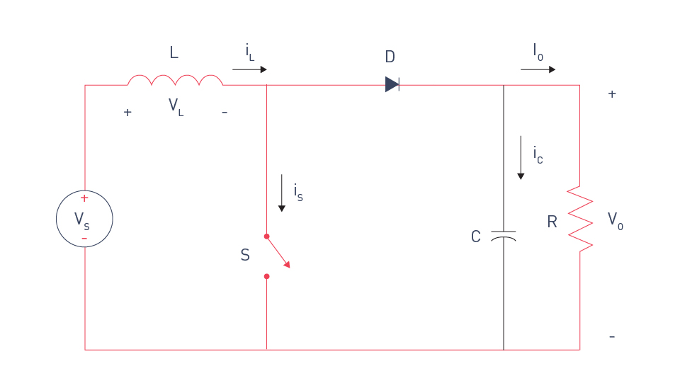

Boost Converter:
Topology: Consists of a capacitor, an inductor, a diode, and a switch.
Operation: Increases the output voltage by stepping up the input voltage.
Disadvantages: Only increases the voltage.
Applications: Applications like portable devices require a higher voltage from a lower voltage source.
Figure 15: Boost converter

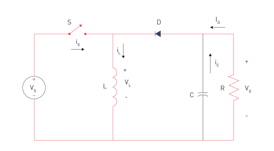

Buck-Boost Converter:
Topology: Blends features of boost and buck converters.
Operation: The input voltage can be stepped up or down.
Advantages: Versatile voltage conversion.
Disadvantages: Control is more complex.
Applications: Devices that run on batteries and require a steady output regardless of changes in the input voltage.
Figure 16: Buck-boost converter

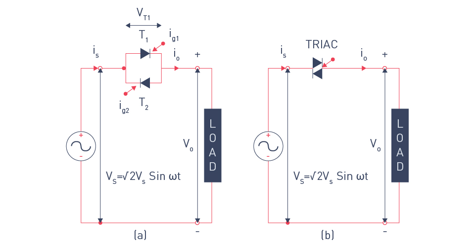

AC Voltage Controllers:
Topology: Operates by connecting thyristors or triacs in series with the load.
Operation: Adjusts the switches' firing angle to regulate the output voltage.
Advantages: Easy and efficient way to regulate voltage.
Disadvantages: Adds harmonics, limited to voltage control.
Applications: AC motor speed control, heater control, and light dimming.
Figure 18: Single-phase full-wave voltage controller (a) with SCRs (b) with TRIAC
