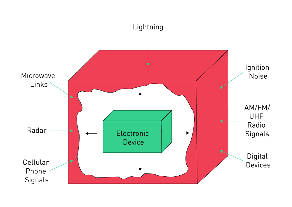

Electromagnetic compatibility (EMC) is an important factor in the design and operation of power electronic systems. The ability of electrical and electronic systems to operate properly in their electromagnetic environment without causing electromagnetic disturbances that disrupt the operation of other systems is known as electromagnetic compatibility (EMC). Achieving EMC is crucial in power electronics, where high voltages, switching transients, and rapidly fluctuating currents are frequent. This ensures that devices function reliably and safely without causing or experiencing interference from external sources.
Importance of EMC in Power Electronics

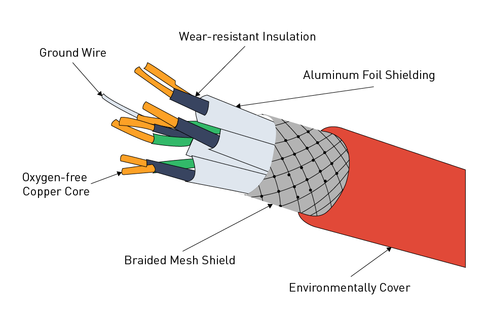

Cable Shielding: Signal and power cables should be shielded in addition to the device itself, particularly in high-frequency applications. Shielded cables with grounded exterior conductors limit the amount of noise that can couple to the cable and radiate into the environment. For long cable runs in industrial or automotive systems, this is especially important.
Figure 8: Shielded cable

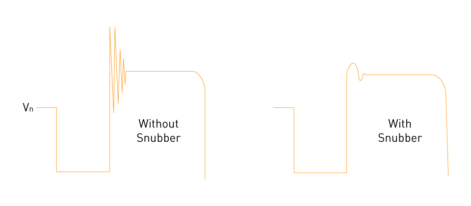

Snubber Circuits: To reduce voltage spikes across switching devices, snubber circuits are often used in motor drives and switching power supplies. A typical snubber consists of a resistor and capacitor placed across the switch to absorb high-frequency transients and limit the rate of voltage change (dv/dt).
Figure 9: Snubber circuit for transient voltage suppression

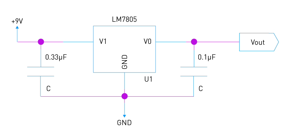

Reducing conducted and radiated emissions requires power supply decoupling, especially in digital circuits with high-speed switching. C Decoupling capacitors placed between power and ground near the ICs serve to filter out high-frequency noise and stabilize the supply voltage.
Figure 10: Linear voltage regulator with 2 decoupling capacitors
Bypass Capacitors: Placing bypass capacitors near IC power pins (usually between 0.1 µF and 10 µF) lowers high-frequency noise on the power rails. For high-frequency decoupling, low-inductance surface-mount capacitors are preferred.
Bulk Capacitors: Bulk capacitors, with larger capacitance values ranging from 10 µF to 1000 µF, are used to store energy locally and smooth out lower-frequency changes in the power supply. These capacitors aid to decrease power supply ripple, which can contribute to EMI if not properly filtered.

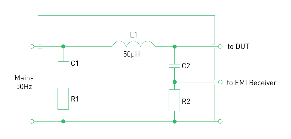

Conducted Emissions: Electromagnetic disturbances that propagate along electrical cables, including power supply lines, are referred to as conducted emissions. To test for conducted emissions, the noise generated by the device through its cables must be measured and maintained within specified limits. Limits and testing techniques for conducted emissions are defined by the CISPR 11 and CISPR 32 standards. Typically, a line impedance stabilization network (LISN) is used to measure noise at specific frequencies.
Figure 11: LISN circuit

During pre-compliance testing, a company designing a high-power DC/DC converter for industrial use encountered excessive conducted emissions. The high-frequency switching of the MOSFETs in the converter was identified as the cause of the emissions.
Identified Issue: The switching transients coupled noise onto the power lines, causing conducted emissions to exceed the limits specified by CISPR 11.
Corrective Action: To reduce high-frequency noise, an LC filter was added to the power supply's input. To further reduce dv/dt and the associated noise, the gate driver circuit was modified to slow down the switching transitions.
Result: Following the implementation of these solutions, the DC/DC converter passed emissions testing, demonstrating compliance with CISPR 11 standards.
