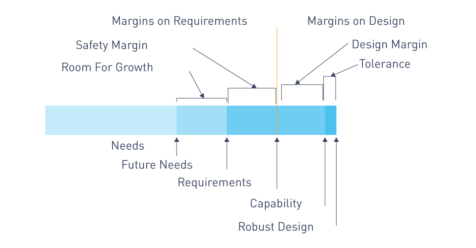

Applying Design Margin Appropriately
Balanced Design Margins: Design margins are necessary to account for component variations, operating conditions, and manufacturing tolerances. However, whereas inadequate margins lead to under-design, excessive margins can result in over-design. Applying appropriate design margins based on practical worst-case conditions is crucial. For instance, derating transistors and capacitors is necessary to guarantee reliability, but over-derating might unnecessarily increase the design's size and expense. To establish suitable design margins that guarantee performance without resulting in over-design, engineers should employ statistical analysis and reliability modeling.
Figure 9: Requirement margin vs. design margin
Simulation and Modeling: Advanced modeling and simulation tools can help maximize design margins by precisely forecasting how the system will behave in different conditions. Engineers can verify that the design functions reliably within the defined margins and prevent the tendency to include excessive safety factors by utilizing these tools. The probability of both over- and under-design is decreased by simulation results, which give assurance that the design will operate as expected in the real world.

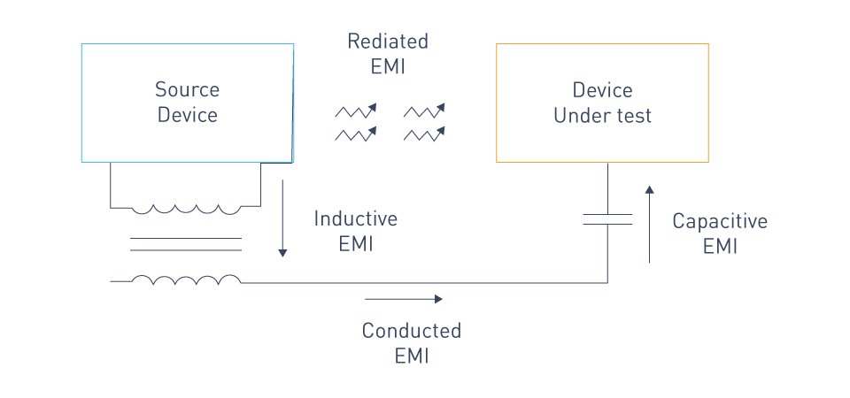

EMI Sources in Power Electronics
Switching Noise: The noise produced by the rapid switching of power transistors, such as MOSFETs and IGBTs, is a major source of EMI in power electronics. High-frequency transients and harmonics are generated as these devices switch on and off, and they can propagate throughout the circuit as conducted and radiated electromagnetic interference (EMI). In applications where high-frequency switching is common, such as motor drives and switching power supplies, this switching noise is especially problematic.
Parasitic Elements: Parasitic inductance and capacitance in the circuit layout can increase EMI by causing unwanted resonances and coupling paths for noise. For instance, parasitic capacitance between adjacent traces or layers can result in the undesired coupling of high-frequency noise into sensitive circuits, while parasitic inductance in the traces connecting power devices can generate voltage spikes and ringing.
Ground Loops: Ground loops form when there are multiple ground paths in a circuit, resulting in unwanted current loops that can pick up and emit noise. These loops can function as antennas, sending out electromagnetic interference (EMI) and creating noise in the ground plane, which may interfere with other circuit parts.
Figure 10: EMI sources
External Sources: Electronic systems can be vulnerable to external electromagnetic interference sources, such as nearby radio frequency transmitters, power lines, or other electronic devices, in addition to internally generated EMI. Through cables, connectors, or inadequately shielded enclosures, this external EMI can couple into the system and cause malfunctions or a decline in performance.
