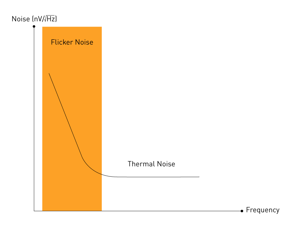

Flicker Noise (1/f Noise)
Principle: Has an inverse relationship with frequency and has an association with semiconductor devices.
Characteristics: Significant at lower frequencies.
Impact: Affects how well precision analog circuits, such as oscillators and low-frequency amplifiers, operate. At lower frequencies, flicker noise predominates, while at higher frequencies, thermal noise does.
Figure 14: Impact of flicker and thermal noise vs. frequency

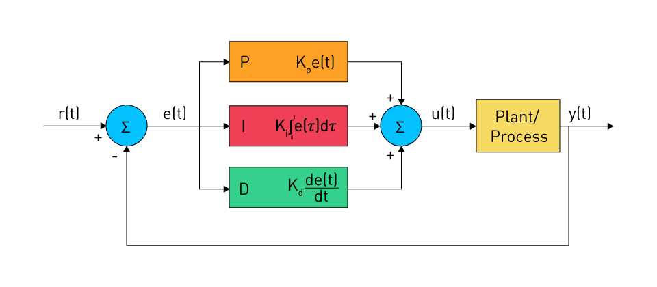

PID Controller:
- Proportional Term: amplifies the error signal. Utilize an op-amp with a feedback resistor in a non-inverting configuration.
- Integral Term: Removes errors in steady state. Utilize an op-amp integrator circuit to integrate the error signal.
- Derivative Term: Predicts future errors, minimizes overshoot, dampens oscillations, and increases stability. Use an op-amp differentiator circuit to differentiate the error signal.
Combining PID Terms: Utilizing an additional op-amp configured as a summing amplifier, add the outputs of the three op-amp stages.
Figure 15: PID controller
