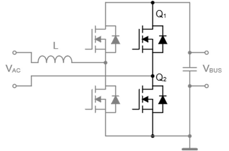

Slow Leg in a Totem-Pole Converter
The slow leg in a totem-pole converter can be implemented with diodes, but this can lead to high conduction losses; instead, it is recommended to use totem-pole transistors (Q1 and Q2) with a low resistance to improve efficiency (see Figure 1).
Figure 1: Slow Leg in a Totem-Pole Converter

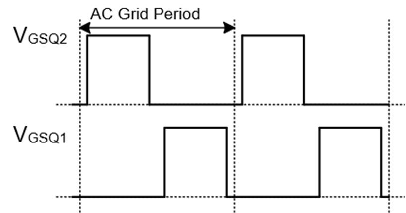

In this set-up, the current flows through the body diode and the totem-pole transistor switches on when a threshold is reached. Figure 1 shows how the same gate-source waveform for both transistors is shifted 180° (see Figure 2).
Figure 2: Gate-Source Waveforms of Both Transistors

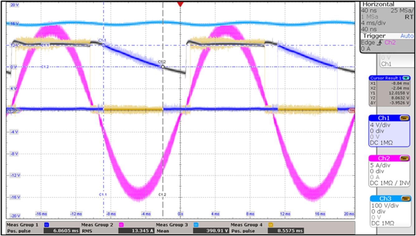

Figure 3 shows the waveforms when a high-side transistor gate is not properly driven in a 3kW totem-pole converter (50Hz grid).
Figure 3: TP Waveforms with Bad VGSQ1
Figure 3: TP Waveforms with Bad VGSQ1 (CH1: VGSQ1, CH2: IL, CH3: VBUS, CH4: VGSQ2)
Both gates should have same pulse width, but this is not the case, as the on times are 8.52 and 6.88ms. This means that Q1 current flows through the diode instead of the totem-pole transistor’s channel for 1.64ms, which increases losses.
If we take a closer look, we realize that Q1 switches off at VGSQ1 = 8V, which makes sense because this is the driver’s under-voltage lockout (UVLO) threshold. To have the same on time (tON) for both switches, we could select a driver with a lower UVLO threshold; however, this is not a good solution because the transistor will not have the gate voltage needed to operate normally. Additional analysis is required to determine the problem.

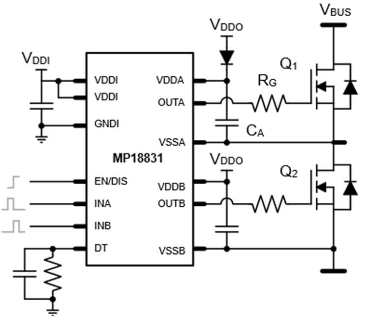

When no negative voltage is needed to turn off the transistor, the bootstrap technique is the simplest way to power the high-side gate driver in a half-bridge configuration. Figure 4a shows the half-bridge driver using the MP18831, while Figure 4b shows the half-bridge driver when Q1 turns on.
Half-Bridge Driver
a) Half-Bridge Driver
Half-Bridge Driver (Q1 Turns On)
b) Half-Bridge Driver (Q1 Turns On)
Figure 4: Half-Bridge Driver Schematic
Table 1 shows the most common behaviors for a half-bridge driver.
Table 1: Bootstrap Steps
State Q1 Q2 Comments
000VSSA floating.
101VSSA to GND > D is forward biased > CA is charged to about VDDO.
210VSSA to VBUS > D is reverse biased, blocking VBUS > CA is discharged to drive Q1.
311Not allowed (VBUS short circuit). Most half-bridge drivers have dead-time protection.

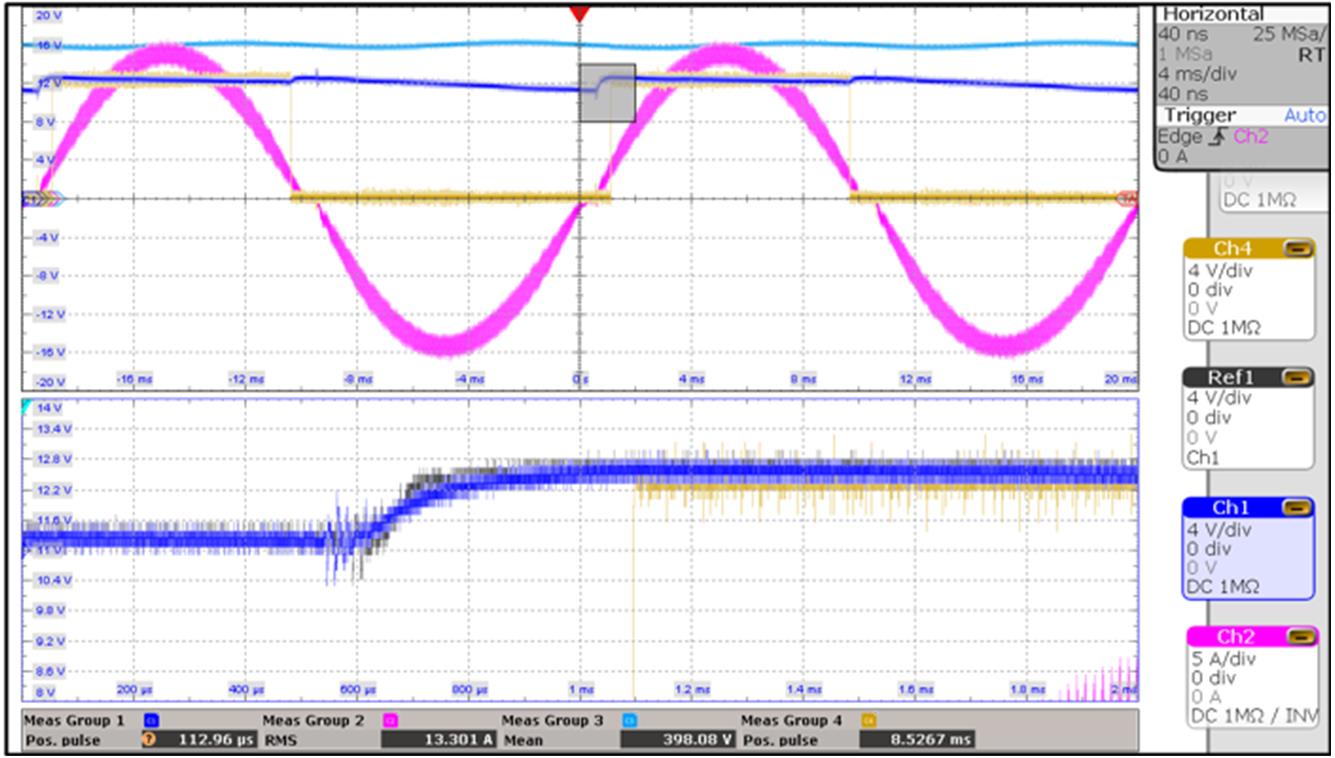

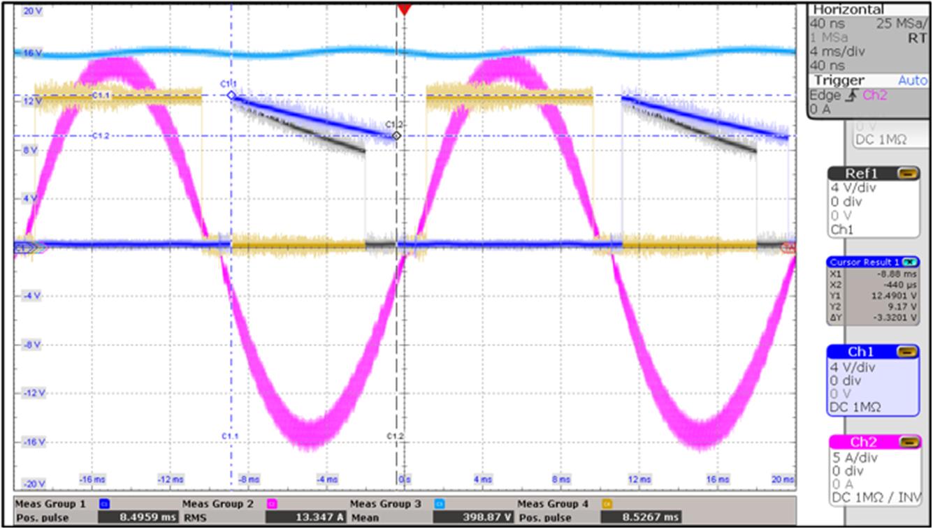

Figure 5 is similar to Figure 3, but Figure 5 shows the waveform while overlapping the CA voltage (denoted in gray).
Figure 5: Adding the Capacitor Voltage
Figure 5: Adding the Capacitor Voltage (CH1: VGSQ1, CH2: IL, CH3: VBUS, CH4: VGSQ2, REF: VCA)
Even when no voltage being applied to the gate, why is the capacitor still being discharged?

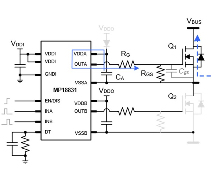

The capacitor discharges even when no voltage is applied to the gate because the half-bridge driver draws current from the capacitor to supply its inner circuits (e.g. bandgap and UVLO). In this scenario, the current drawn is the output-side quiescent current.
When focusing on the state in which Q1 is on, the energy stored in the capacitor is used to power the drive. When Q1 is on, there is some leakage through the gate-source resistance (RGS). The gate resistance (RG) is not considered because RG << RGS.
The total charge (QTOT) can be calculated with Equation (1):
QTOT = QG + QQ + QR(1)
Where QG is the transistor’s total gate charge, QQ is the charge related to the driver’s high-side quiescent current, and QR is the charge related to RGS.
The transistor’s total gate charge can be obtained from the datasheet, while QQ and QR can be estimated with Equation (2) (considering constant values):
QQ/R = I x t(2)
Equation (1) and Equation (2) can be applied for Equation (3):
QTOT = QG + [IQ + (VCA / RGS)] x tON_Q1(3)
QTOT = 275nC + (2.182mA + 10V / 10kΩ) x 6.86ms = 22.1μC
Where IQ is the driver’s output-side supply current, IRGS is the current through RGS (denoted as VCA / RGS in Equation (3)), tON_Q1 is the high-side resistor’s on time, and VCA is the capacitor’s average voltage during tON_Q1. (1) (2) (3)
Notes:
  1. IQ has been measured.
  2. tON_Q1 was obtained from the oscilloscope’s waveform.
  3. The average value has been used for VCA.
Two capacitors in parallel are used for CA (1μF and 4.7μF). Based on the datasheet value and considering the DC bias, we obtain a CA of 5.14μF.
The capacitor’s voltage drop (∆VCA) can be estimated with Equation (4):
ΔVCA = Q / CA(4)
ΔVCA = 22.1μC / 5.14μF = 4.3V
This result is close to the value observed in the previous figures (about 4V), and the main error is the capacitor’s tolerance.
For this example, the half-bridge driver causes 67.7% of the voltage drop; meanwhile, the resistance causes 31% of the voltage drop, and the totem-pole transistor contributes only 1.2%. With this in mind, the best way to improve the voltage drop is to choose a better driver.

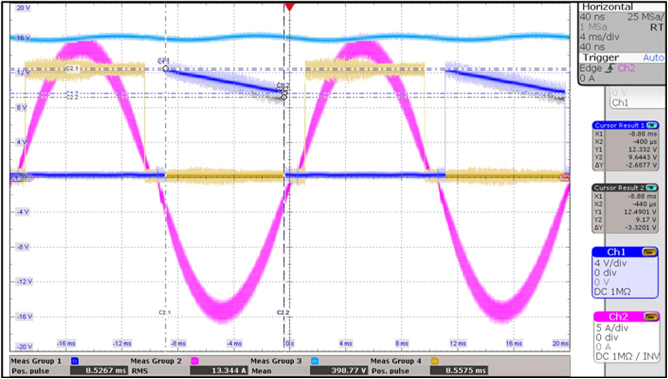

If we double RGS, the voltage drop can be reduced to 2.69V (2.52V if calculated) (see Figure 7).
Figure 7: 10kΩ vs. 20kΩ
Figure 7: 10kΩ vs. 20kΩ (CH1: VGSQ1_20KΩ, CH2: IL, CH3: VBUS, CH4: VGSQ2, REF: VGSQ1_10KΩ)
Although the converter is working properly, the design must be improved for better reliability.

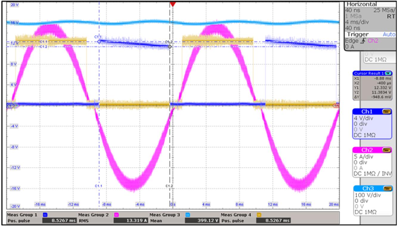

The chosen capacitor is 4.7μF with ±10% tolerance, 12.3% bias at 11.25V, and ±15% variation due to temperature (X7R dielectric). Under the worst-case scenario, this results in a capacitance of 3.15μF. Therefore, the design requires three capacitors in parallel for the capacitance to be equal to or greater than the calculated required capacitance. The voltage drop when using three 4.7μF capacitors is about 1V (see Figure 8).
Figure 8: Waveforms with Three 4.7μF Capacitors
Figure 8: Waveforms with Three 4.7μF Capacitors (CH1: VGSQ1, CH2: IL, CH3: VBUS, CH4: VGSQ2)
This voltage drop is very similar to its calculated value, which is 1.15V. Table 5 shows the relevant parameters.
