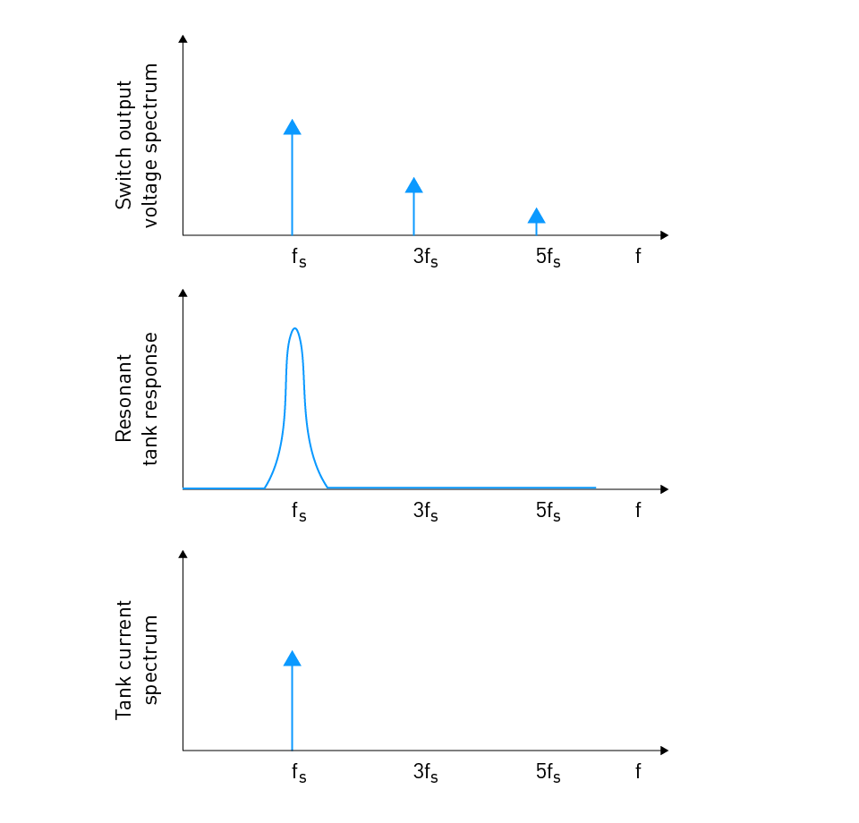

At the switching frequency fs, the output voltage and current of the resonant tank are basically sinusoids when compared to one another. The switching frequency can be altered to control the output of the resonant tank. You can achieve this by adjusting the switching frequency to either approach or deviate from the tank's resonant frequency.
Figure 2: Frequency Response

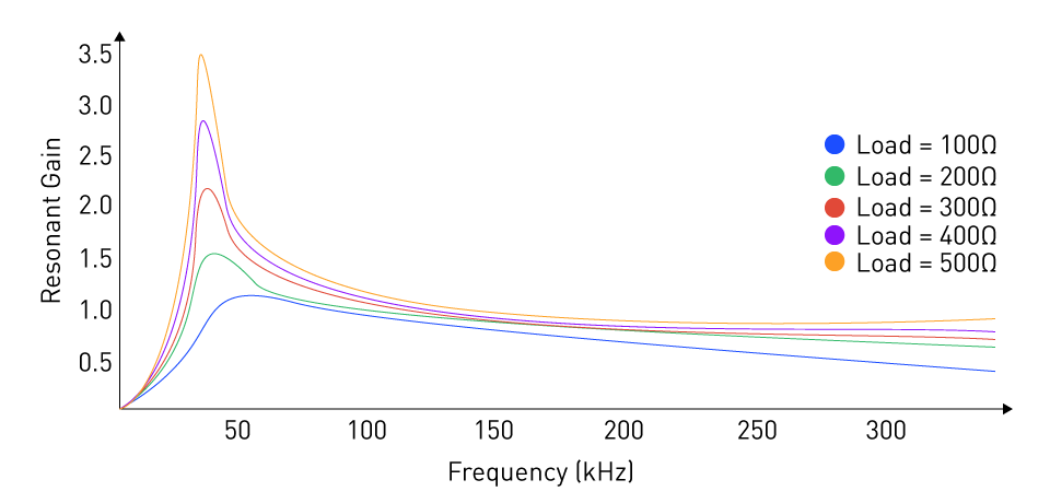

The resonant tank's gain fluctuates based on the frequency and the load applied to its secondary side. It is necessary for designers to tune these parameters in order to guarantee that the converter functions effectively across a wide variety of loads. Designers achieve this by engineering the tank's gain to exceed a value of 1 for all load values.
Figure 3: Resonant Gain Response Across a Range of Loads

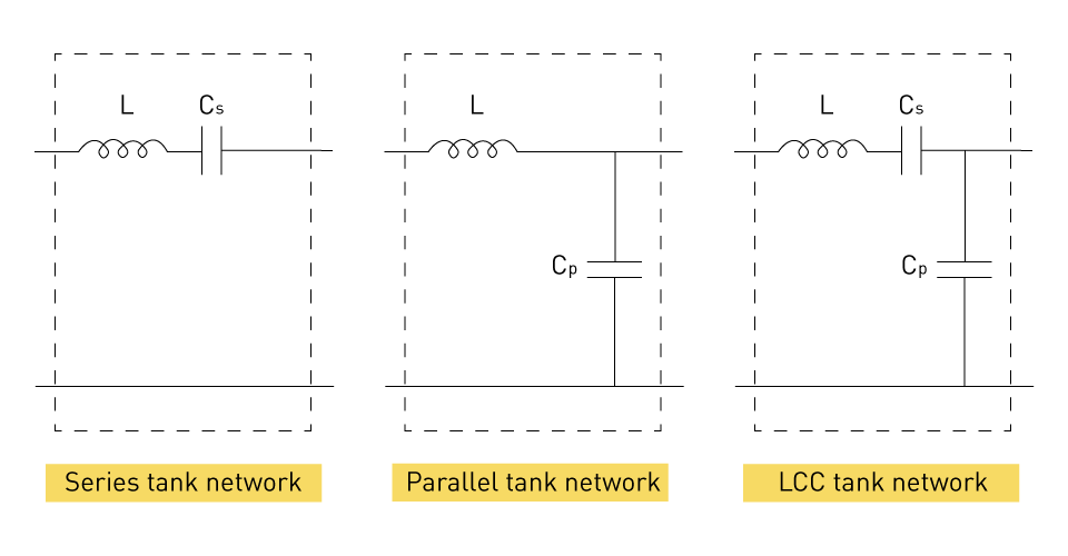

Resonant converters fall into three categories based on the configurations of their resonant parts: series, parallel, and series-parallel (LLC) resonant converters of the series variety.
Figure 4: Resonant Tank Topologies
A series resonant converter connects the load in series with the resonant inductor and the resonant capacitor. A parallel resonant converter is defined by placing the resonant capacitor in parallel with the load.
The series-parallel topology, which also incorporates components of both series and parallel resonant circuits, combines these characteristics of series and parallel resonant circuits.

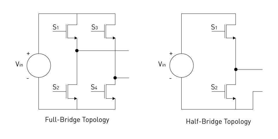

The LLC resonant converter is particularly noteworthy due to its wide range of load adaptability and efficiency. Each topology has its own distinct operational characteristics, but the LLC resonant converter stands out. It is possible to build the power switches in LLC converters using either a full-bridge or a half-bridge topology approach.
Figure 5: Power Switch Topologies

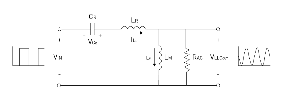

An LLC resonant converter commonly uses an LLC tank circuit with two inductors and one capacitor. This circuit is normally comprised of three components. Thanks to this arrangement, it is possible for the converter to achieve zero-voltage switching in a wide variety of operating circumstances, resulting in the converter being extremely efficient.
Figure 6: Schematic of an LLC Resonant Tank
