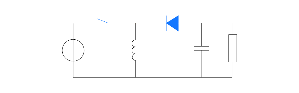

Buck Converters: Buck converters, recognized as step-down converters, lower the input voltage to achieve a reduced output voltage. In applications where the load voltage need is lower than the available input voltage, buck converters are largely utilized.
Figure 1: Buck Converter Schematic

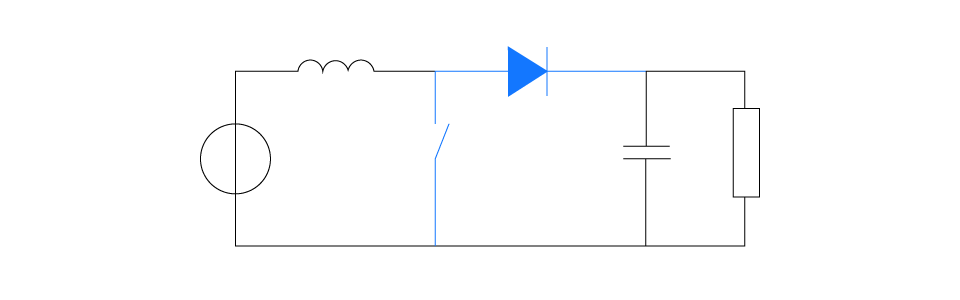

Boost Converters: Unlike buck converters, boost converters (step-up converters), raise the input voltage to a greater output voltage. In applications where the load needs a greater voltage than the one available at the input, boost converters are essential.
Figure 2: Boost Converter Schematic
