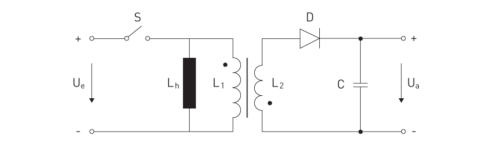

Transformers: Magnetic coupling is the process by which energy is transferred between two windings that are physically apart but magnetically coupled. Transformers are mostly used for power and signal isolation.
Figure 1: Using Transformer for Galvanic Isolation

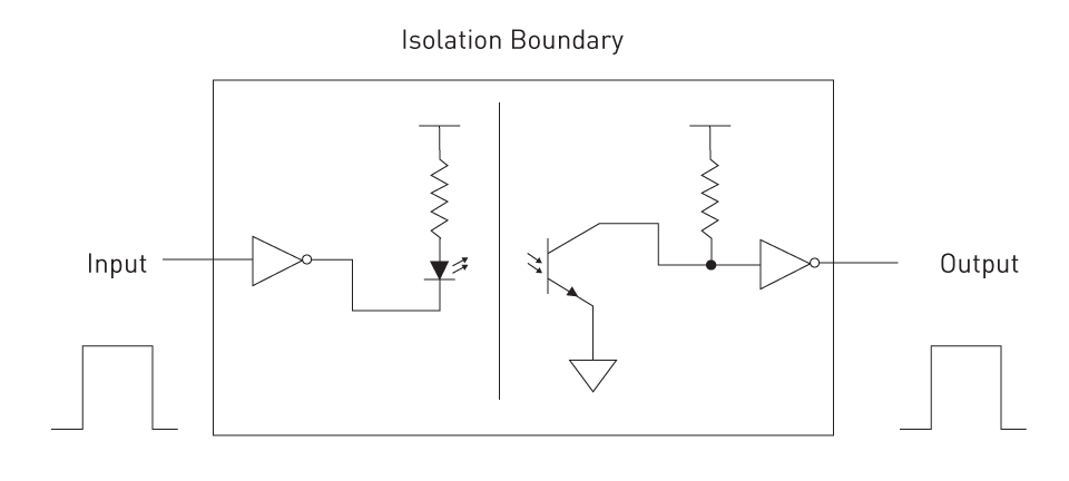

Optocouplers: These parts transfer signals over an isolation barrier using light. When an electrical signal is provided, an LED on one side generates light, which is then recognized by a photodetector on the other side, therefore conveying the signal without the need for direct electrical contact.
Figure 2: Optocoupler Galvanic Isolation

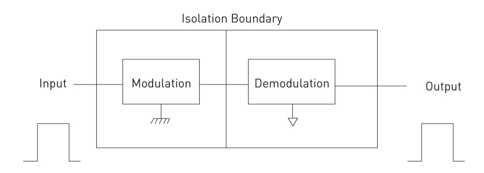

Capacitive Isolators: These gadgets transmit signals via electric fields. Again, without direct electrical connectivity, they are constructed with capacitive parts that enable signal transfer through variations in electric fields.
Figure 3: Capacitive Galvanic Isolation

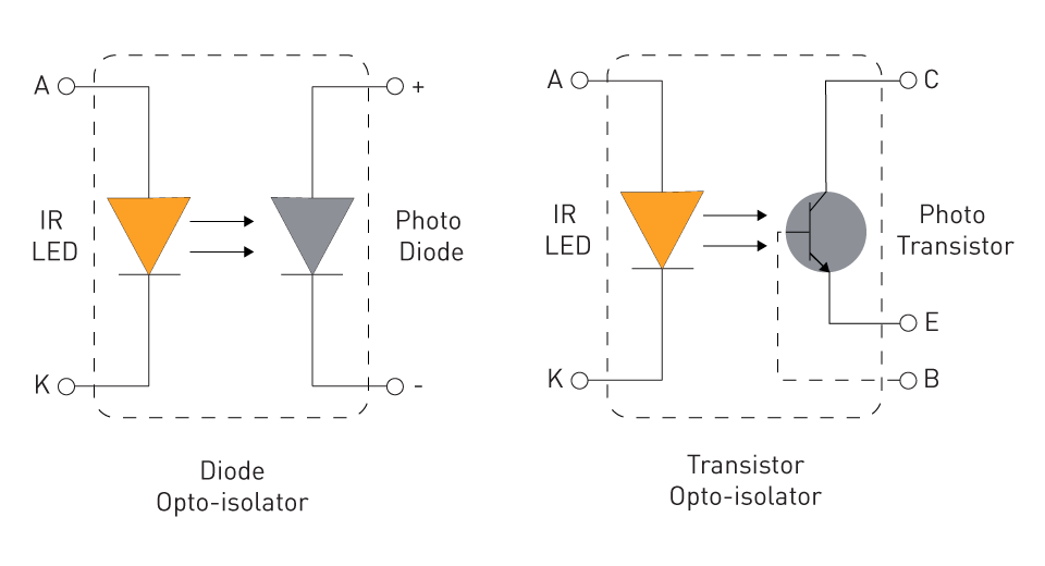

Components of an Optoisolator: A light emitter and a light receiver are the two main parts of an optoisolator. Light-emitting diodes (LEDs) are commonly used as the emitter, and photodiodes, phototransistors, or photodarlingtons are commonly used as the receiver. To avoid influence from outside light, these components are kept inside a sealed container. An infrared light-emitting diode (IR LED) serves as the transmitter in a somewhat modified configuration, while a phototransistor serves as the receiver.
Figure 4: Types of Optoisolators
Operation Mechanism: The LED emits light in response to the strength of an applied electrical signal. The photoreceiver on the other side of the isolation barrier detects this light as it passes through. After that, the light is transformed back into an electrical signal by the receiver, which is electrically insulated from the input signal but resembles it.

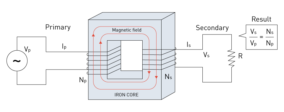

Transformers in Isolation
Principle of Operation: Transformers use electromagnetic induction to achieve isolation. Two windings, the primary and secondary, are usually coiled around a magnetic core to produce a transformer. The main winding produces a magnetic field that causes a voltage in the secondary winding when an alternating current (AC) passes through it. Without a direct electrical connection, power or signals can be transferred between circuits using this induced voltage.
Figure 5: Transformer
Galvanic Isolation: The capacity of transformers to produce galvanic isolation is one of their main benefits. Transformers effectively stop direct current (DC) and any related faults or surges from flowing from one side to the other since the primary and secondary windings are not electrically coupled. This ensures safety and shields delicate components.
Applications: Transformers separate the high-voltage side from the low-voltage side in power supplies, especially switching power supplies and AC adapters. They are also utilized for power transfer and signal separation in industrial control circuits, medical equipment, and audio systems.

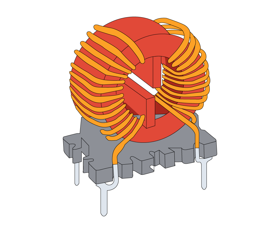

Common-Mode Chokes: Unwanted common mode noise, or signals that occur simultaneously and in phase on two lines of a circuit, is filtered out by a particular kind of inductor called a common mode choke. In order to lessen electromagnetic interference (EMI) in data and power lines, they are crucial.
Figure 7: Common-Mode Choke

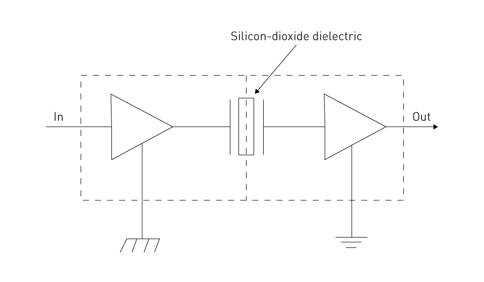

Principle of Operation: The basic idea behind capacitive coupling is that a capacitor is created when two conducting plates, also known as electrodes, are spaced apart by a dielectric substance. An electric field is created across the dielectric when a voltage is applied to one plate, which causes a voltage to be induced on the other plate. Without making direct electrical contact, signal information is sent across the isolation barrier using this phenomenon.
Figure 8: Capacitive Isolator
Signal Transfer: Capacitive isolators are constructed with incorporated capacitive elements into a semiconductor substrate to achieve signal isolation. High-speed digital signals can pass across the isolation barrier thanks to these capacitors' quick charging and discharging in response to input signal changes.
Galvanic Isolation: Capacitive coupling offers galvanic isolation between input and output, just like other isolation methods. By ensuring that there isn't a direct current channel between the two sides of the isolator, this protects against ground potential differences, high voltage transients, and the transmission of DC voltages.
