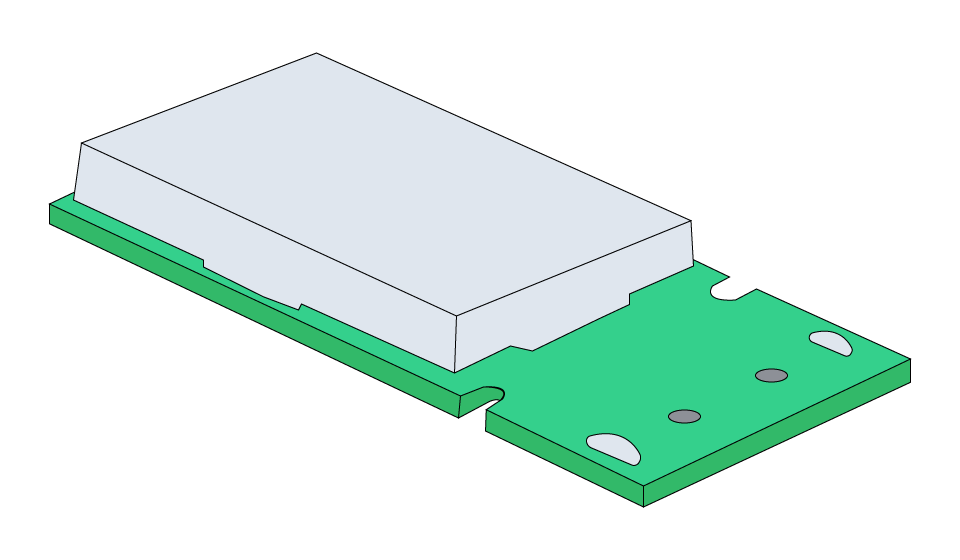

Shielding and Grounding: In the mitigation of EMI, it is crucial to employ effective shielding for sensitive components and adhere to proper grounding practices. Enclosing electronic circuits in conductive or magnetic materials constitutes shielding, whereas dissipating unwanted electromagnetic energy is facilitated by grounding.
Figure 1: EMI Shielding

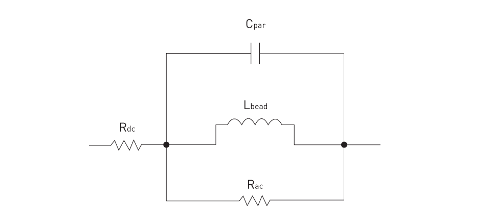

Filtering: The suppression of EMI can be achieved by implementing filters at critical points in the circuit. This involves integrating ferrite beads to filter out high-frequency noise and employing low-pass filters to block high-frequency noise.
Figure 2: Simplified Circuit Model for a Ferrite Bead
