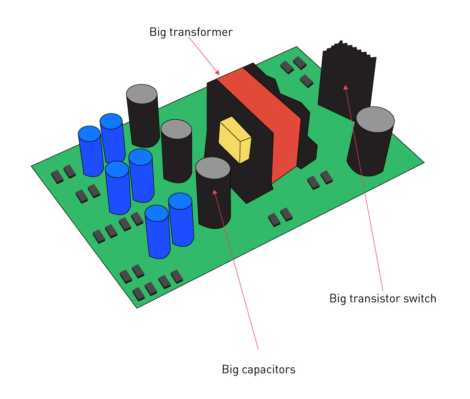

Size and Weight: The size and weight of components used in centralized power supplies result in supply units that are bulky and heavy. This may impact the ease of moving the object and pose difficulties for designs that have limited space.
Figure 2: Large Components for Power Supplies with Centralized Architecture

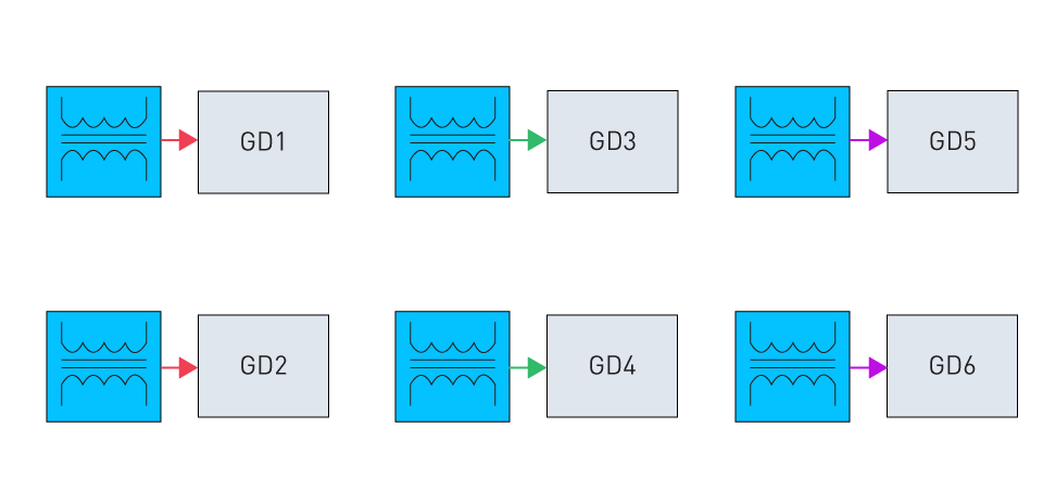

Distributed
Power supply architectures that are distributed and isolated offer a flexible and effective solution for delivering power to intricate electronic systems. This architecture differs from centralized models in that it distributes multiple, smaller, isolated power supplies throughout the system in close proximity to the points of load. This close proximity reduces power loss during transmission and enables more precise power management, catering to the specific requirements of various subsystems.
Figure 3: Distributed Architecture

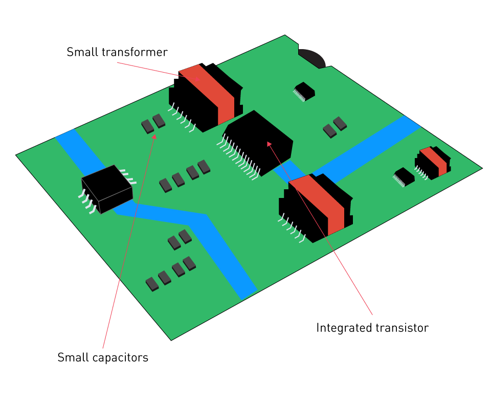

Compact Size and Low Weight: Applications that require distributed, isolated power supply architectures highly value compact size and low weight. These architectures effectively minimize the necessity for lengthy power distribution lines by integrating isolated power supplies near gate drivers, resulting in a decrease in both system size and weight. This approach is especially beneficial in applications with limited space, such as aerospace or portable electronic devices, where size and weight are critical factors.
Figure 4: Compact Size and Low Weight for Power Supplies with Distributed Architecture

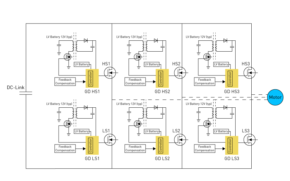

Gate Drivers with Integrated Power Supplies
Gate Drivers with Integrated Power Supplies are a game-changer in power electronics design, especially for applications that demand small size, high efficiency, and utmost reliability in power conversion and management. This design incorporates the power supply directly into the gate driver circuit, allowing for a more seamless connection between power delivery and gate driving. This integration provides numerous advantages, such as a decrease in the number of components, increased system reliability, and enhanced power efficiency.
Figure 5: Gate Drivers with integrated Flyback Controller
