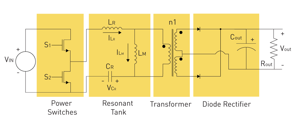

LLC Converters
Among the many types of isolated power supply, LLC resonant converters are a particularly sophisticated category. They are distinguished by their exceptional efficiency and power density. In the realm of gate driver applications, this architecture has become increasingly popular, particularly in situations where precise control, efficiency, and a broad input voltage range are of fundamental importance. Power switches, a resonant tank, a transformer, and a diode rectifier are the four components that comprise an LLC converter.
Figure 2: LLC Converter
Fundamental Concepts and Operation
The most crucial part of an LLC converter is the resonant tank circuit, which consists of two inductors and one capacitor. This configuration generates a resonant frequency, enabling the converter to switch at or near this frequency. This significantly reduces the amount of energy lost during the power switch's transition stages. Through its operation in resonance, the LLC converter is able to achieve a high level of power conversion efficiency, which is especially helpful for the harsh conditions of gate driver circuits.
Advantages for Gate Driver Applications
High Efficiency Across Wide Load Range: LLC converters maintain high efficiency over a broad load range, making them suitable for gate driver applications with variable power demands.
Excellent EMI Performance: LLC converters are suitable for gate driver applications with fluctuating power demands because they maintain a high level of efficiency across a wide load range. This makes them suitable for use in gate driver applications.
Flexibility in Input Voltage: Because of their resonant nature, LLC converters are able to accommodate a wide variety of input voltages, which allows them to accommodate fluctuations in supply voltage without compromising their performance or efficiency.
Compact Size: The high efficiency and power density of LLC converters enable smaller component sizes, thereby contributing to the shrinkage of gate driver systems.
Design Considerations and Challenges
Complex Control Schemes: LLC converters operation at resonant frequencies necessitates the use of sophisticated control algorithms to modify the switching frequency in response to varying load conditions and input voltages. This calls for the development of advanced controller designs.
Component Selection: The quality and characteristics of the LLC converter's components, particularly the resonant tank and switching devices, significantly determine its performance. One of the most important components is the switching device. It is of the utmost importance to choose components that are capable of withstanding operational strains while preserving their efficiency.
Thermal Management: In spite of their efficiency, LLC converters are capable of producing a considerable amount of heat when operating at high power levels or when designed in small configurations. To maintain the gate driver's reliability and extend its lifespan, thermal management systems must be implemented that are both effective and efficient.
Tuning for Optimal Performance: To achieve optimal performance, the process of tuning an LLC converter necessitates careful tuning of the resonant tank characteristics to match the gate driver application's specific requirements. This is necessary in order to get the best possible performance from the LLC converter. While this process of tuning might be difficult and time-consuming, it is absolutely necessary in order to achieve optimal levels of efficiency and performance.
