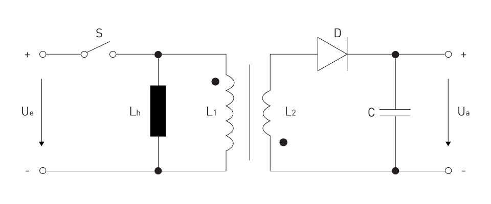

Transformers: Transformers use magnetic coupling to transfer signals. The primary coil generates an alternating current that, in turn, induces a current in the secondary coil, separated by an isolation barrier. With their impressive power and signal transfer capabilities, magnetic isolators are a perfect fit for isolated power supplies.
Figure 2: Using Transformer for Galvanic Isolation

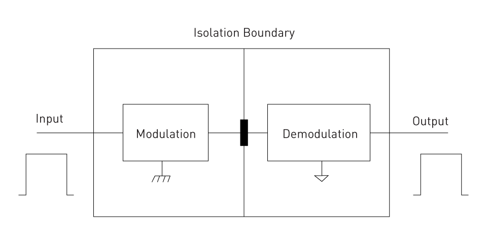

Capacitive Isolation: utilizes capacitors for signal transfer. Voltage changes on one plate of the capacitor generate a corresponding voltage on the other, facilitating the transfer of the signal. Capacitive methods provide fast data transmission and have a longer lifespan compared to optocouplers.
Figure 3: Capacitive Galvanic Isolation
