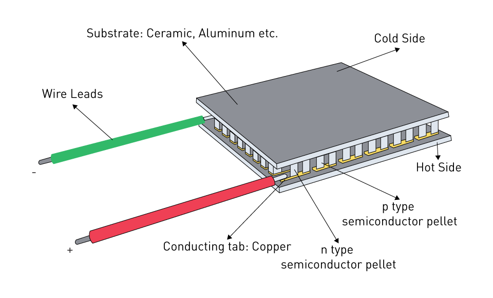

Thermoelectric Coolers (TECs): Thermoelectric coolers (TECs) are designed to provide targeted cooling by utilizing Peltier devices. These devices create a temperature gradient electronically, allowing for efficient cooling.
Figure 2: Thermoelectric Cooler

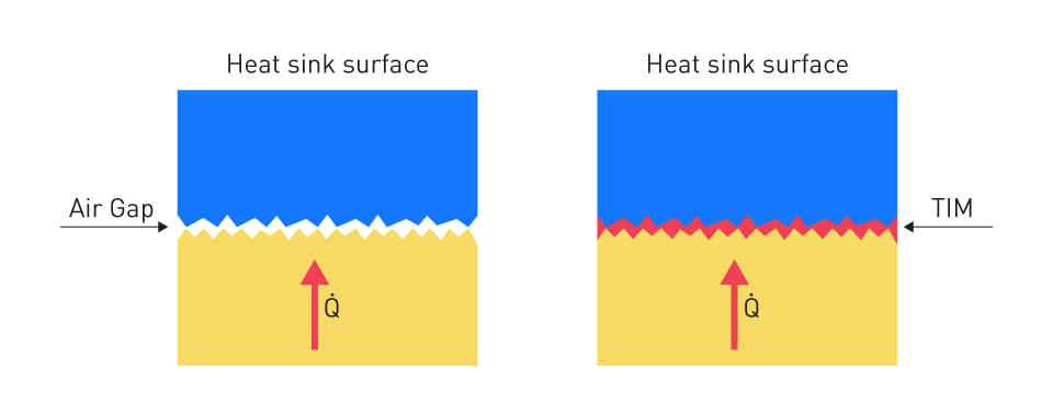

Thermal Interface Materials (TIMs): Thermal Interface Materials (TIMs) are essential for enhancing the thermal contact between heat sources, such as ICs, and heat sinks. TIMs, including thermal pastes, pads, and adhesives, play a crucial role in optimizing heat transfer. They help to minimize air gaps and microscopic irregularities, which in turn lowers thermal resistance.
Figure 3: Direct Contact vs. using TIMs

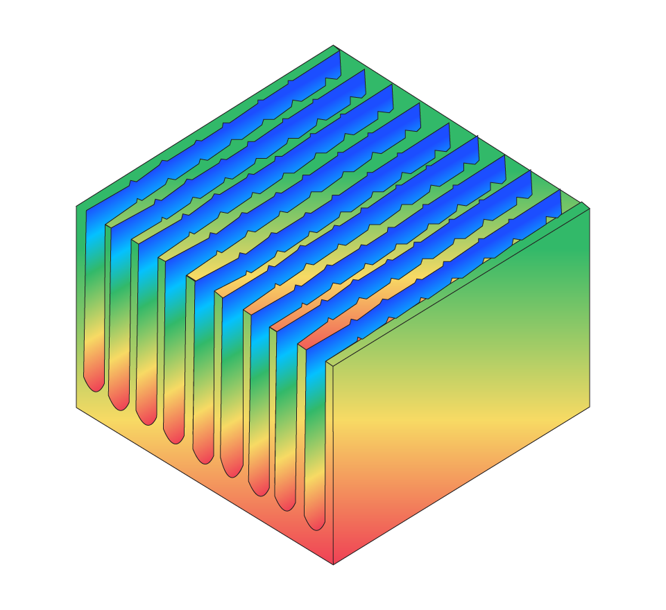

Computational Fluid Dynamics (CFD): Thermal analysis widely employs computational fluid dynamics (CFD) simulation tools. These tools simulate the flow of heat and air (or other coolants) around electronic components, offering a comprehensive view of temperature distribution and heat transfer in the system.
Figure 4: CFD Analysis of Heat Transfer Enhancement in a Heat Sink Design
