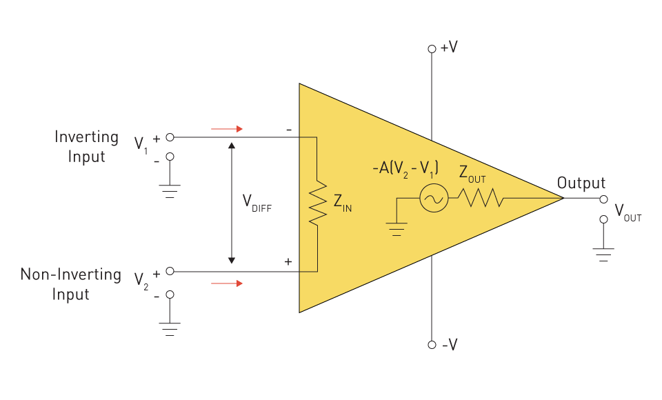

Operational Amplifiers (Op-Amps): These are adaptable components that have a wide range of applications, from simple voltage followers to intricate integrative and differential circuits. Op-Amps, which have a low output impedance and a high input impedance, are essential components of contemporary electronics and play a key role in signal conditioning.
Figure 1: Operational Amplifier

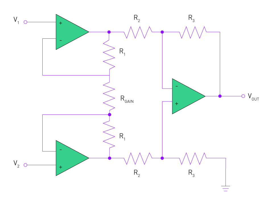

Instrumentation Amplifiers: Instrumentation amplifiers offer high input impedance differential amplification specifically suited for sensor signal conditioning applications. Since they are designed to amplify small differential signals in the presence of huge common-mode voltages, they are especially useful in situations where sensor signals may be sent over noisy environments.
Figure 2: Instrumentation Amplifier

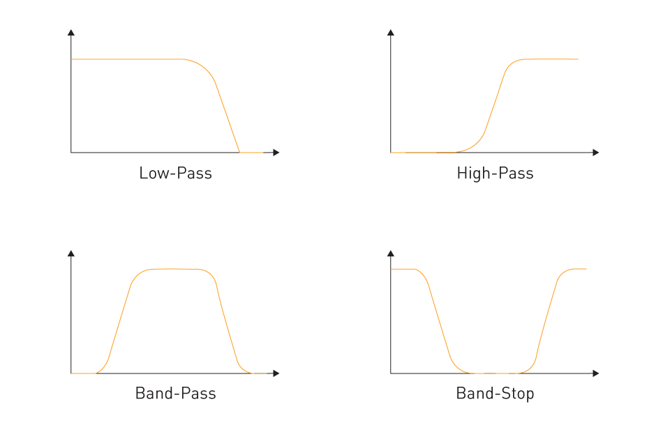

Types of Filters
Low-Pass Filter: Attenuates frequencies higher than the cutoff frequency and permits signals with a frequency lower than the cutoff frequency to pass through. The removal of high-frequency noise is a common usage for it.
High-Pass Filter: This type of filter attenuates signals below a specific threshold while permitting high-frequency signals to pass, in contrast to the low-pass filter. It can be applied to a signal to eliminate undesirable slow-varying components.
Figure 3: Types of Filters
Band-Pass Filter: This kind attenuates signals outside of a specific frequency range while allowing signals inside the band to flow. beneficial for separating out a specific interest frequency band.
Notch Filter (or Band-Stop Filter): It is extremely efficient at eliminating interference or noise at a specified frequency, such as power line noise at 50/60 Hz, because it is made to attenuate a particular narrow band of frequencies.

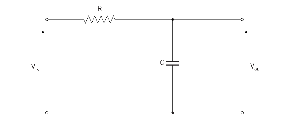

Analog Filtering: Implemented with the use of active components like operational amplifiers or passive like resistors, capacitors, and inductors. Due to their rapid reaction, analog filters are advantageous in real-time applications processing continuous-time signals. However, aging and component tolerances may have an impact on their performance.
Figure 4: Analog Low-Pass Filter

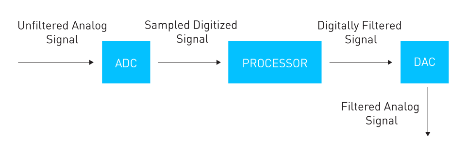

Digital Filtering: Functions with discrete-time signals, frequently following an analog-to-digital conversion step. Algorithms are used to create digital filters, which are then implemented in microcontrollers or digital signal processors. Because software parameters can be altered to vary their qualities, they offer flexibility. They are able to produce precise filter shapes and extremely sharp cutoffs, which could be difficult in the analog domain. However, because of the complexity of the filter, there may be a computational delay and the need to digitize the signal.
Figure 5: Digital Filtering

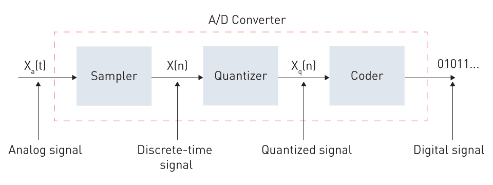

Principles of Quantization and Sampling
Sampling: At discrete time intervals, the continuous-time analog signal is first sampled. The Nyquist-Shannon sampling theorem states that in order to avoid aliasing, the sampling rate, often represented by the symbol fs, must be at least twice the highest frequency in the signal.
Quantization: Every sample has a finite digital value after it has been sampled. The method generates an inaccuracy known as quantization error by nature because there are only a finite number of digital levels (determined by the resolution of the ADC). This is the discrepancy between an analog value's closest digital equivalent and its real value.
Encoding: Encoding is the next phase in the analog-to-digital conversion process, which comes after the analog signal has been sampled and quantized. This is how a binary code representing each quantized value is created. Combinations of 0s and 1s are utilized in binary encoding, and the resolution of the encoding is determined by the number of bits employed in this representation. For example, you may represent 256 (28) different quantization levels using 8 bits. Every quantized sample has its own binary code assigned to it.
Figure 6: Basic Components of an Analog-to-Digital Converter
