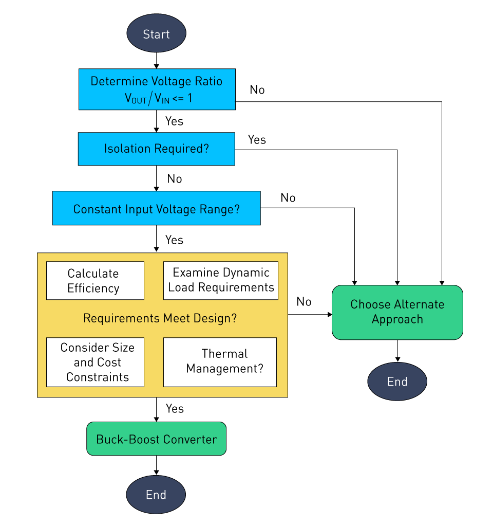

The decision to employ a buck converter hinges on a meticulous analysis of the application's voltage requirements and operational parameters. Factors such as load characteristics, efficiency targets, and size constraints must be weighed against the strengths and limitations of alternative topologies. This selection process underscores the engineering acumen required to optimize performance and align the chosen topology with the specific demands of the application.
Figure 2: Selecting a Buck Converter Topology
Engineers carefully evaluate these factors to make informed decisions:
Voltage Requirements: If the application necessitates a lower output voltage than the input voltage, a buck converter is a natural choice.
Non-Isolated: If the application does not require the output voltages to be isolated then the buck converter is the prime step-down option.
Constant Input Voltage Range: The buck converter is characterized by a constant input voltage range, encompassing both minimum and maximum voltage limits. This specified range remains generally uniform across the operational scope of buck converters.
Efficiency Considerations: Buck converters are renowned for their high efficiency in step-down applications. When energy efficiency is a priority, especially in battery-operated devices or energy-conscious systems, the buck topology often stands out.
Size and Weight Constraints: In applications where size and weight are critical factors, such as portable electronic devices or automotive systems, the compact design of buck converters is advantageous.
Dynamic Load Requirements: Buck converters exhibit fast transient response, making them suitable for applications with dynamic load requirements, where quick adjustments to output voltage are essential.
Cost Considerations: Buck converters are often cost-effective and have a simpler design compared to some other topologies. When cost is a primary concern, especially in mass-produced consumer electronics, the buck converter may be the preferred choice.
Heat Dissipation and Thermal Management: The buck topology can excel in applications where heat dissipation is a concern. Efficient control of the ON and OFF states minimizes thermal stress on components.
By carefully considering these criteria, engineers can determine whether the buck converter aligns with the unique demands of the application, ensuring optimal performance and reliability in diverse electronic systems.
