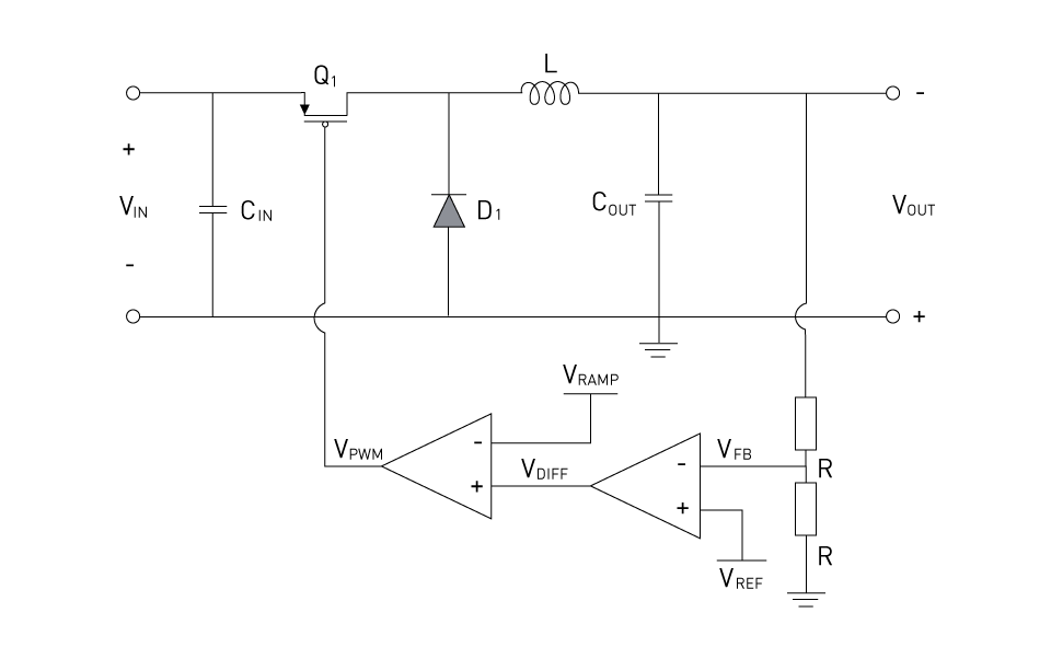

$$f_{sw} ≥ 10kHz$$Feeback Topology for Buck Converter
Figure 9: Feedback for Buck Converter
A feedback topology for buck converter is shown in the figure above. The voltage divider feedback is the most common and widely used accepted feedback technique. The output of this divider VFB is compared with the Vref reference voltage of the buck converter (set voltage). The error voltage Vdiff is compared with the Vramp (ramp voltage of a fixed frequency) to produce a PWM of the duty cycle proportional to the output voltage. The values of these feedback resistors are very much critical as feedback operation relies on them.
Vout can be set by knowing the reference voltage and the values of these feedback resistors.
$$V_{out}= V_{ref} \frac {R_{FBT}+R_{FBB}} {R_{FBB}}$$Initially the Vout is known (designed output voltage), we may find the values of feedback resistances from this equation.
$$R_{FBT}=R_{FBB} ( \frac {V_{out}}{V_{ref}} -1)$$RFBB may be chosen between 20-200 kΩ and RFBT can be calculated. It should be noted that higher values of these resistances can affect stability of the op-amp, while lower values will draw unnecessary amounts of current resulting in lower efficiency.
