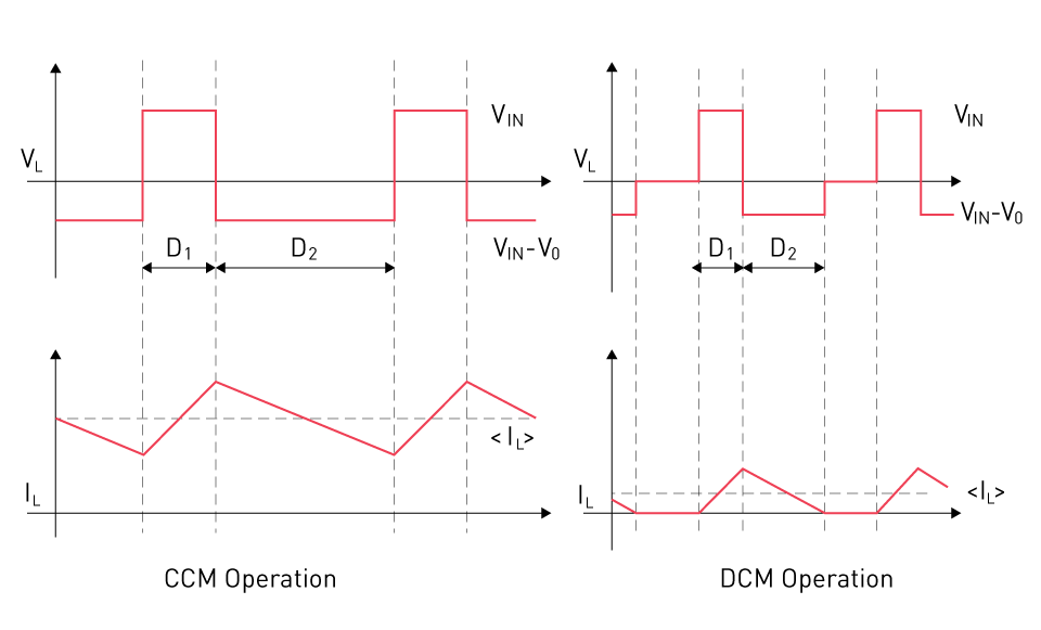

Continuous vs. Discontinuous Conduction Modes
The operating mode of the buck converter is characterized by the behavior of the inductor current during the switching cycle. In continuous conduction mode (CCM), the inductor current never reaches zero during one complete cycle. This mode is typically preferred for applications with varying loads, as it provides smoother and more predictable operation. On the other hand, discontinuous conduction mode (DCM) occurs when the inductor current drops to zero during a portion of the switching cycle. DCM is often employed in low-power applications or when the load varies within a narrow range. The choice between CCM and DCM involves a trade-off between component stresses, efficiency, and complexity of control circuitry.
Figure 8: CCM vs. DCM
As it is evident from the figure that in CCM load current never reaches zero which means the circuit is supplying the current for the whole time. However, in DCM the load current may reaches to zero by in a part of the cycle. Still DCM offers higher efficiency sometimes due to the lack of reverse recovery loss on the diode. But not when the duty cycle is too small because it will force a very high current to charge the inductor reducing overall efficiency of the converter.
