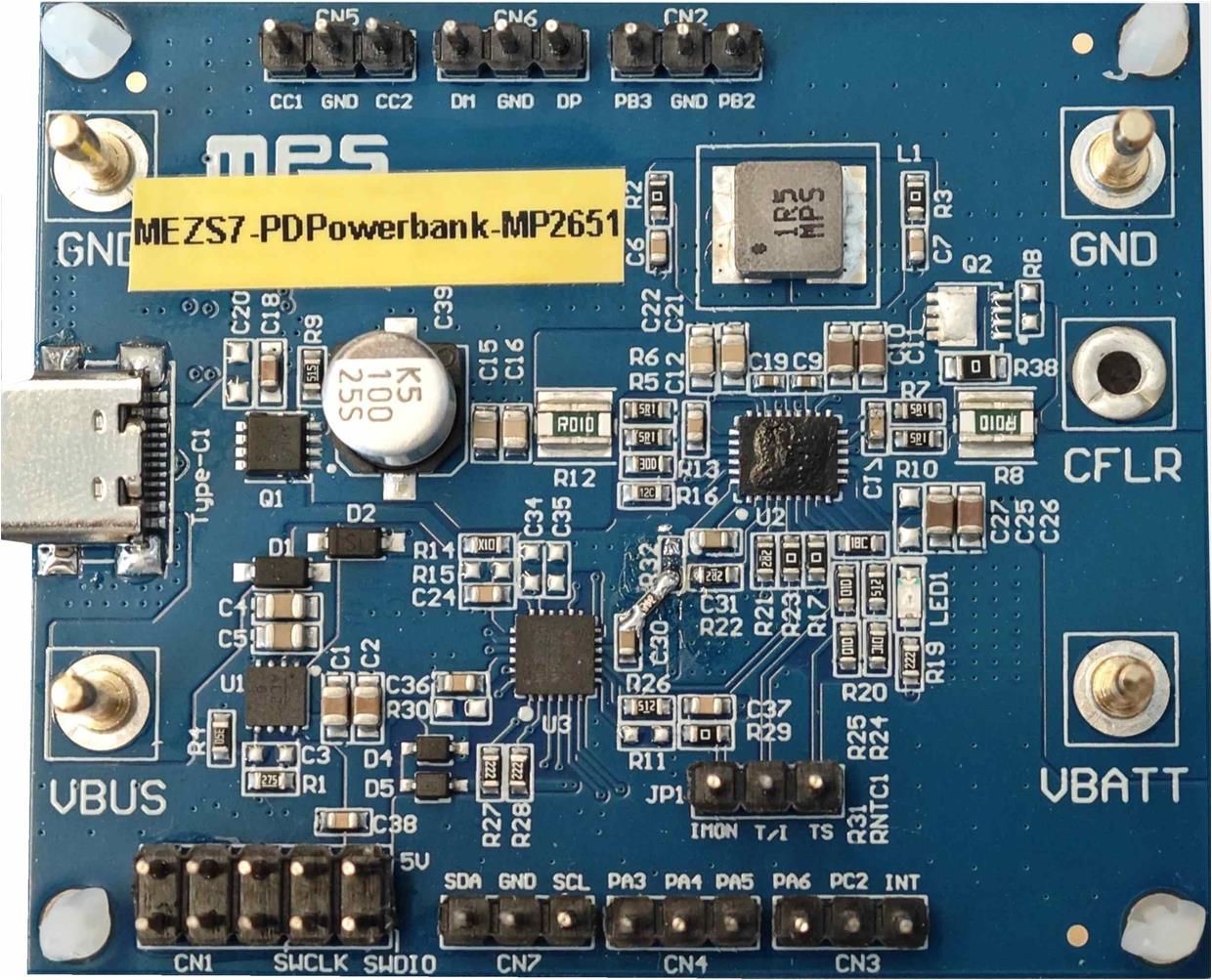

Evaluation Board
LxWxH (6cmx5cmx2.1cm)
| Board Number | MPS IC Number |
| MEZS7-PDPowerBank-MP2651 | MPF52002GRE-0001 |
| MP2651GVT-000A |
Table 1: Battery Cell Number Setting (4)
| Cell Number | PB2 | PB3 |
| 2-Cell (Default) | 1: Float or high | 1: Float or high |
| 3-Cell | 0: Short to GND | 1: Float or high |
| 4-Cell | 1: Float or high | 0: Short to GND |
4) Set PB2 and PB3 to configure the number of cells before charging a real battery.

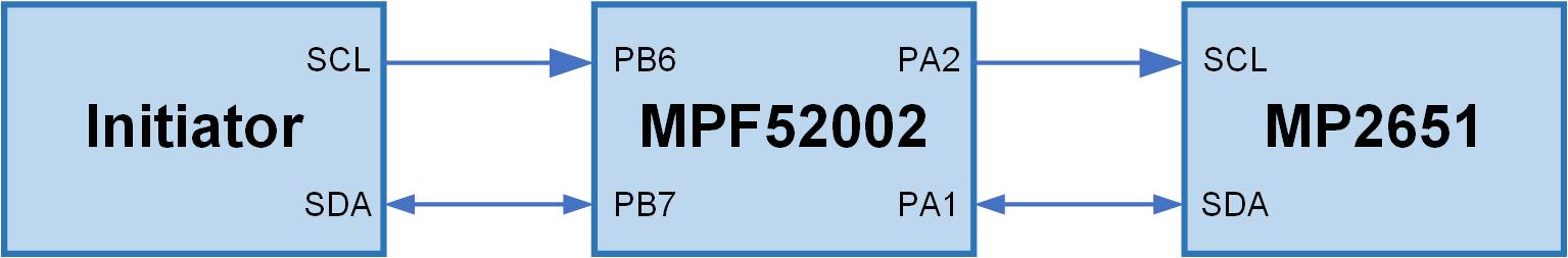

I2C Target Function Description

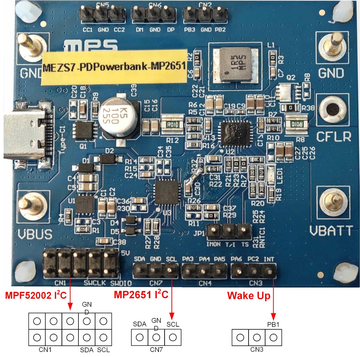

The MP2651 and the MPF52002 can be controlled or monitored via the I2C between the MPF52002 and the I2C initiator. The initiator should connect to the MPF52002 via PB6 and PB7 instead of the MP2651 (see Figure 3). The MPF52002 periodically reads the charge parameters, alerts the status of the MP2651, and updates the information to the I2C target registers. The initiator can also send some I2C commands to the MP2651 through the MPF52002.
Figure 3: MPF52002 I2C Target Diagram Block
I2C Connection Hardware Set-Up
In only battery mode, the MPF52002 can enter deep sleep to save power, and the I2C target registers are disabled. There are two methods to turn the I2C target function back on:
Next, connect the PC and the MEZS7-PDPowerbank-MP2651 with the EVKT-USBI2C-02 communication interface (5) (see Figure 4). The I2C SCL line should be connected via PB6, which has the SWDIO silkscreen print, and the I2C SDA line should be connected on PB7, which has the SWCLK silkscreen print.
Figure 4: Hardware Connected for the I2C Communication
5) Contact an MPS FAE or request through the MPS website to obtain the EVKT-USBI2C-02 communication interface.

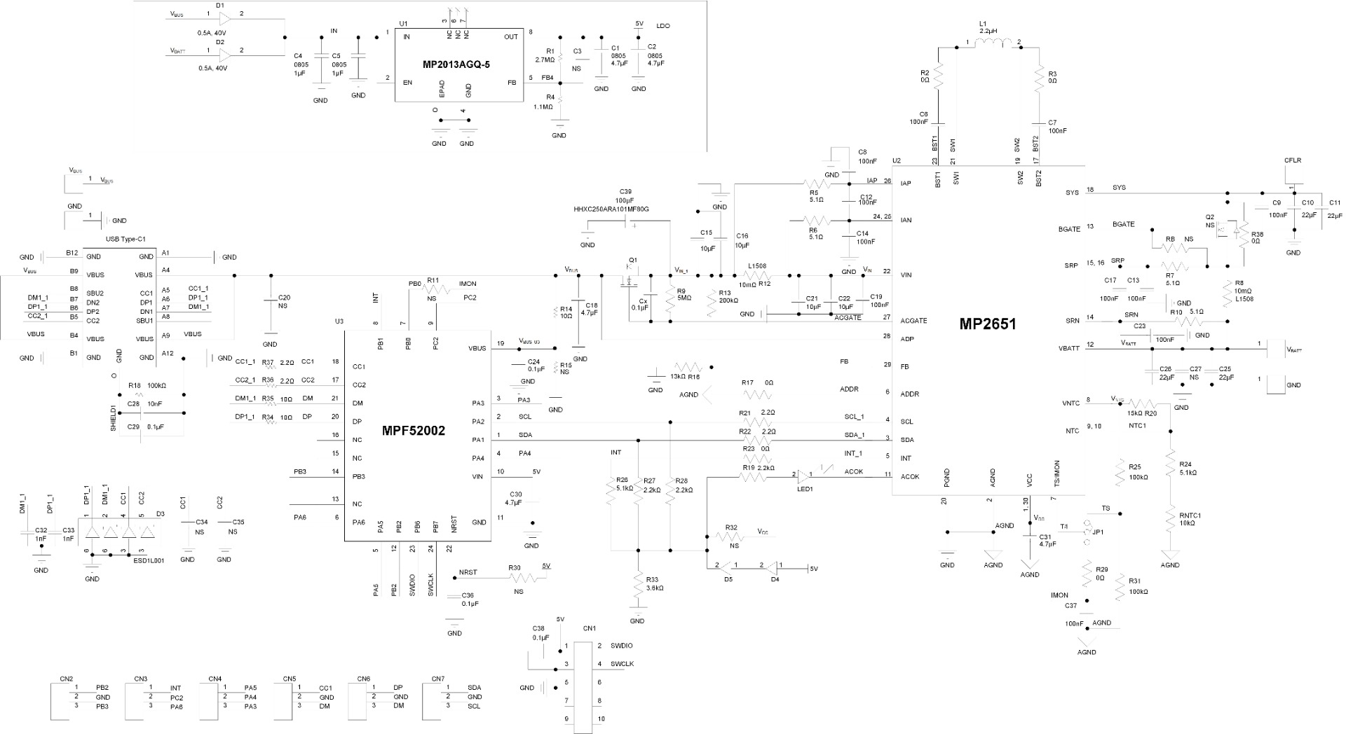

Evaluation Board Schematic (6) (7)
Figure 5: Evaluation Board Schematic
6) A 0.1μF capacitor (Cx) can be paralleled on R9 to avoid inrush current when ACGATE turns on the MOSFET Q1.
7) PB6/7 can be used as the SWD interface. Before downloading any new firmware with the SWD interface, pull PA3 (boot 0) down to restart the MPF52002. When the firmware update is finished, disconnect PB6/7 from the SWD interface and release PA3, then turn the device on to load the new firmware

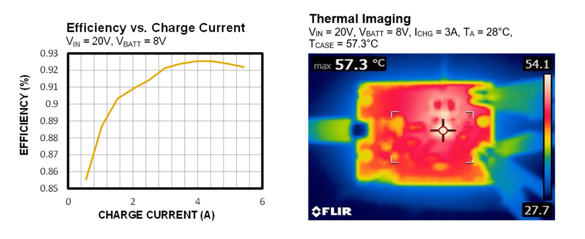

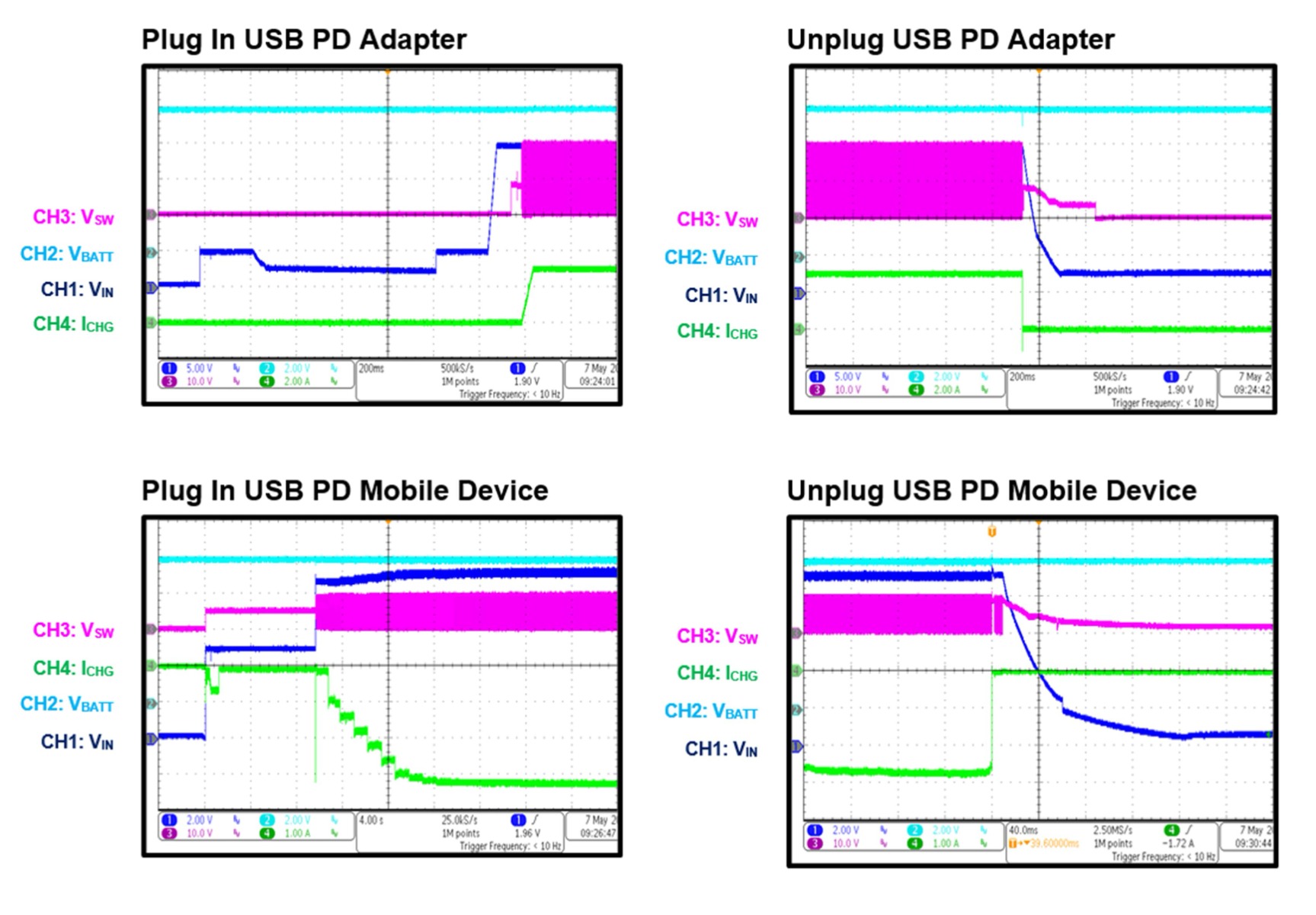

EVB Test Results
Performance curves and waveforms are tested on the evaluation board. The input power source is a USB PD adapter, VIN = 20V, VBATT = 8V, TA = 25°C, default register data, unless otherwise noted.
