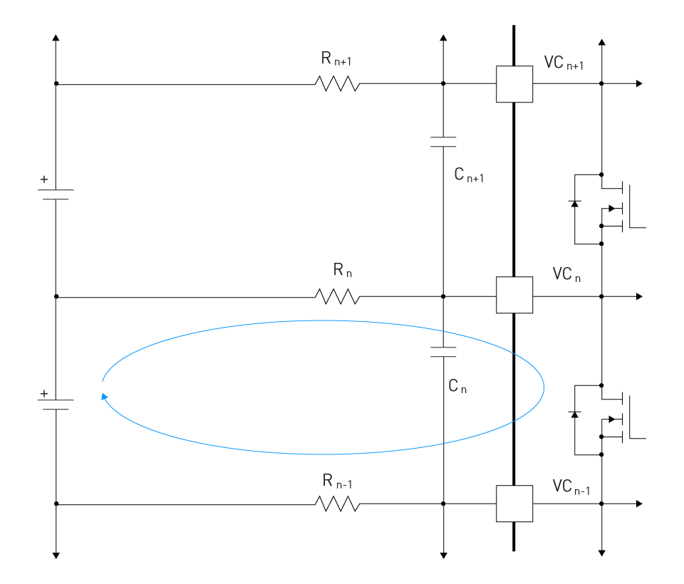

Passive and Active Cell Balancing Techniques
There are two methods for balancing the cells in a battery pack: passive balancing and active balancing. Both strategies attempt to equalize the charge of the cells, although they do it in different ways.
Passive Cell Balancing
- Function: Removes excess charge from cells with greater voltage, often via a resistor or a transistor-resistor network. The diagram below demonstrates a passive balancing circuit. With the assistance of the transistor switch, each battery cell may be drained independently via resistors Rn and Rn-1. The rate of discharge is determined by the resistor values used.
Figure 2: Example of Passive Cell Balancing
- Pros: Less complicated, less expensive, and doesn't need intricate control systems.
- Cons: Energy is lost as heat, which might lead to issues with thermal management. It is less effective, especially with big imbalances.
